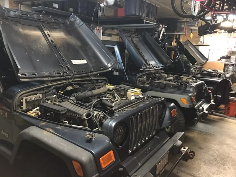

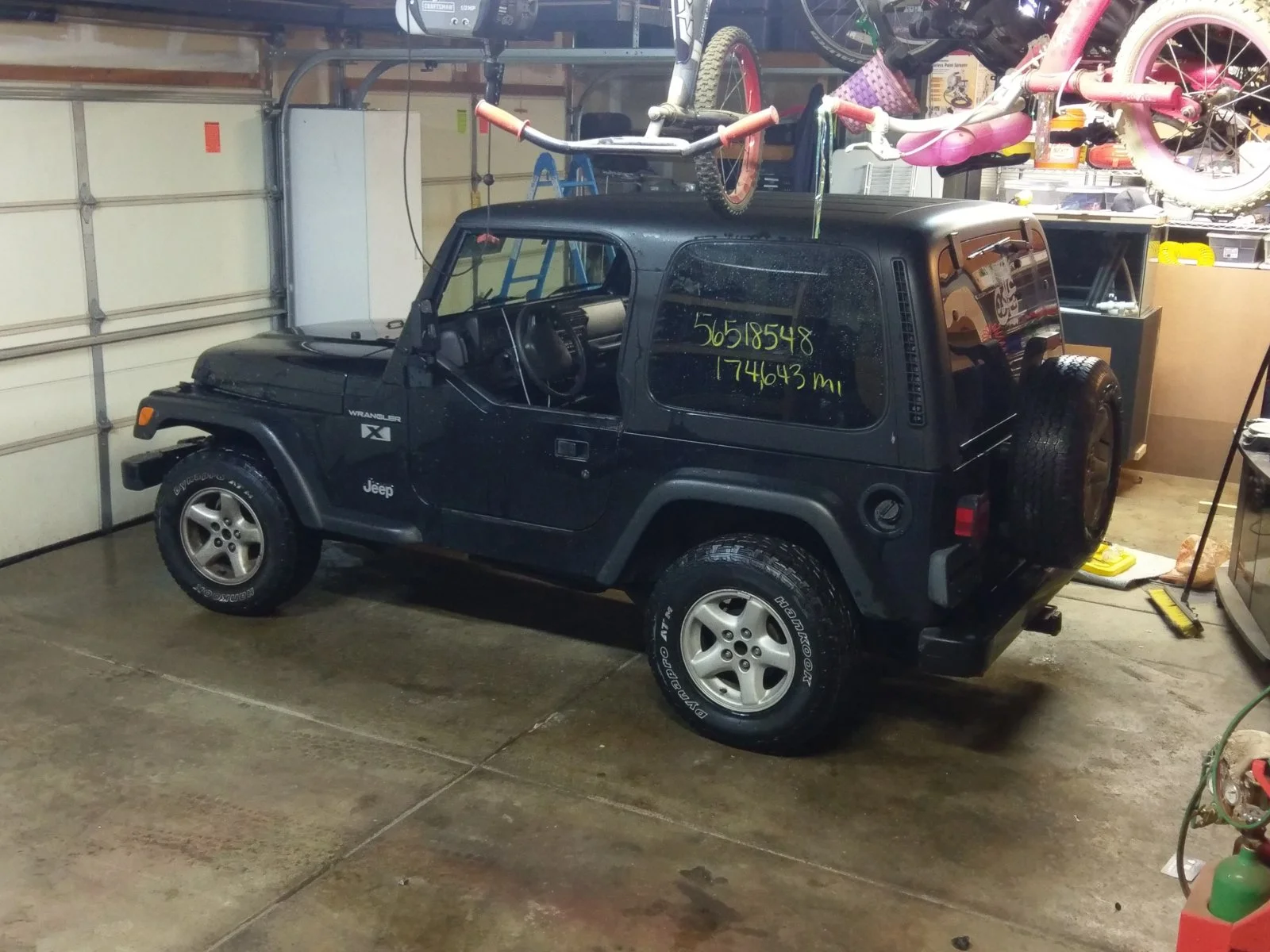

Time to resurrect this build.
#2 ended up being a dirty trans filter and low fluid. $50 and the rig was driving. The torque converter "clicks" (& everything still leaks like crazy) but I'm sure that was from the abuse of the PO. I'll get the converter replaced at some point. #2 looks like a great candidate for tub off winter restore project but is lacking some options I want soooo...#3 (center one) was bought as a parts car.

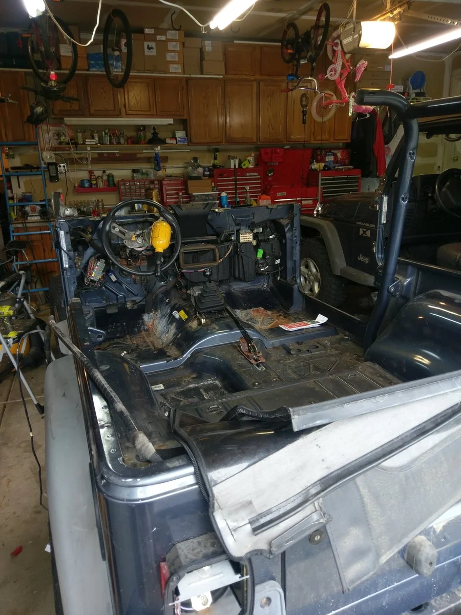

#3 is was "totaled" by the insurance company. It's another 2002 (manual Sport) and came with brand new 31" BFG A/Ts and a Dana 44 (3.73) in the rear. (tires and Dana 44 cover about the cost of the entire Jeep) The Jeep was hit on the passenger side and the front of the frame was bent about two inches.

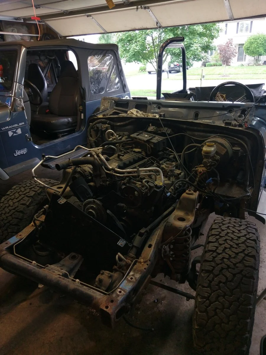

#3 is now stripped and ready for the tub to come off and engine to be pulled. Once that is done I'll figure out what frame I'm going to use for the build and then start cleaning up and rebuilding the axles.
The goal is a solid, simple TJ with a 2.5" lift (Rancho 5000/OME) and 31" tires. My long term goal is to get two solid TJs out of the 3 as my son starts driving in two years.

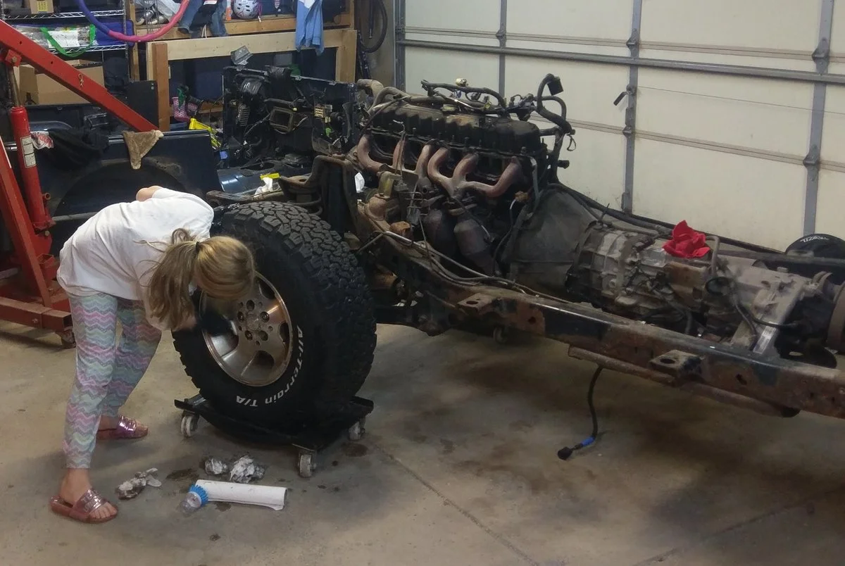

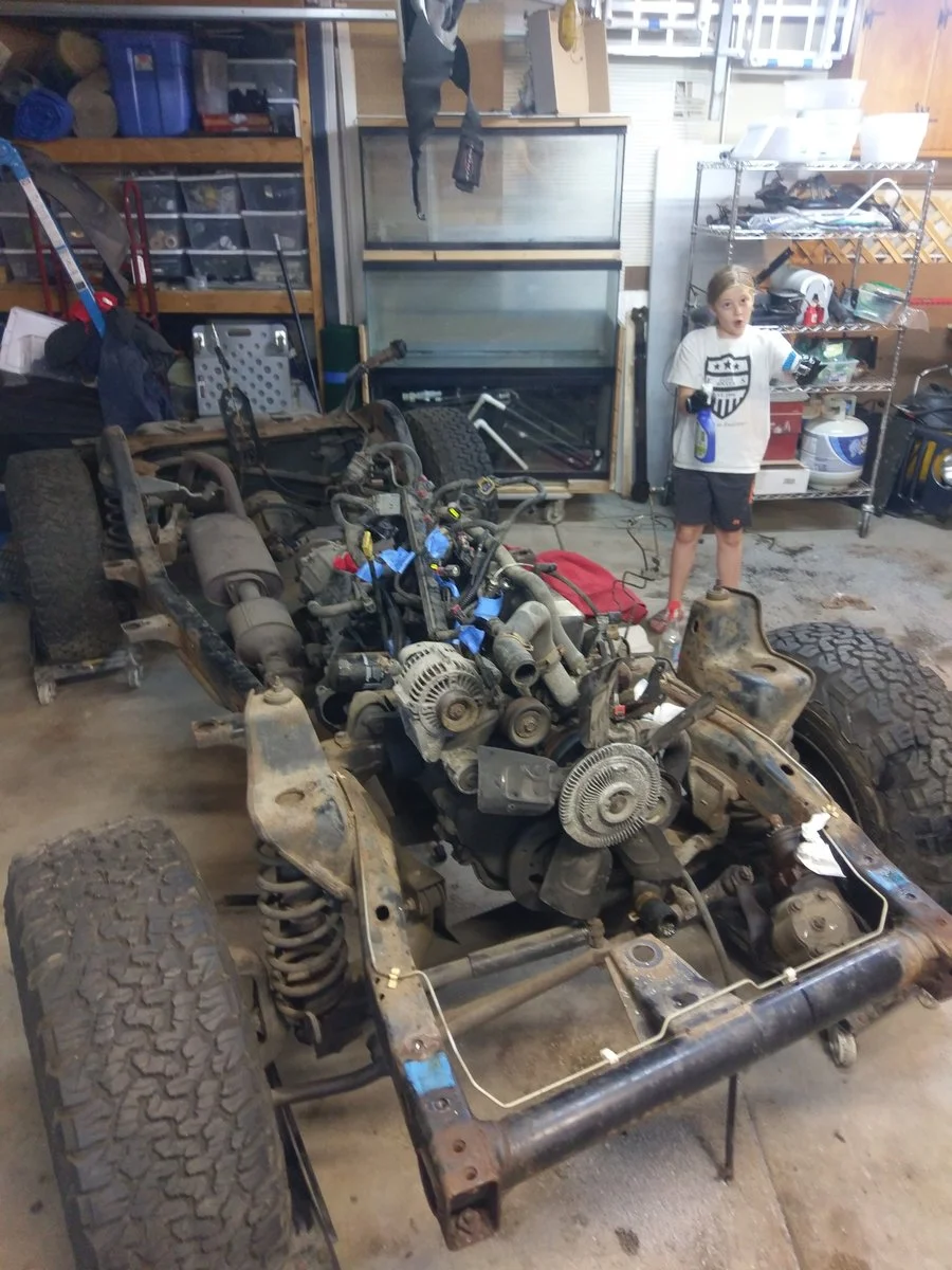

Busy weekend. I got the BGF ATs off #3 and on to the DD. I over them, they don't have the road vibration the BFG MT have and there is almost no road noise compared to the MTs. By far the best "upgrade" I've done to the DD so far. The rest of the weekend was filled with some more ups and a big down.
My daughter scrubbed the blue off the letters. I didn't have the heart to tell her bleach water was easier but I wasn't going to let her play with bleach. I threw a couple bucks for the hard work to make up for it.

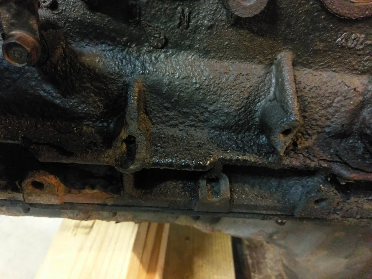

Friday/Saturday I found that the drivers side motor mount bolts had been ripped from the engine bosses. By the end of the day Saturday the forum had helped with a solution. Thread Here I'm going to create a plate and bolt it to the engine with the 4 remaining bosses and then weld on studs on to the plate for the OEM mount. Cheap, easy & safe.

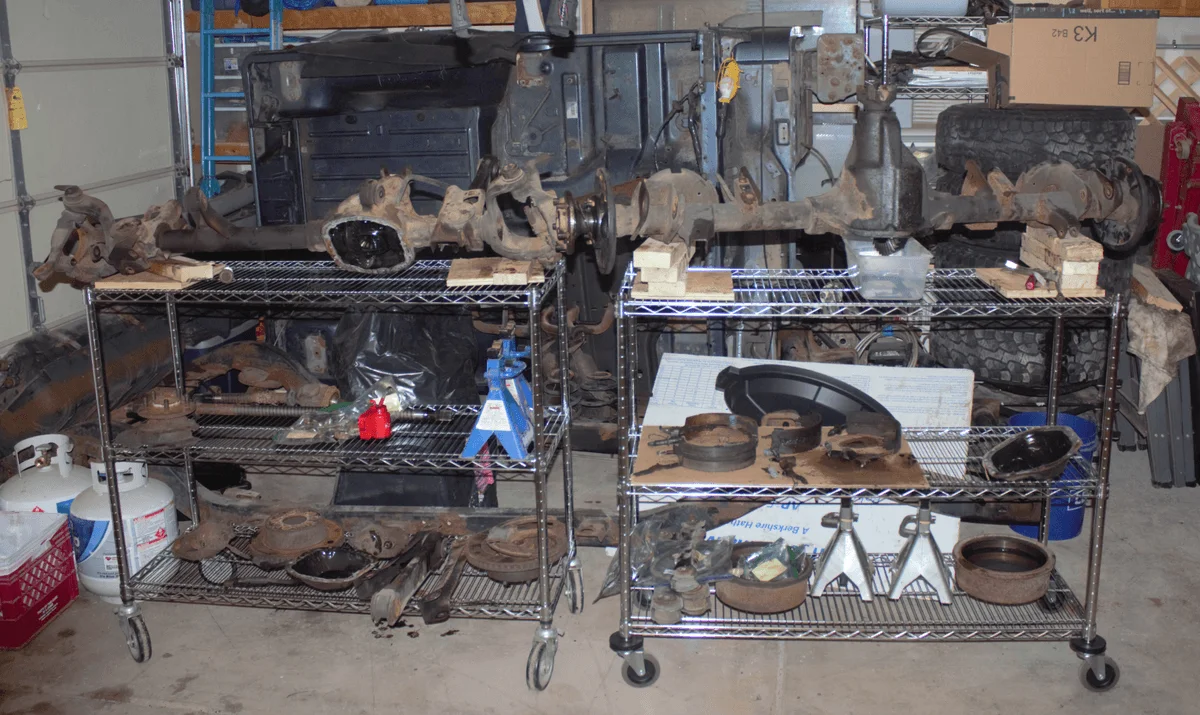

My wife's only rule with Jeeps, cars and the garage is that she gets to put her car in the garage when it snows. Knowing that I'm trying to keep the project mobile till spring so I spent the better part of the week looking for stands to rebuild the axles on. It's funny how sometimes the small things derail progress but it turned out some "cheap" Home Depot shelves are exactly what I needed.

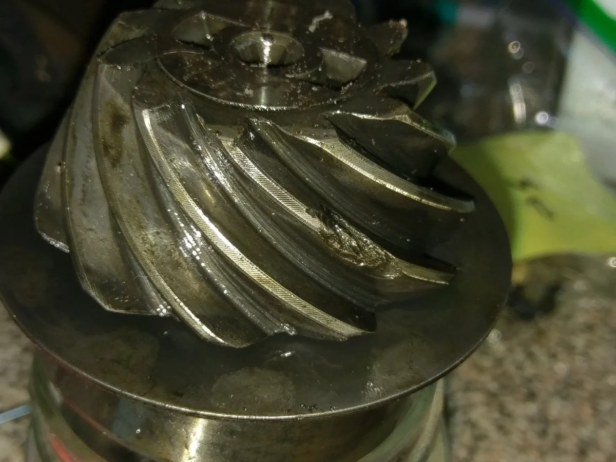

Today was a push. I worked on both diffs. No surprises with the rear Dana 44, it came apart as expected. On the front I found the front drivers side rotor was "fused" to the hub. Not a big deal, both will be replaced. The drivers side lower control arm bracket was bent. Again not a big deal, I knew that when I bought the rig. Finally the yoke doesn't spin freely, I'm hoping it's only a bearing issue.

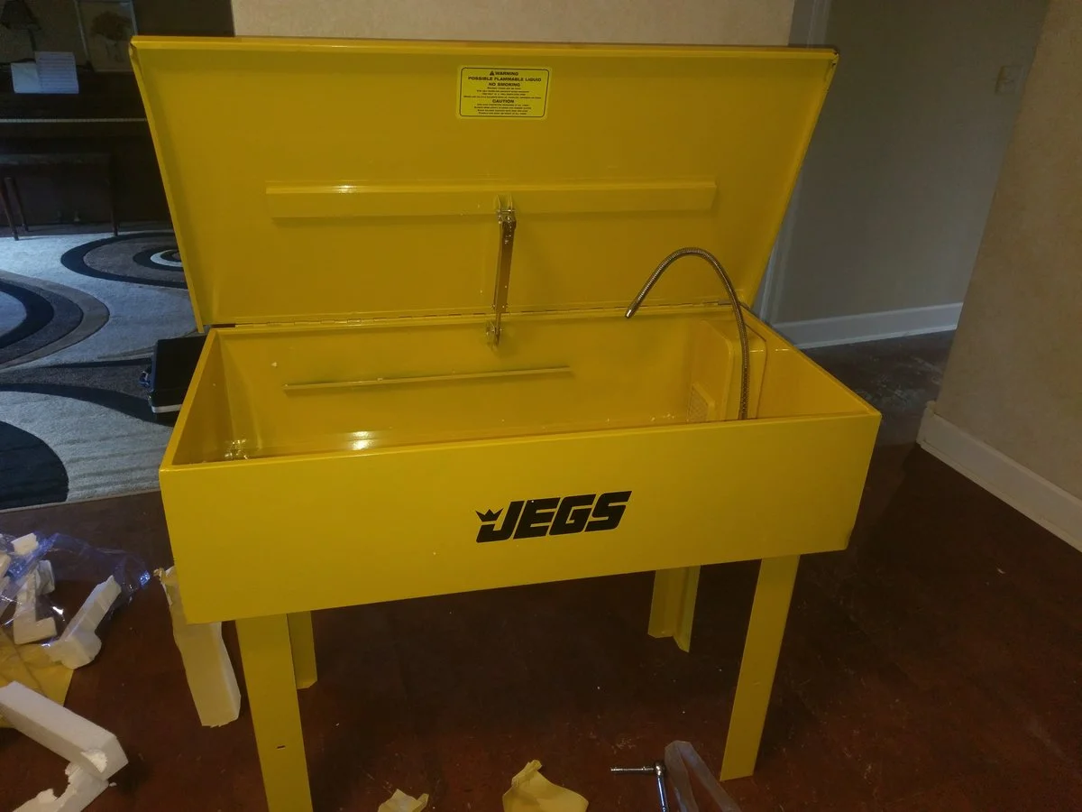

I picked up a parts washer that was delivered today. It came with no packing and dented which I should have expected from a cheap China product. Not the end of the world, it was on sale (Amazon) so I'll deal with it.

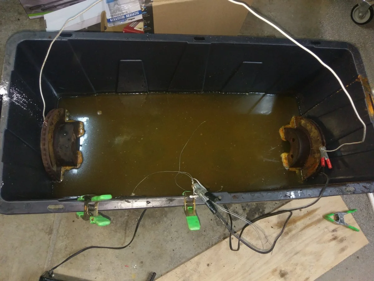

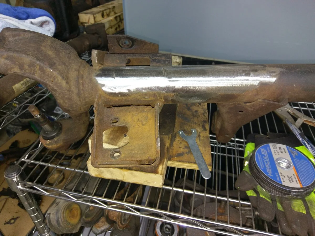

I also played with the idea of electrolysis. The rotors are the anode and there is a drive shaft and both Steering knuckles in there. This was a quick $25 experiment to see if the idea was worth investing any time in. < 24 hours in and it's looking good.

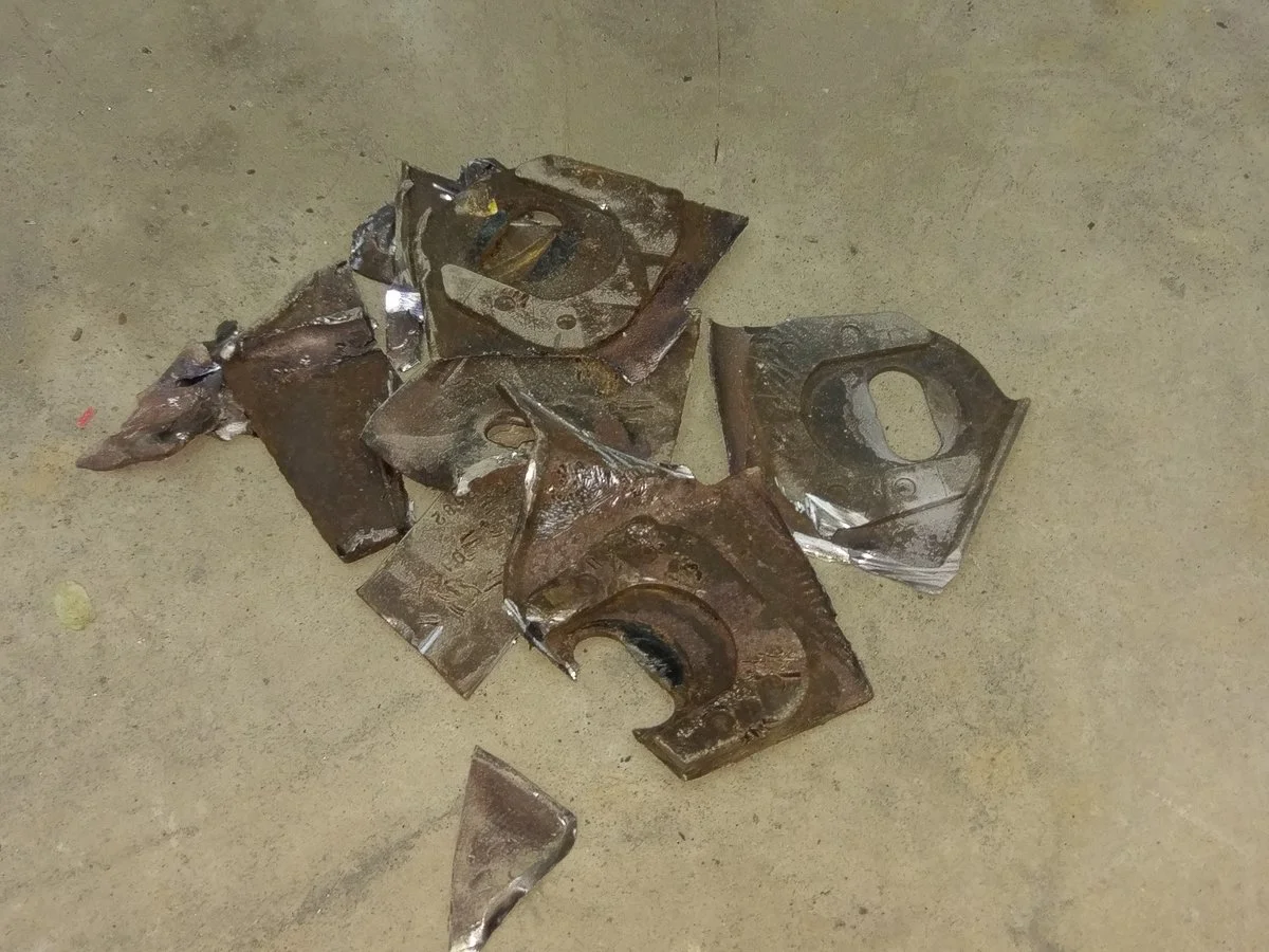

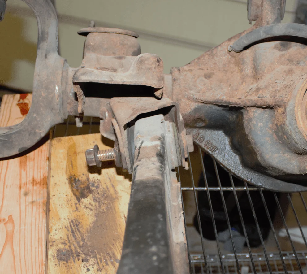

Not a ton of progress this weekend but I did get solvent for the cleaner, got the blasting cabinet going and got the lower control arm brackets cut off. New ones come tomorrow.
Next up is to buy a new, bigger compressor, build an air dryer, get the axle cleaned up and install the new brackets.
