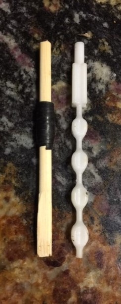

My chopstick has been going strong for ten years, with no signs of failure.
This is my spare along with the broken plastic rod out of my shifter.

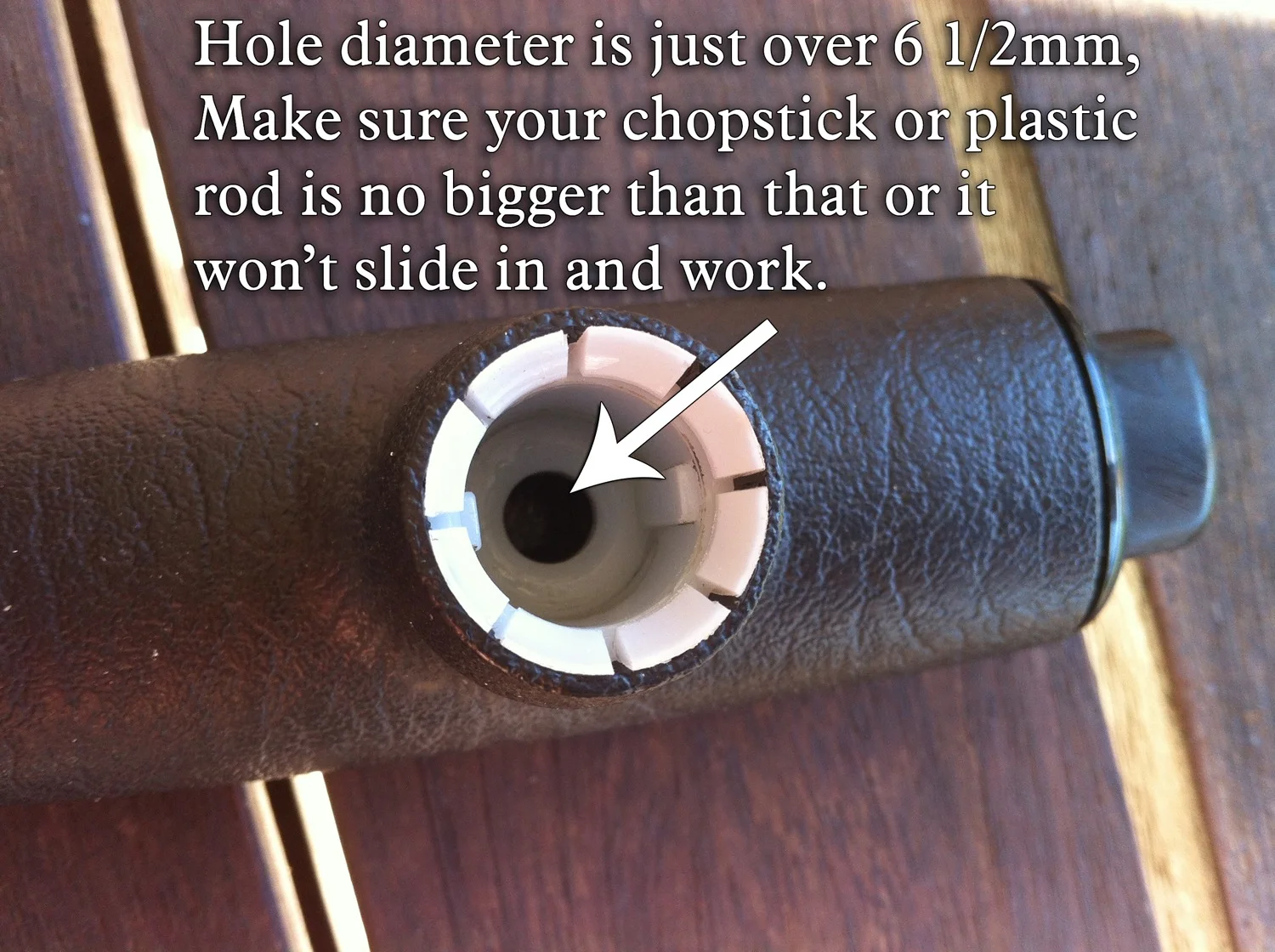

I removed my handle yesterday to check it out. There's a hole it the top of the handle where the rod slides into. It is just under 7mm diameter. I ended up buying two different size Knitting Needles, 6mm and 6 1/2mm, the 6 1/2 fits in nice with a bit of wiggle room, but I will keep both in the Jeep, just in case. So, make sure if you carry something other than a chopstick, it's not over 6 1/2mm in diameter or it won't work.

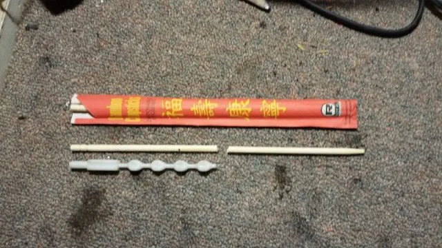

I did this one morning on the way to work. That’s the beauty of these forums. I looked it up, found the same post and had it fixed in under 10min. I had to use a rubber mallet to remove the handle. After that, I put the chopstick in with the pointy side up and it’s worked for almost a year, so far. I have a metal rod in the Jeep cut to the same length in case the chopstick fails.

A chopstick works great. I wrapped some electrical tape around the middle to help center the stick in the tube (I assume that is the reason for the balls on the factory stick). I might buy a 6" piece of 6mm brake line for a slightly better "fix".

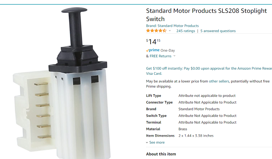

UPDATE:
The plastic piece was not the issue.
-The shift interlock includes a safety feature that requires you to press the brake before you can shift out of park. So we thought there may be something faulty with this.
We disconnected the shift interlock and then it would shift just fine, however, you could now put the jeep in gear without the need to push the brake. With my 18 year old son driving this Jeep, I wanted this feature to work. I didn't like just leaving it unplugged. so we did more research.
In addition to the shift issue, we also discovered that the brake lights weren't working. So we guessed that the two issues may be connected. Sure enough it was.
We purchased a stop light switch for $15.00!! (Link below) Popped the switch in, brake lights work. Reconnected the shift interlock, and bam! Shift now works with no trouble along with the brake lights.
