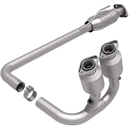

Your 2003 had 3 catalytic converters from the factory. 2 upstream, 1 downstream.
Reactions: defenderu
Correct, it currently only has the 2 hollowed out cats and nothing else except 2 custom resonators. The PO was going to try and use a tuner to delete the cats but that’s not an option for me. I’m trying to start with the 2 cats below the manifold first to see if that remedies all the O2 codes I’m getting and perhaps in the process will make it run better.
