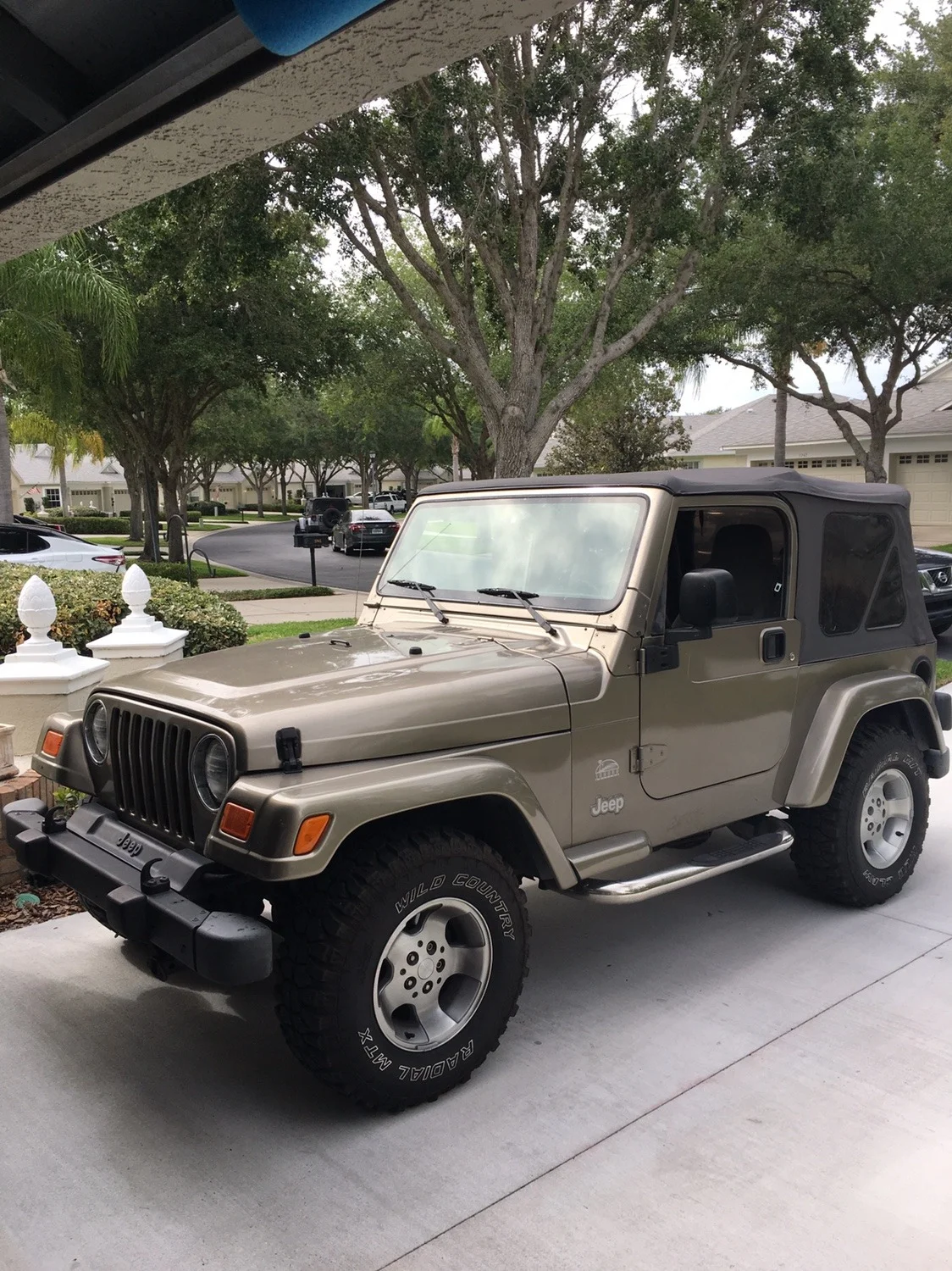

I picked up a 2003 TJ Sahara in May of this year. Mostly stock condition accept for the 31 MT tires. 4.0 engine automatic. Has 136,000 now since I’ve been taking it to the beach as often as I can.

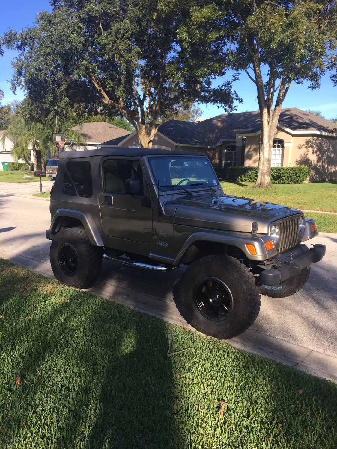

I have done a few things cosmetically but nothing major. Until now. Friday, the TJ gets a lift. Going with a 4.5 inch super flex lift with mono tube shocks. 35x12.5 Mickey Thompsons MTZ Bajas on 17” Fuel Trophy’s. The question at this point, is a 3.73 gear gonna get it with this package?? I hear yes but would like some feedback. Here is a before pick. Will follow up with an after pick this weekend. And so it begins.....
