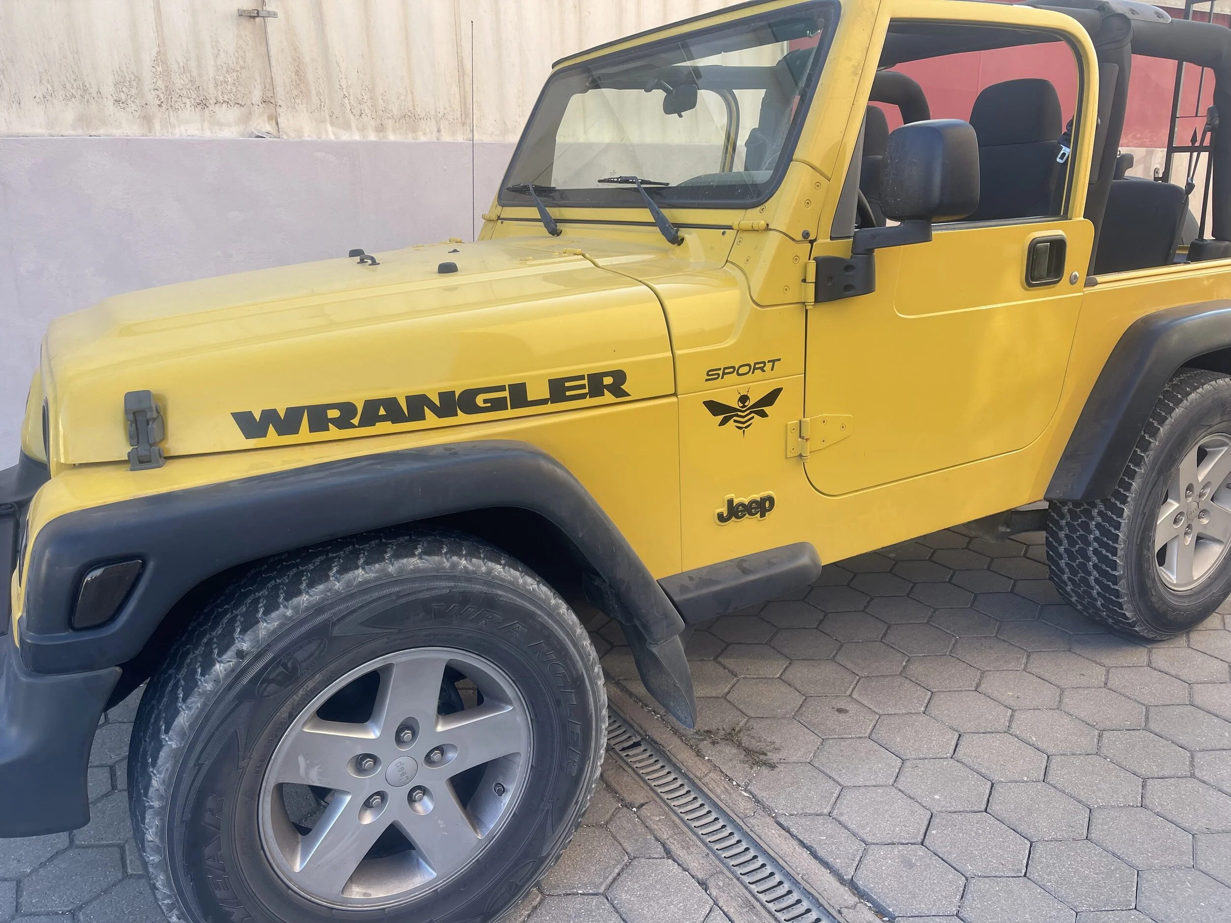

You can run your VIN here to see what size tire your Jeep was actually equipped with from the factory. If those are the stock wheels, it was likely 30x9.50r15. However, I don't believe the 15x8 Canyon wheels in your pic were available in '04, I think they had changed to the Ravine for the 15x8 option.
