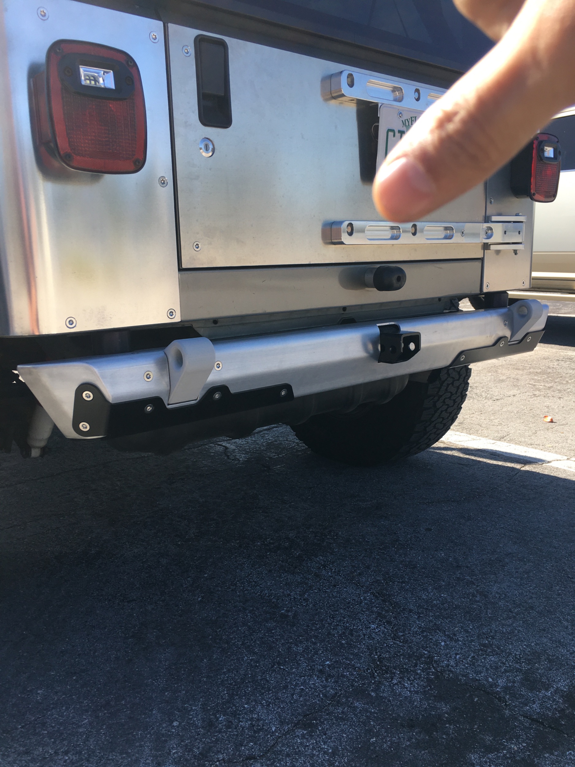

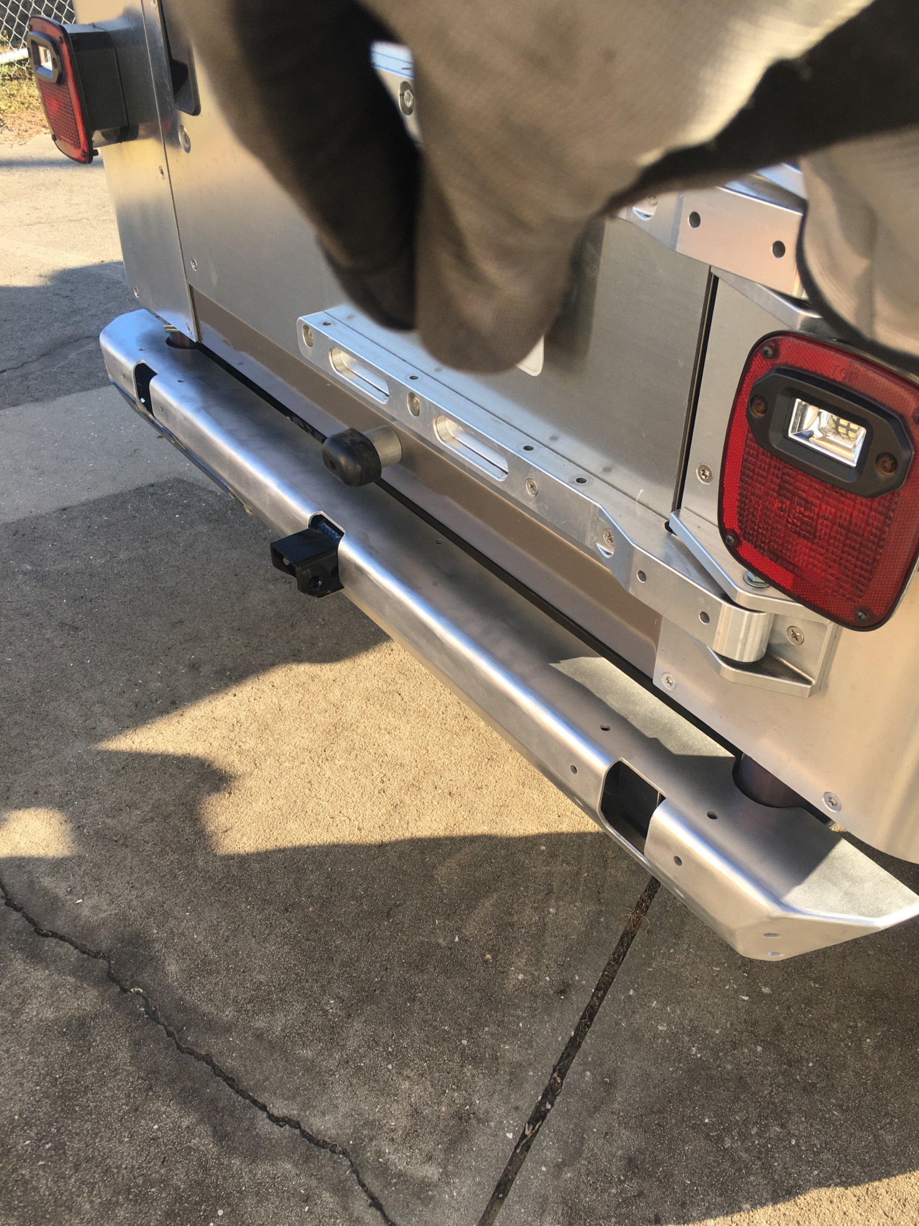

Two versions. One with hitch and one without.
Adding the hitch later would not be a huge big deal. Measure twice, drill some holes and connect the dots.

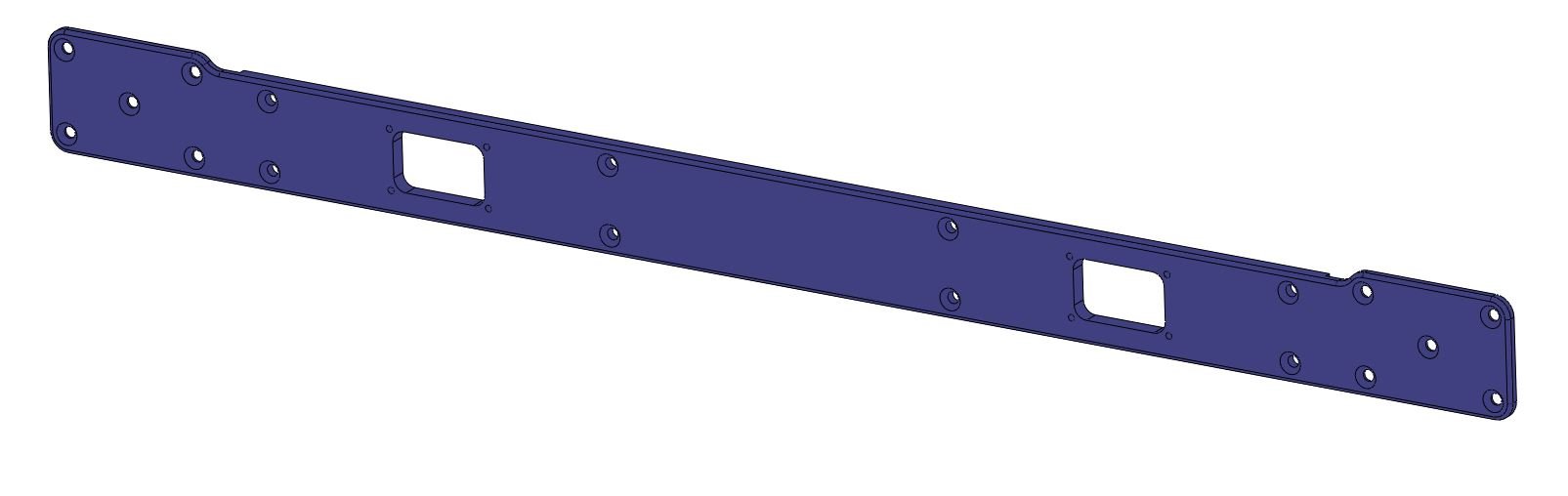

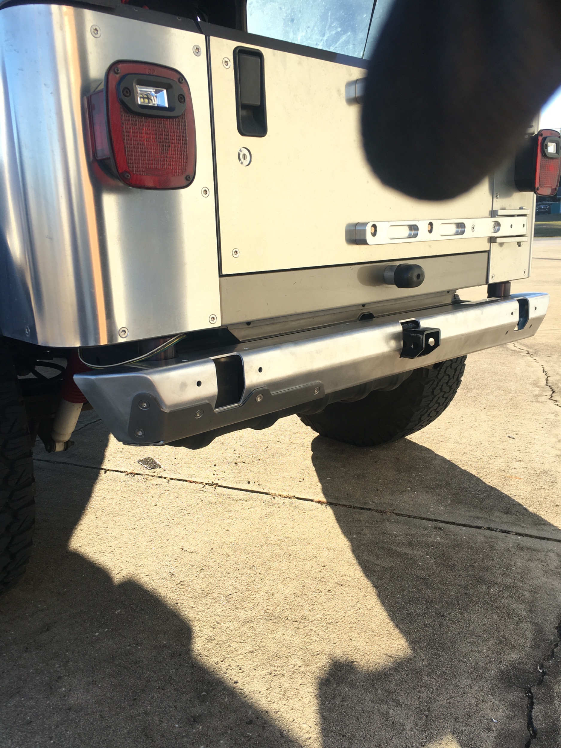

I had a customer ask about making a rear torque box stiffener like the one @mrblaine makes. At first after talking to Blain I said no, but then after talking some more I said why not, lol. He makes them custom fit each jeep to perfection with NO gaps anywhere. Part of the issue is everyone mounts their corners slightly different. One side may not line up with the other etc. These will have a small .0625 gap from where I think your corner will end and where the base plate will begin. You may have file some material to make it fit, again there is zero way for me to tell how and where all corner guards will end.
Please let me be clear this is his idea and design not mine. He has given me his permission to make some of these. This one has the cutouts for the BAJA designs S2 back up light. I still think its a better option then what I see on the market in regards to looks and function.
The customer that asked and I said no has first dibs!

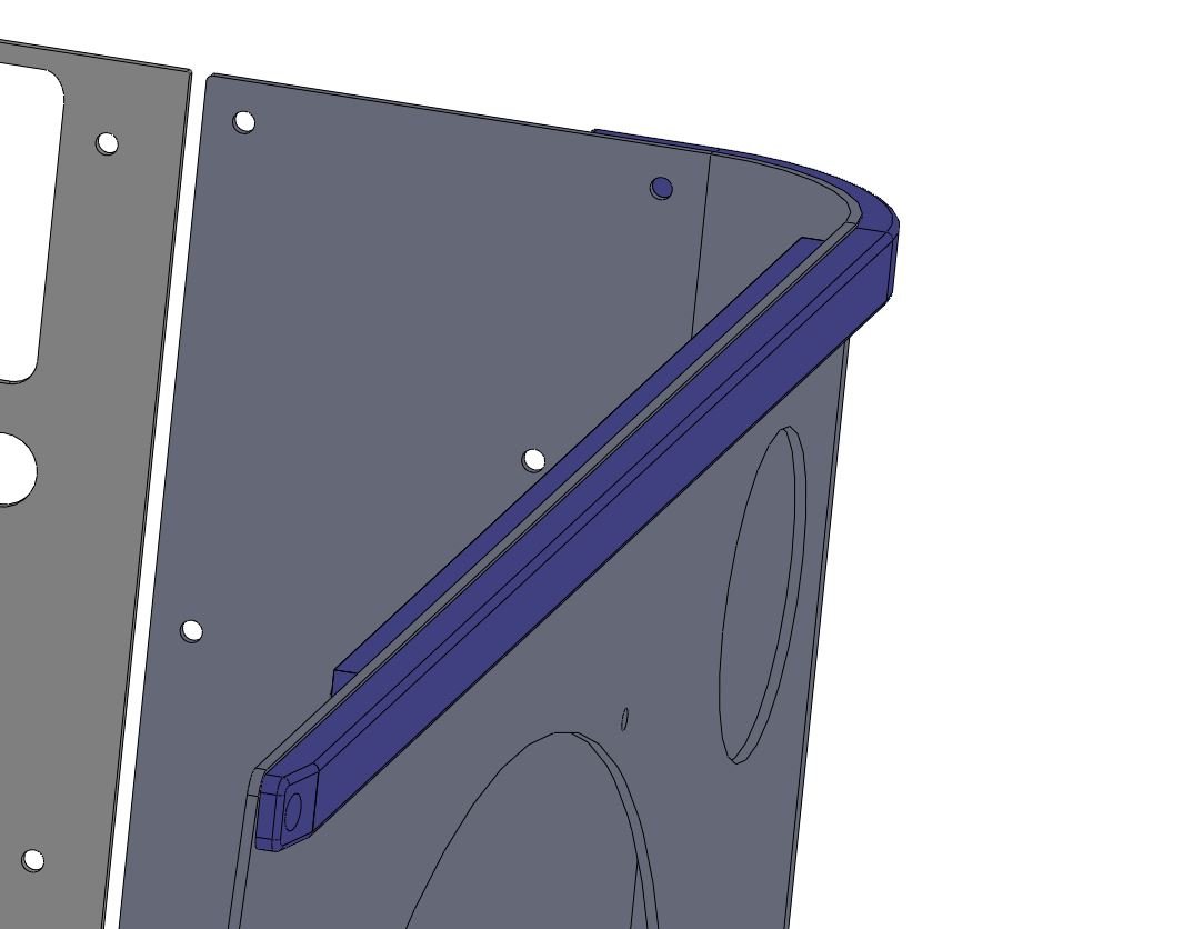

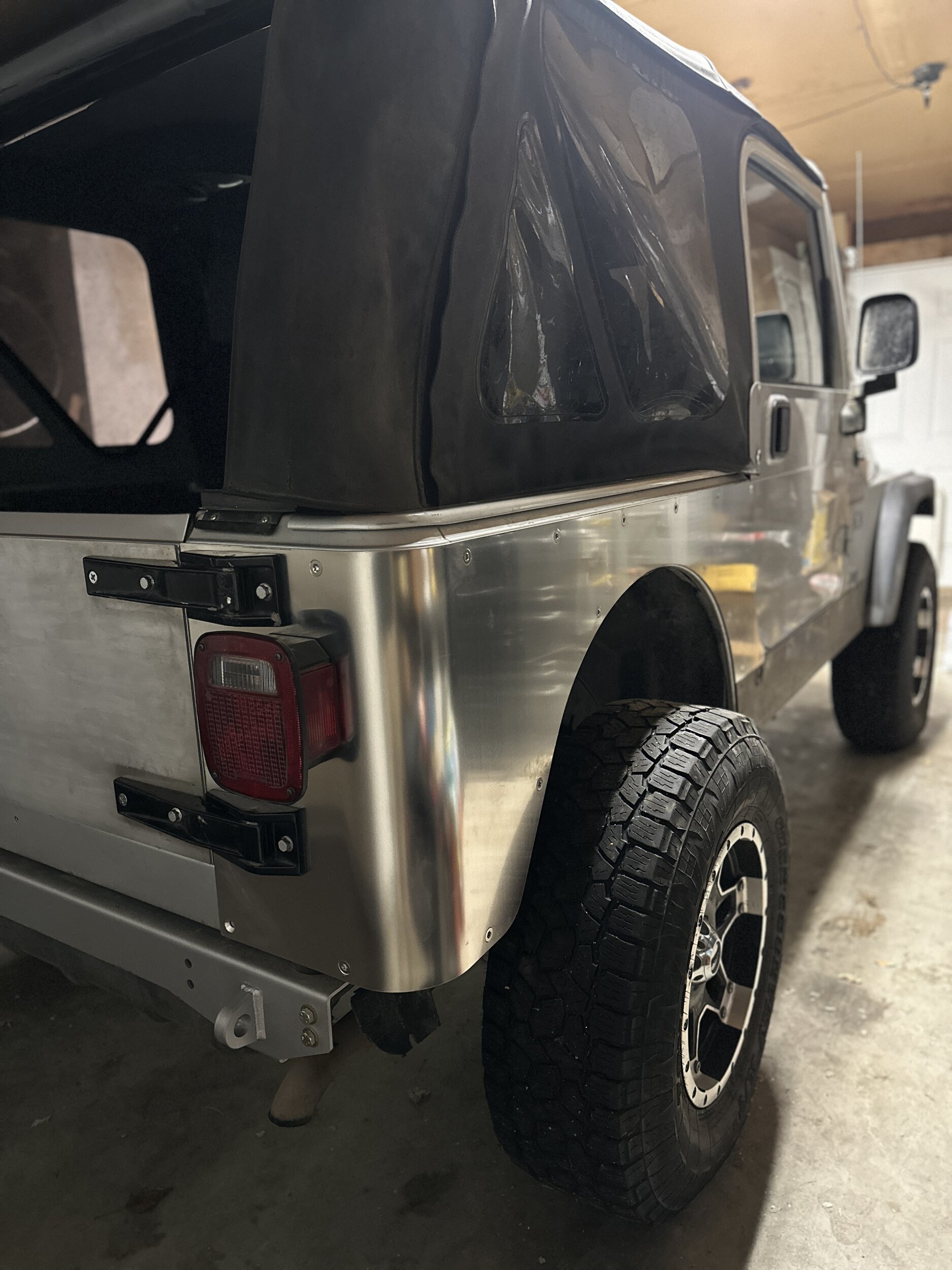

I am also working on rub rails. I need to check on a few things before these become real. I think I can bend them in the press I made for the corners. Time will tell. If need be I can make a press and tool specific to this part. 5/8x1.25 6061.
