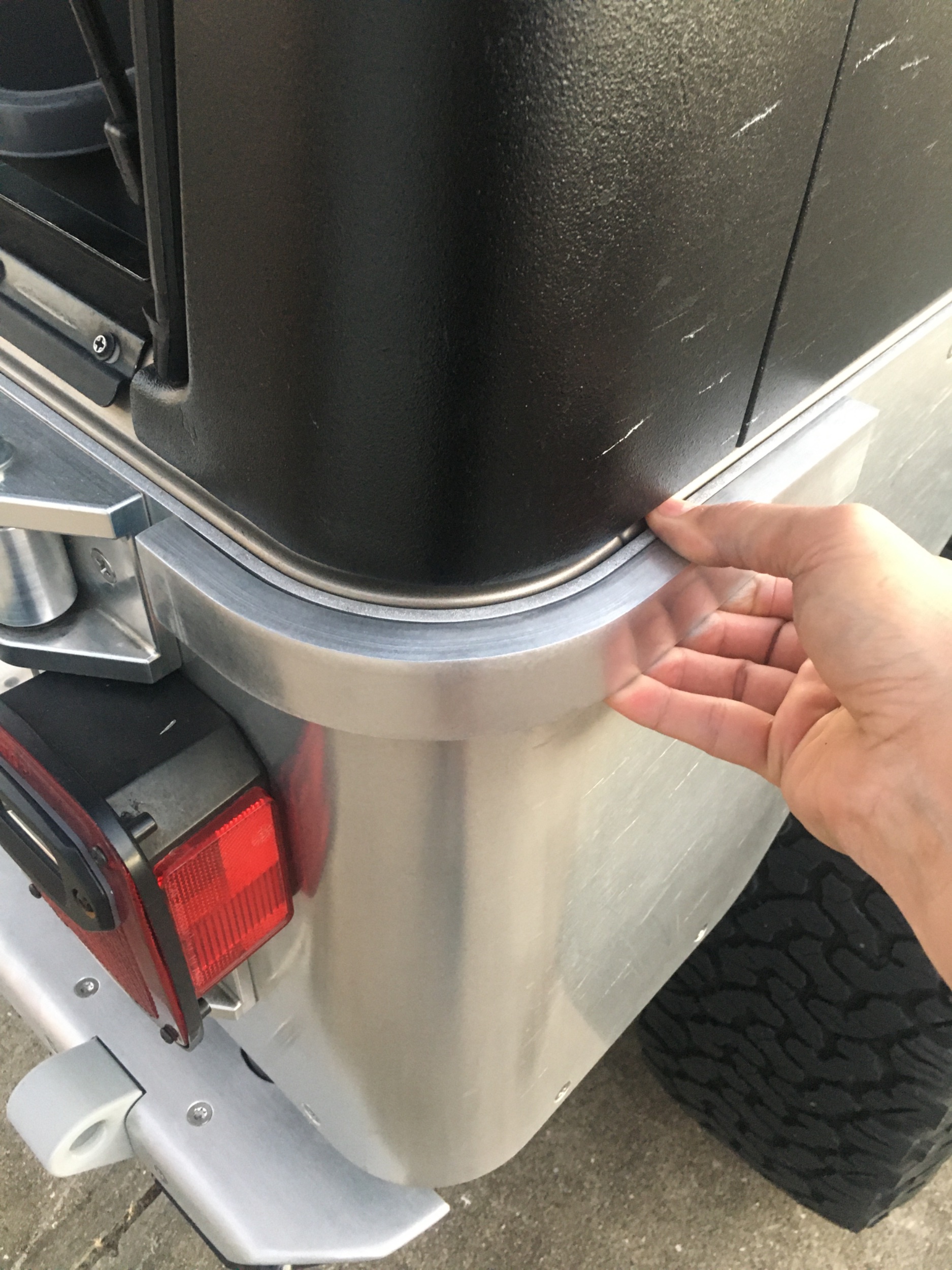

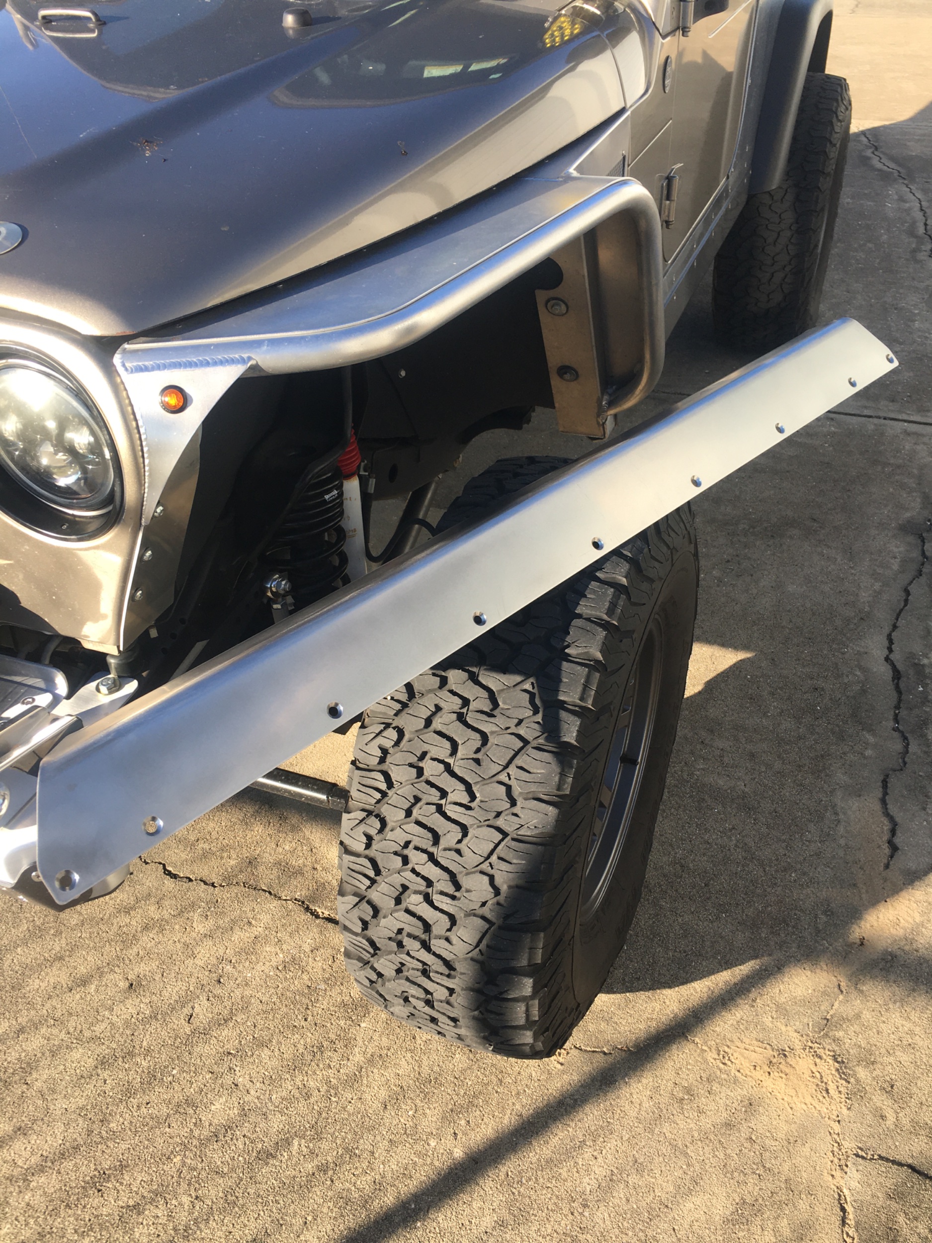

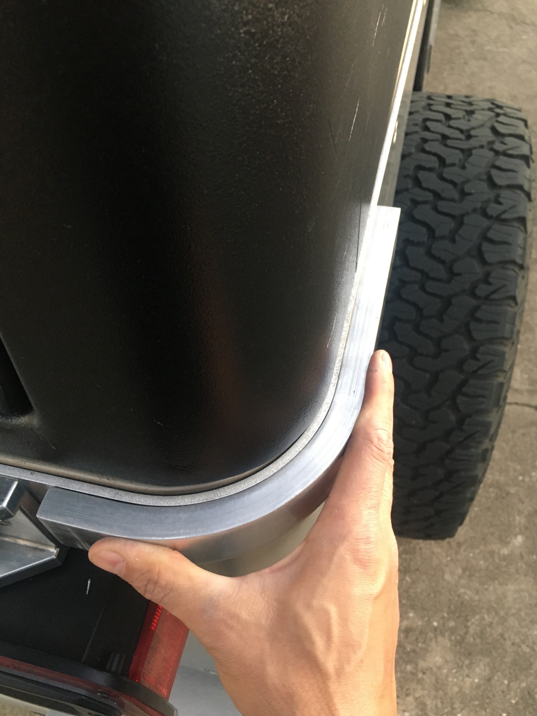

I was asked about stainless I while back and did not have the capacity to determine if the rash guards could be counter sink with out eating bits and becoming a nightmare. I had a customer that was willing to pay and wait for me to try and it worked out. My TJ rock slider kits would increase by $100 (LJ would be similar) to upgrade the rash guard to stainless. Seems like a no brainer but I’m curious to what you gents may think.
The brake press tonage was almost double to bend it. Crazy.
Pic of the stainless LJ rash guard.
