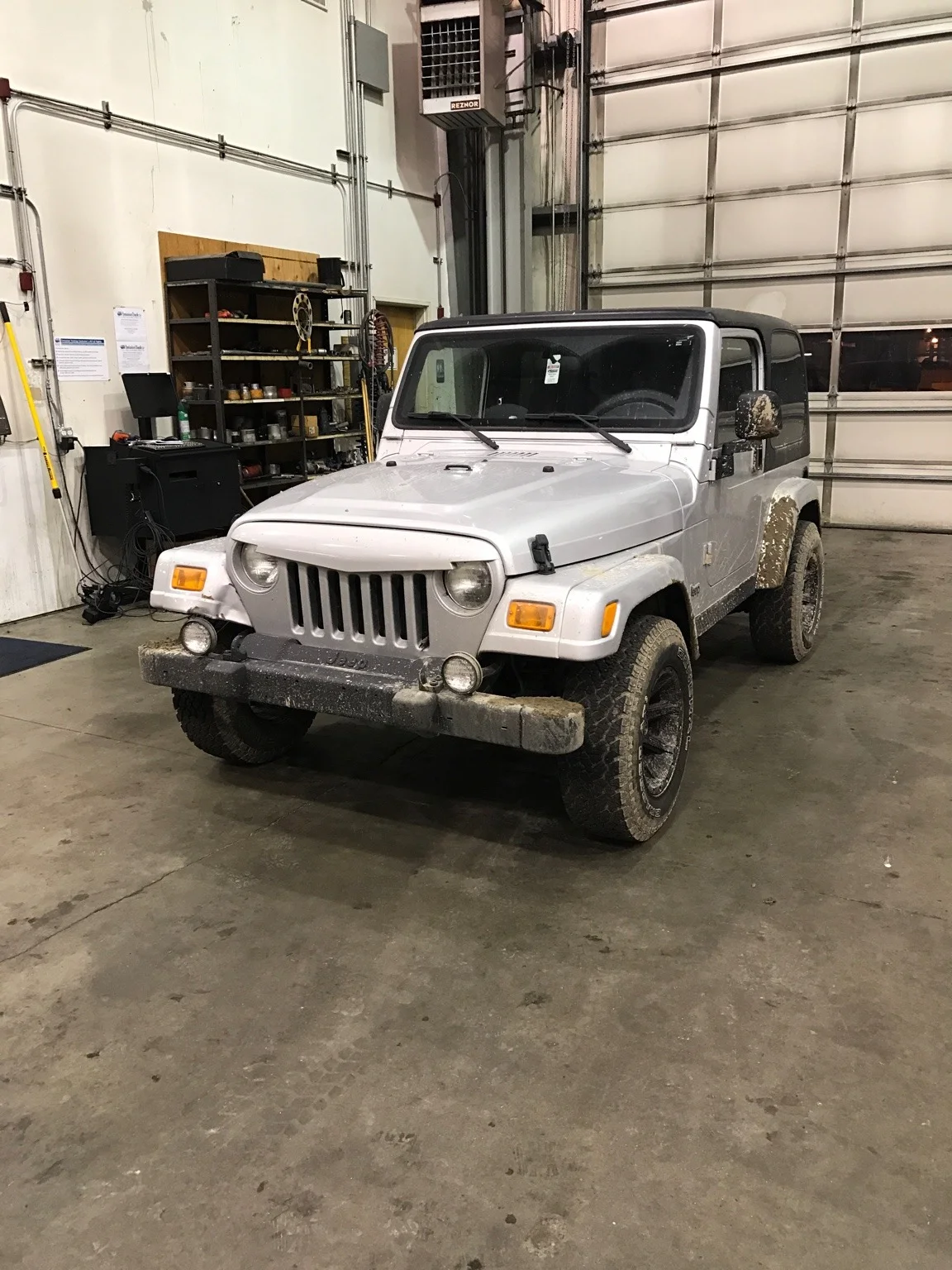

I'm coming up on 100,000 miles for my jeep, it sucks I know. I was wondering what everyone usually does for a full service at 100k miles for a jeep. I've owned mine for just over a month now and I want to keep it running solid.
Thanks in advance!
