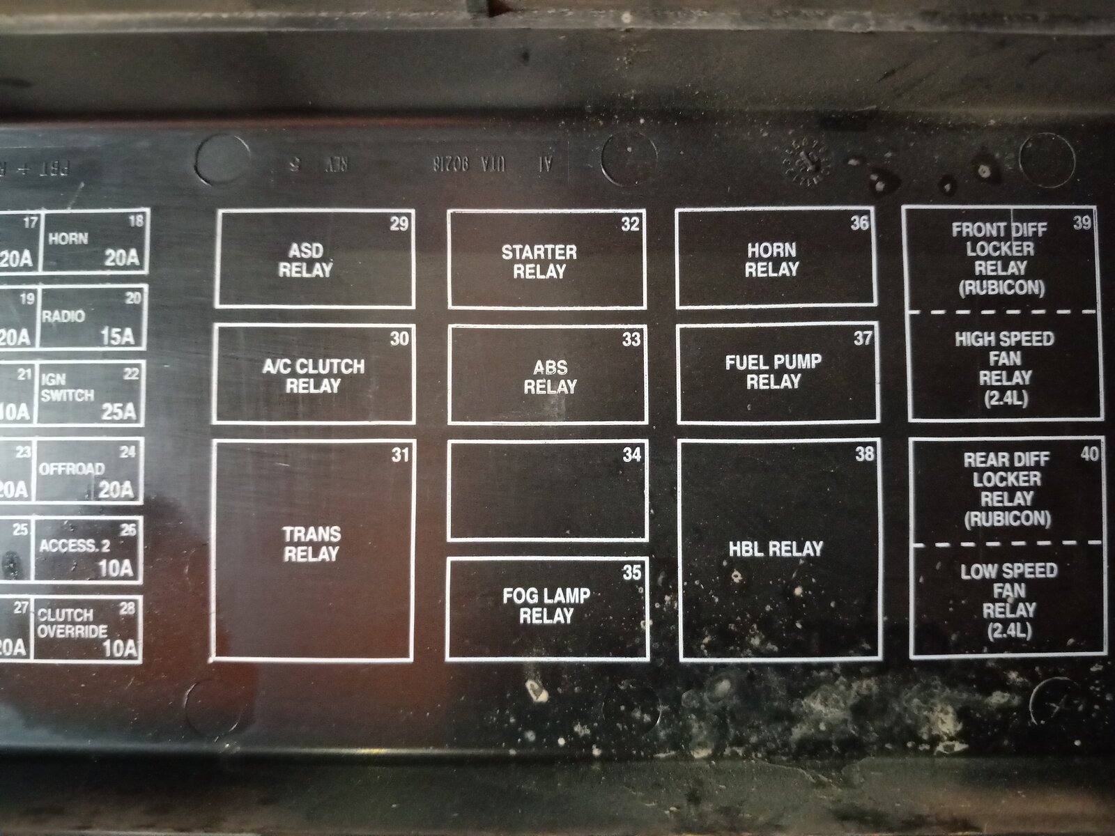

Have a new to me 2004 Jeep TJ Sport, 4.0 auto. The previous owner removed the stock fog lights. Looking to re-add some fog lights. Found what I believe are the fog light wire harnesses on each side of the jeep behind the marker/turn signals. But turning turning them on via the MFS stalk doesn't seem to supply any voltage to the wires. Used a multimeter to check for voltage and get nothing, don't have lights to actually hook up yet. Checked the fuse #19 in the under hood fuse/relay box and its good. Not sure what else to check.
There should be a relay in the pdc (under the hood). Its only for turning the fogs off when brights are on, but it still needs to be there. Or jumpered out.
Do you happen to know which relay. Going off of the diagrams/info on fuse-box.info don't see anything related to bright relay. Thanks
On my '06, it's 35.
You could test it by swapping in relay 36 (horn).
