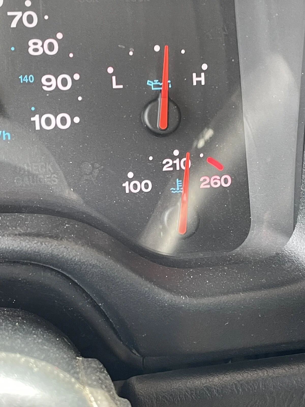

I've been trying to pinpoint exactly what's causing my 04 TJ to overheat as well and I'd like to point out something I didn't realize was a thing. Some of you may already be aware, but the OE coolant temp gauge does not give an accurate coolant temp reading the same way the oil pressure gauge does not give accurate oil pressure readings.

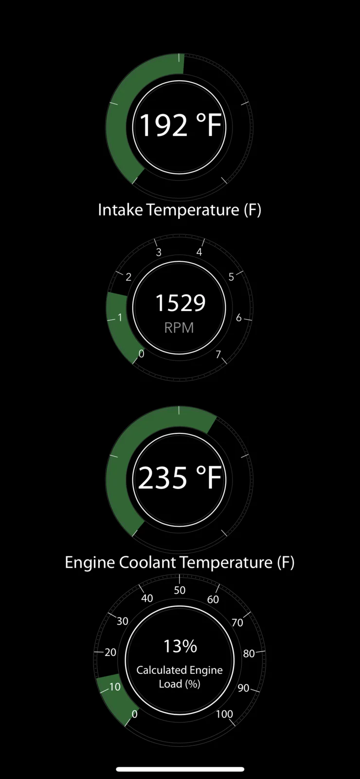

I figured this out by accident when my Jeep threw a code and I plugged in my code reader to check it out. Basically, if the needle in the temp gauge is even slightly above 210, your actual temps could range anywhere from 215-250 with the needle still on the "0" in 210.
In the pic, it's showing just above 210 what I expected to be 212-215, as a few others have reported, but I've seen temps on the scanner hit 250 with the needle in the exact same spot. Obviously that's no freaking bueno. The issue is exaggerated with the AC on and only delayed slightly with it off. Cranking the heater to max will eventually bring the temps down.
