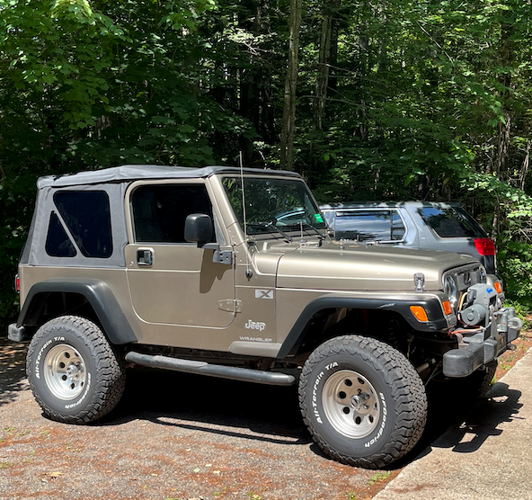

I have a 4inch lift that was on the jeep when I bought it
it had 20,000 miles when i bought it, the 2cd owner bought it late in the mileage (right front accident-young lady)
and had the lift kit put on it. then towed it to Alaska and back behind his camper spent alot of time Parked and collecting dust after the trip
I got the death wobbles 1st day of driving it home Paid 16,000 for it.
tires were very worn and top was dry rotted
Bought new Tires (stupidly) the same size that was on it-—--33" BFG all terrain T/A on aluminum rims(made for Jeep) No spacers (need to find what brand)
and a new soft top
Also NEW steering shock
its been riding OK with no vibrations to speak of.
it has a heavy winch on the front thats maybe been used twice?, Ive never used it except to make sure it worked
Ive put 18,000 on it since the above fixes
but now getting vibrations while driving
inspection for sticker passed with flying colors (Maine)

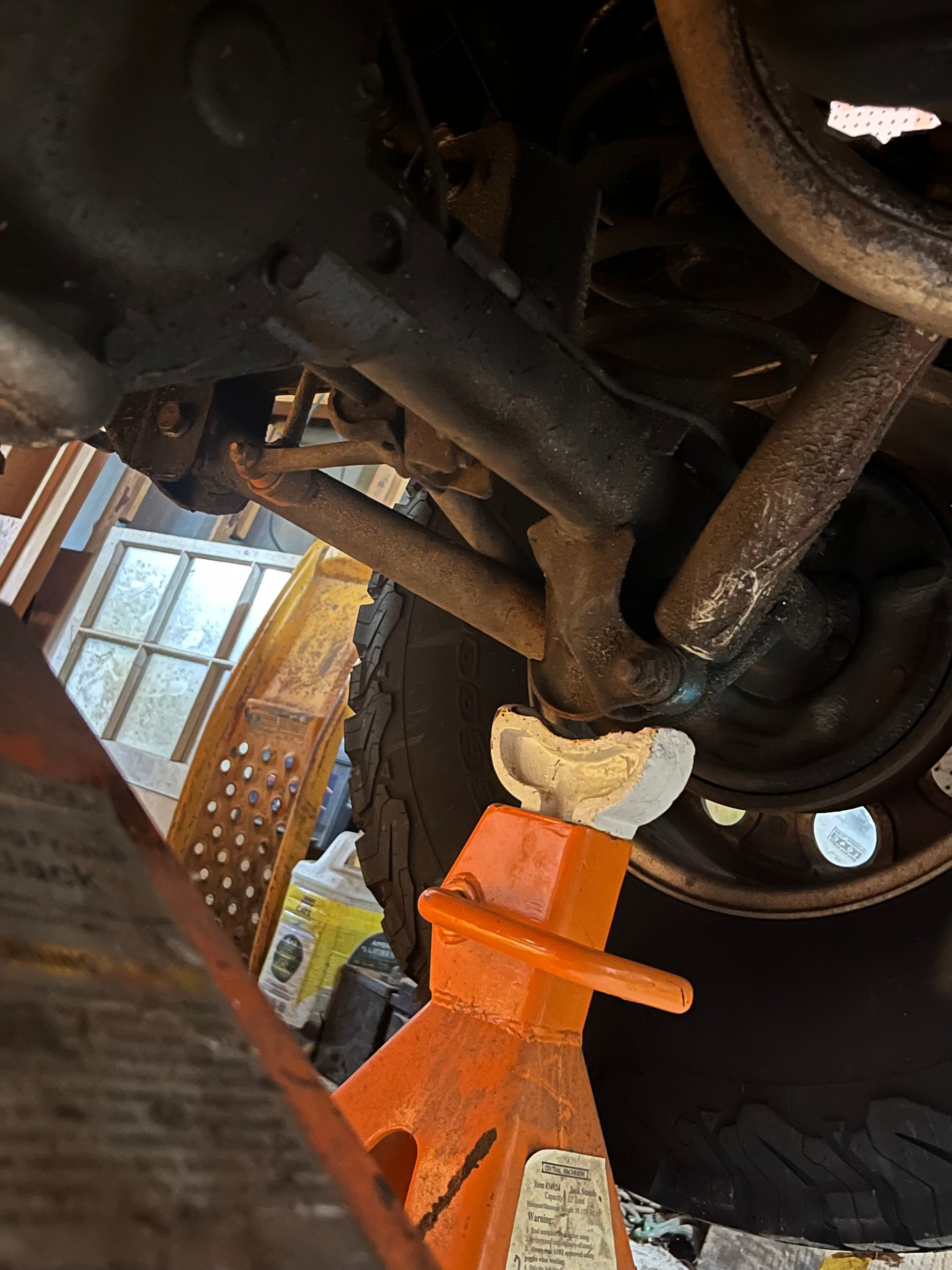

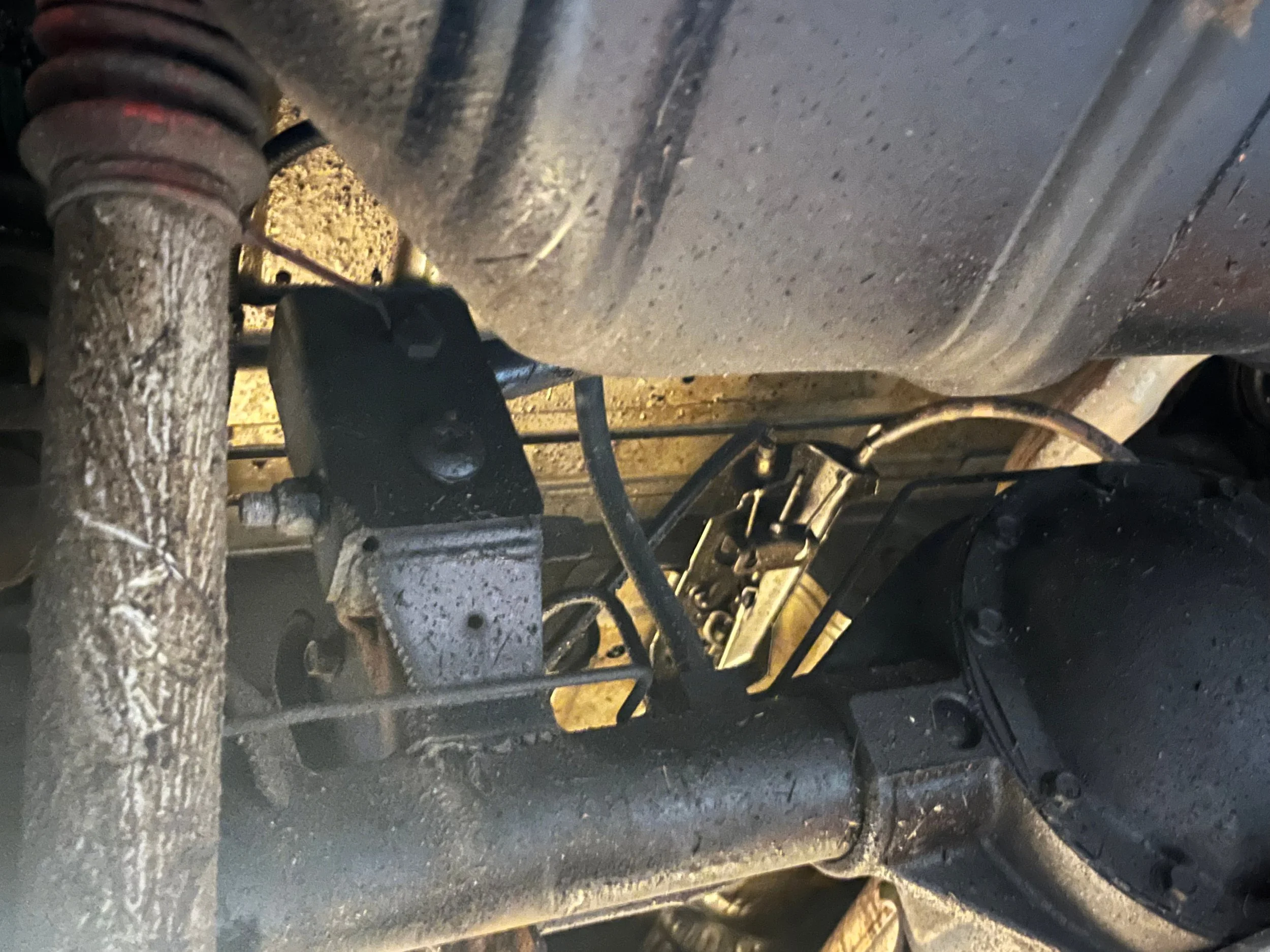

Heres what i see underneath
Lift Kit--Skyjacker 4inch
TOP control arms are Original front and back
Bottom Arms have been replaced with (kit)? arms solid no adjustment
Tranny Pan has a 1inch drop and linkage has the linkage drop kit
front track bar seems to be original
has quick disconnect links up front and kit links on back
rear track bar has the metal adapter
pitman arm also changed out

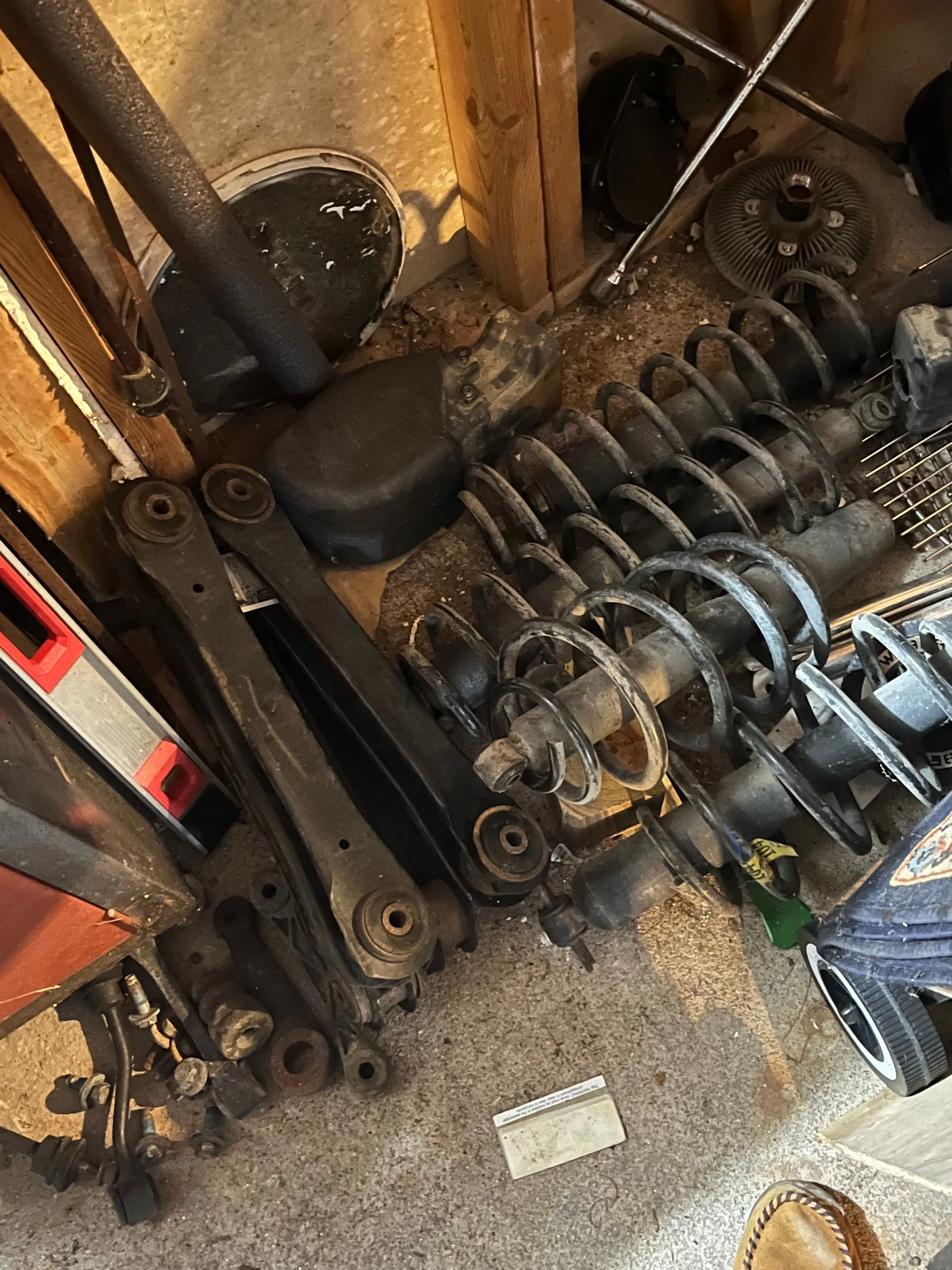

He did give me all the old original parts
lower arms
piman arm
control arms front and back
original springs front and back
bolts for the tans/belly pan
shocks all four
Original rims with very worn out Tires

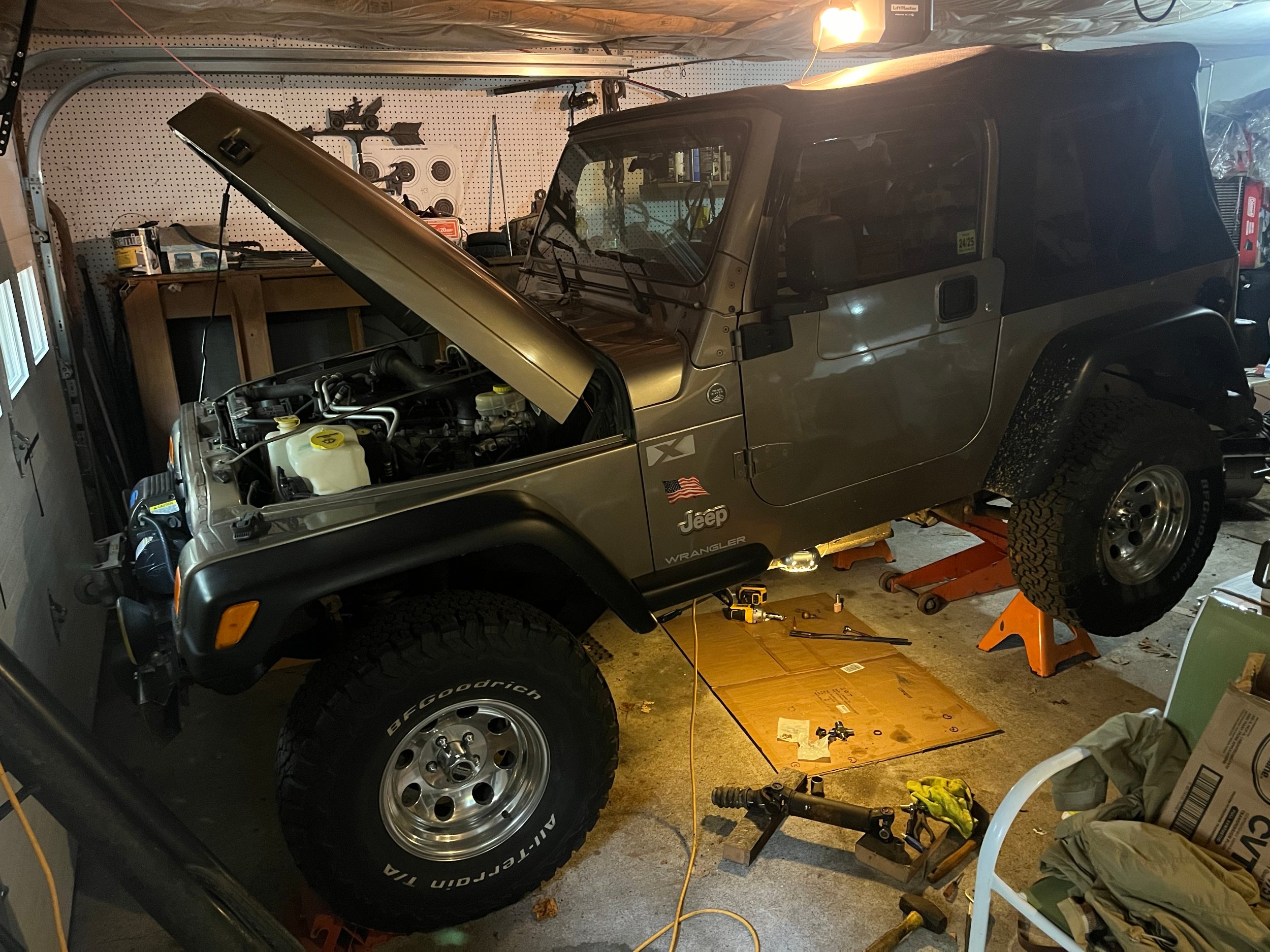

ive got it jacked up now and im going to check the U-joints
ive an appointment the end of the month (payday) 120.00 to have the mechanic re-balance tires, and check suspension,front axle u-joints, ect ect
