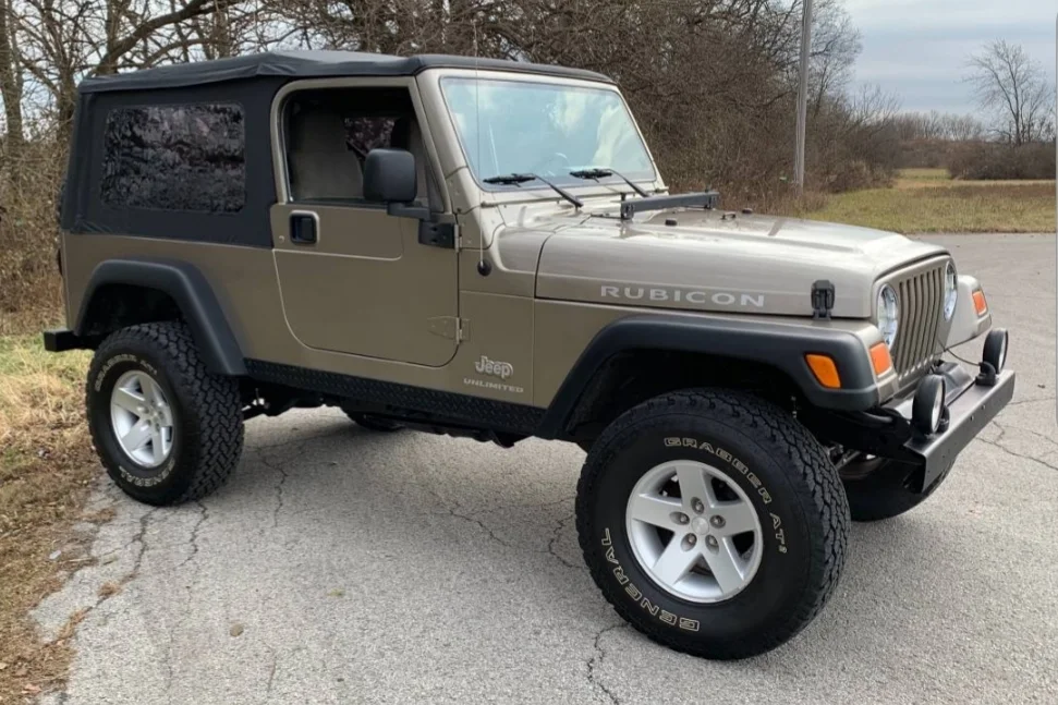

First time posting. I just finished with a coolant overhaul on my recently purchased 2005 LJ Rubicon 4.0 with 100k miles. This included: new radiator, water pump, thermostat, fan clutch, water pump tube, serpentine belt, upper/lower radiator hoses and gaskets...using Mopar parts. Before adding fresh G-05 Zerex coolant I stumbled into threads about draining the old coolant in the engine block...which I did not do. With the effort I did to replace everything I want a complete and clean overhaul and it seems there is a lot of coolant that sits in the engine block. I don't like that I missed old coolant that can get into the new parts. Questions: Do I just drain the engine block through the engine block drain and add new G-05?...or, do I need to flush the engine block with distilled water (somehow)? Was putting on a new bottom radiator hose enough to get all the coolant out of the engine? Thanks in advance for answering!
