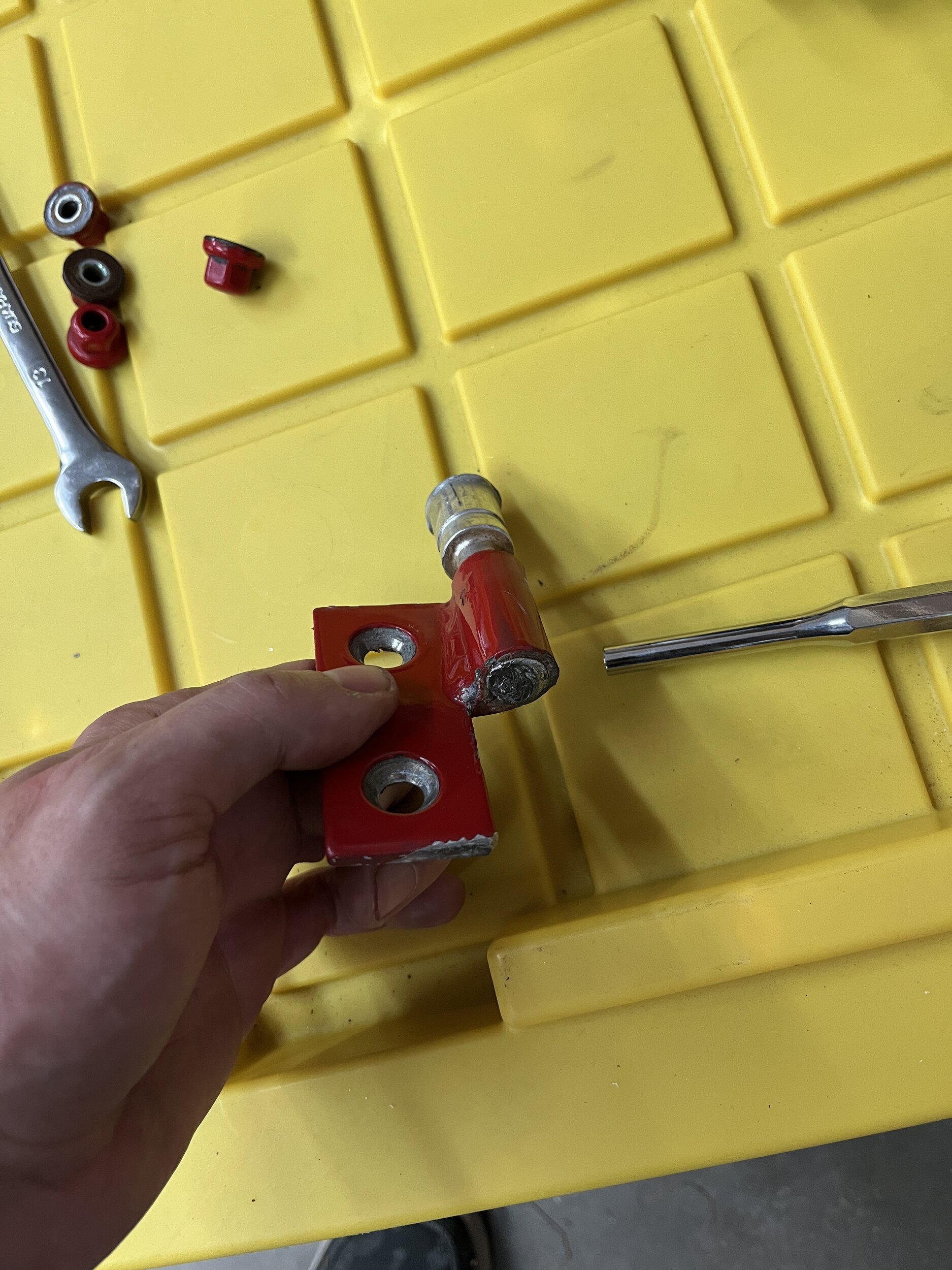

Had a 'whoo-hoo' moment immediately followed by a 'boo' moment. The driver side full door came off like it was put on yesterday. The passenger door... not as much. Looks like I'll be going at it with a floor jack later.
EDIT: I took another pass at the door and got it off by lifting and pivoting on the hinges. It came up and off about 1/16" at a time.
Those bushings though... I'm deforming the removal tool with a hammer and they're not budging. I have them soaked in PB Blaster while I do some other work.

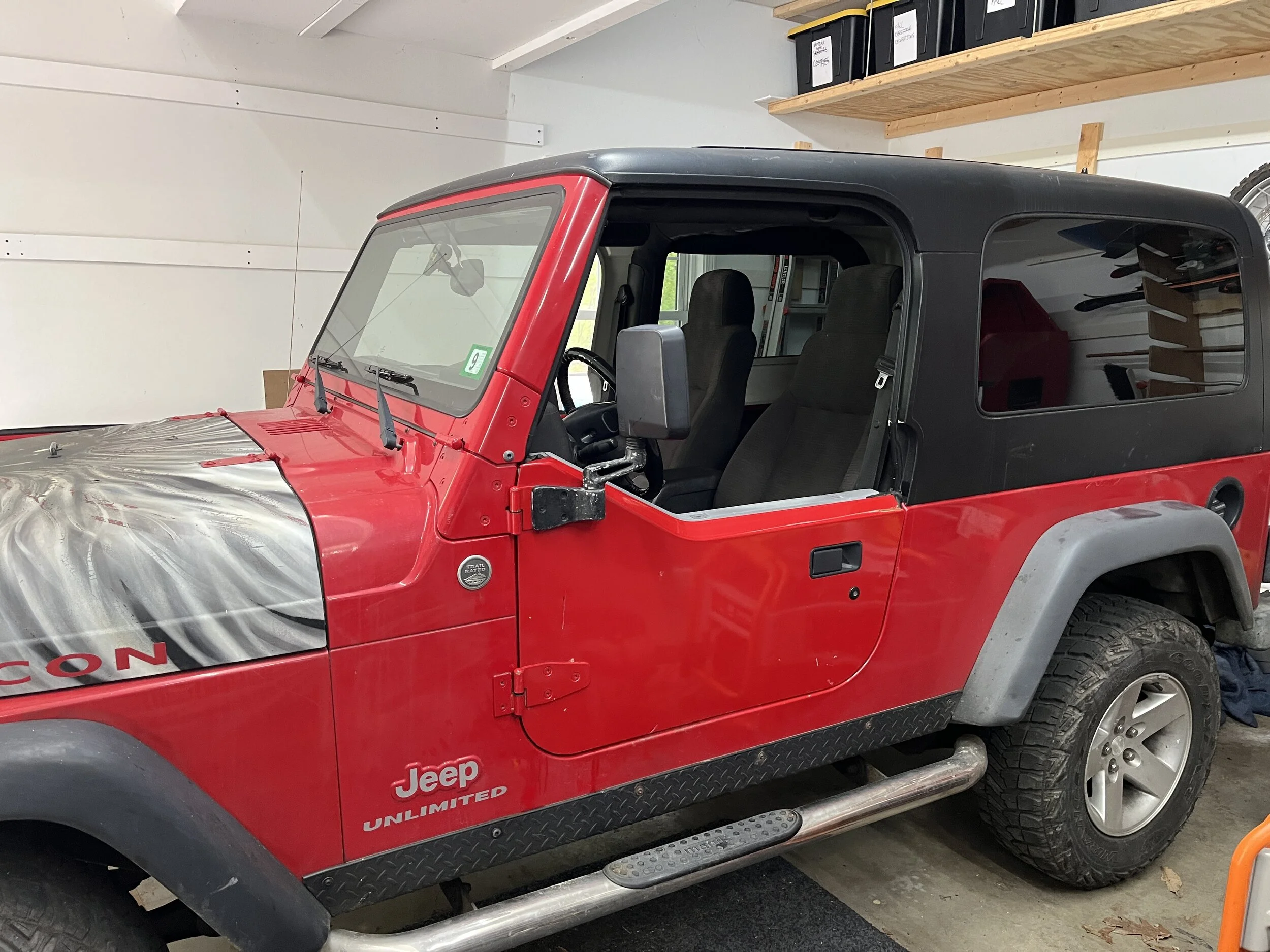

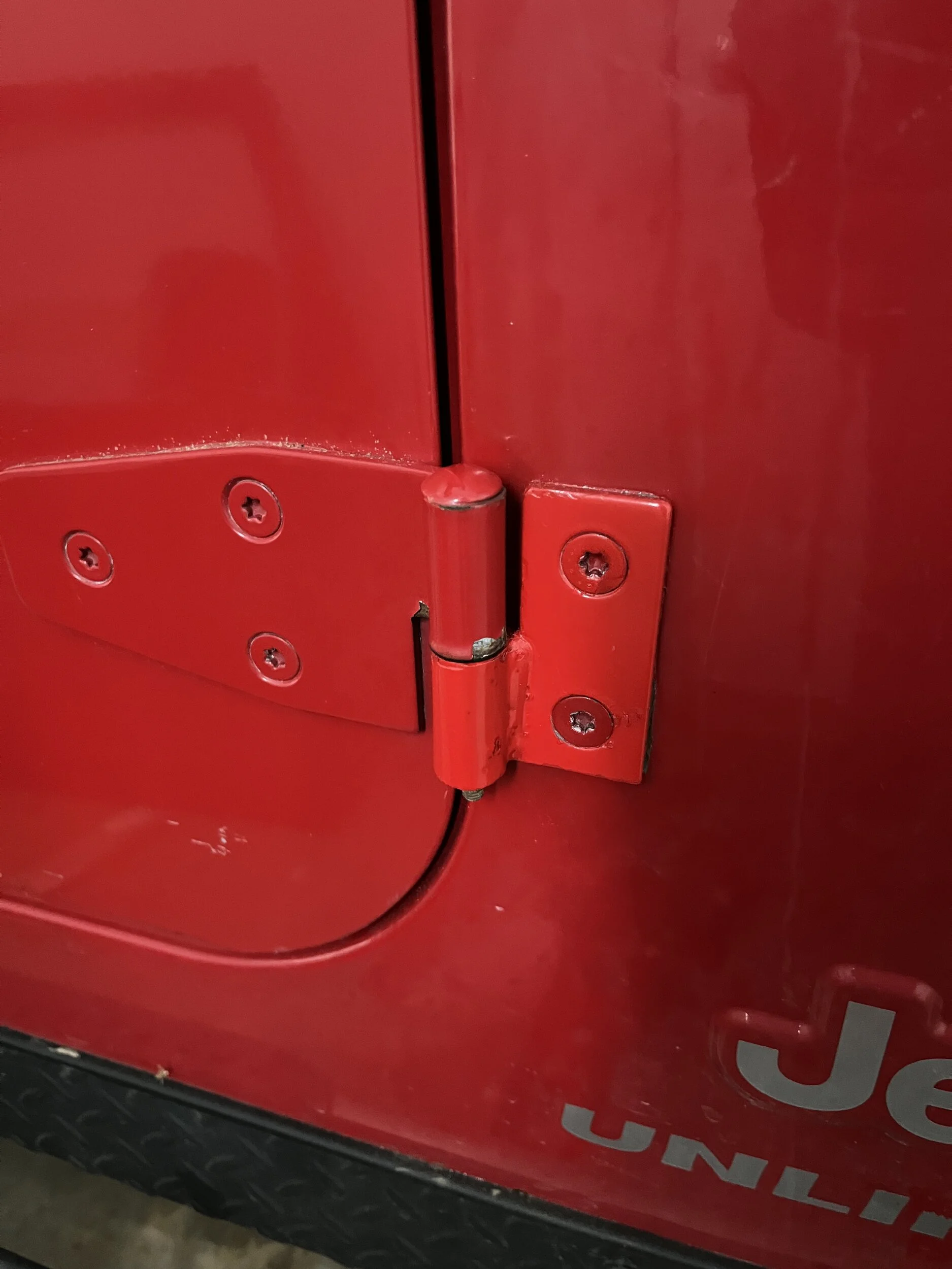

EDIT 2: Driver door done. Paint is a mismatch. I'm OK with it for now:
Oof, it looks much worse in photos.
Lots of heat and hammering got the bushings out. But I'm not done... I got the last bushing out (pass lower), but the removal tool is now so deformed that it's stuck in the hinge. Heat and hammering and this is as far as I've gotten:
The paint was in much better shape when I started. I'm displeased.
If you can get the doors off, the bushing should be removal with punches and/or cold chisels. Not familiar with that removal tool you're trying. Looks like that tool make the situation much worse by filling the hole.
More pictures and I'm sure we can recommend a path ahead. That last one looks very mangled and tough to tell recommended path forward.
If you plan to color-match the doors, at least you have a time/opportunity to repaint that hinge. For short term, color-matching spray paint would keep the rust away. Do your best to preserve the OEM hinges - the aftermarkets seem to get poor reviews.
When you get the OEM liners out, use aftermarket Delrin replacements. Many options available across the internet.
Reactions: DeltaNu1142

Thanks - the bushing removal tool is like a stepped punch that came with the Kentrol Delrin bushings that are now installed in the other three hinges. It worked, until it didn’t. Now I’m expecting to have to drill and punch it out.

Busy day. Got the bushing tool pressed out of the hinge, but I'll need to touch up the paint.

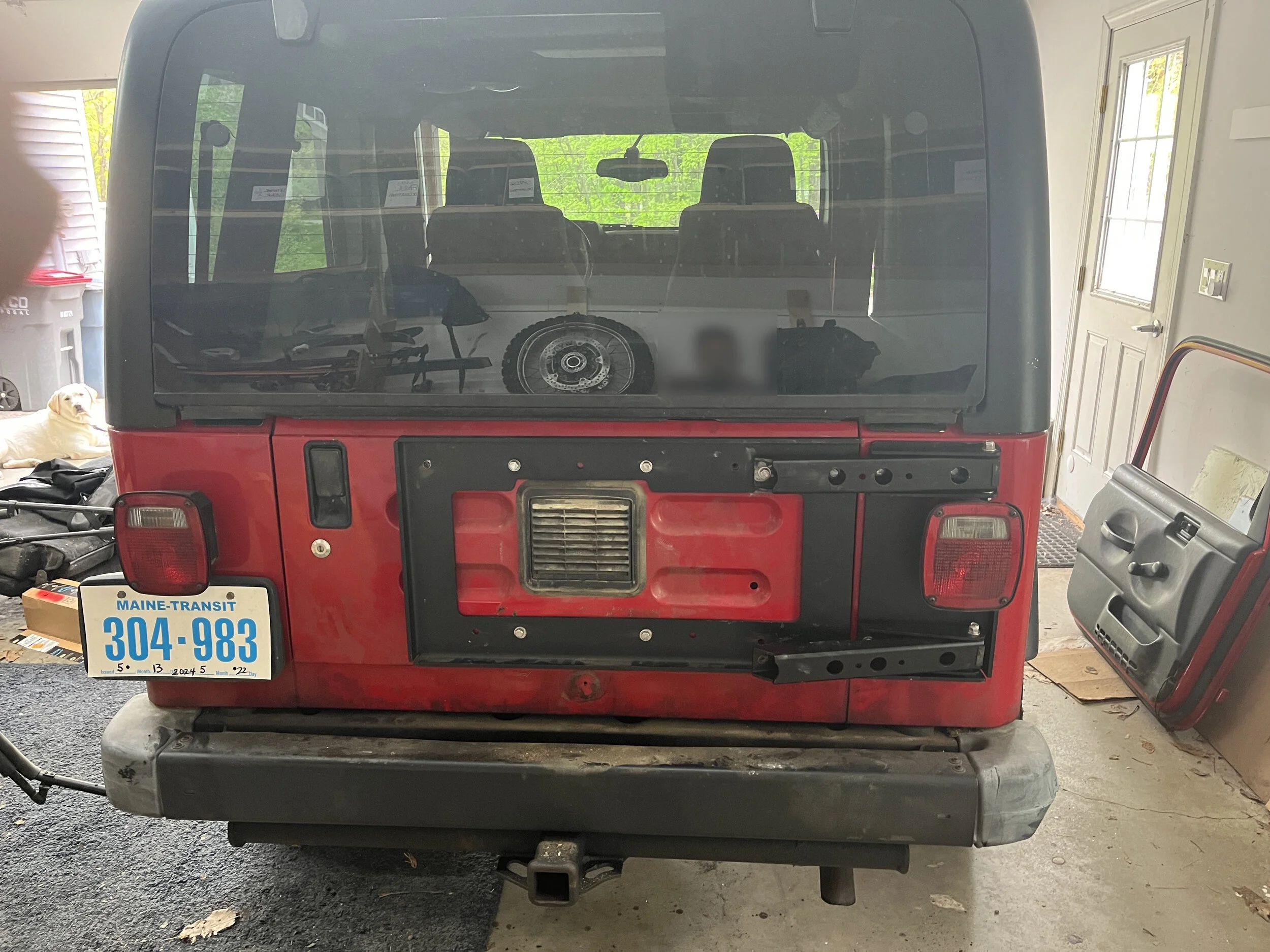

Tackled the saggy tailgate hinge by starting the MorRyde install. I bought it used, cheap, but it doesn't show any signs of ever being installed except for missing a few bolts. Those will have to come from the hardware store tomorrow.
The heat gun was the real hero today. I was heating each hinge bolt before putting the impact on it and each came out easily. I thought, "maybe I should just skip the heat," and the next couple didn't budge.

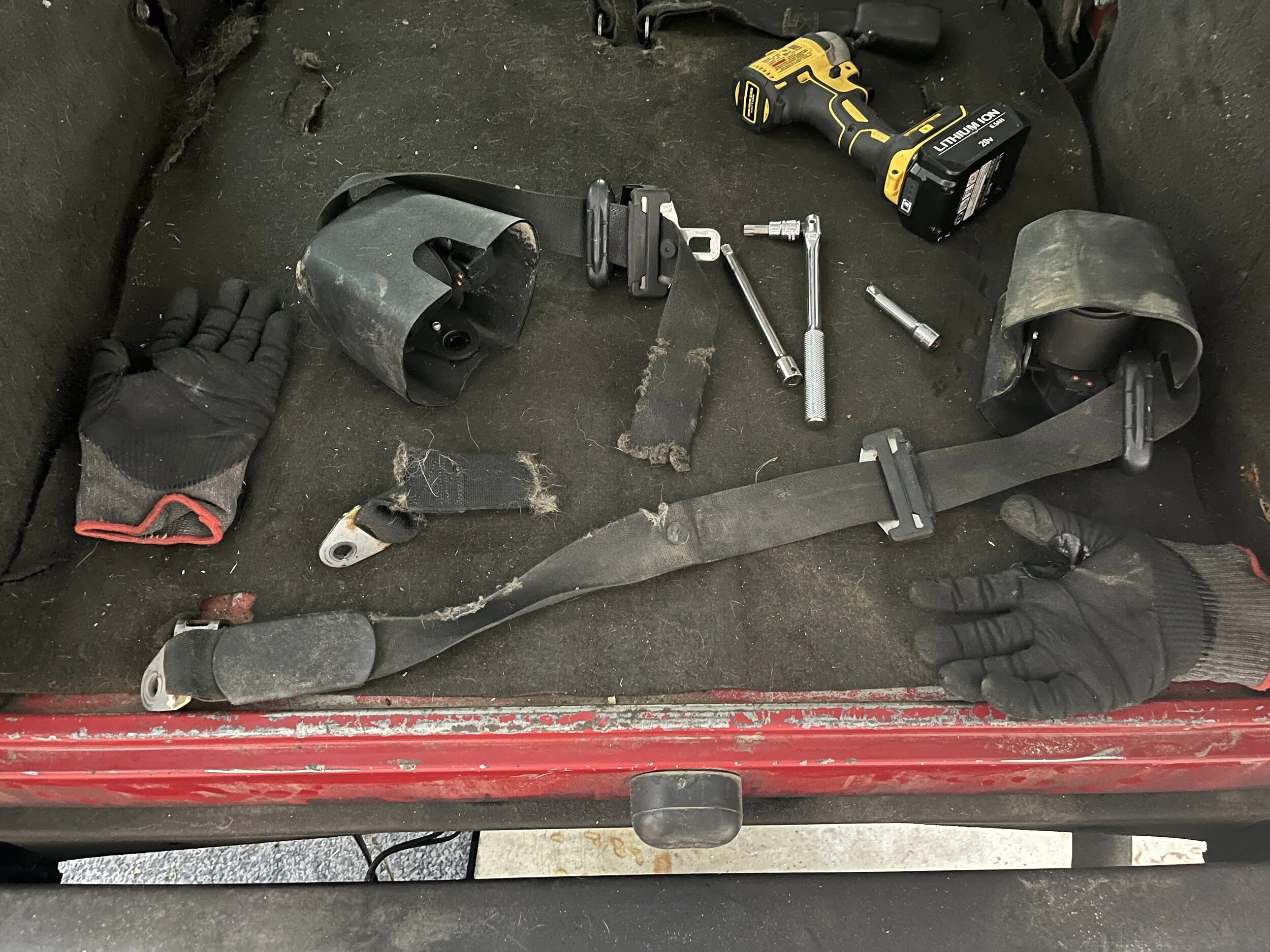

The previous owner definitely had a dog, as evidenced by the hair throughout the interior... and the rear seat belts. These are going to have to be replaced:
EDIT: the MorRyde tailgate and hinge kit included a very robust tire carrier. Looking around on the Internet, I realize it's not part of the standard kit. In fact, I don't even see anywhere that MorRyde even made a tire carrier for a TJ. I'll get a photo of it tomorrow.
Reactions: FarFire70
I discovered the spare carrier that came with my MorRyde reinforcement kit is actually a brand-new OEM carrier, but with the studs positioned for a 5x5 bolt pattern. I may or may not reposition those studs to use it. It's just so nice & clean, it'd be a shame not to install it.

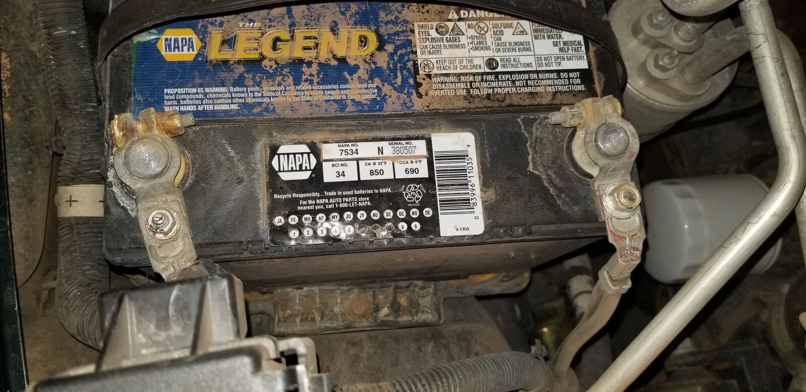

  • missing battery tie-down
For wiper blades, I'm going to order the PIAAs. For the fog lights, I need to find my security Torx bits... I know they're around here somewhere. But for the battery tie-down... I don't even see any holes in the tray to accept the hooks. I'll need to do some research and a fix before the state will bless my vehicle with a sticker. Worst case, I think nylon webbing wrapped around the tray and battery would work.

55136959AC
Nice, found it. And I see how it mounts in this thread. However... I don't like it. I prefer the J-bolts. I'd like to modify mine for J-bolts if possible.
Should go in like this one I found a random photo of
Yeah, that's from the thread above. I don't like it, at all... it doesn't seem effective in the least. I don't see a hole for it, and I don't think there's room for it:
I think I'm going to have to pull the battery and have a look.
It’s tight in there for sure.
You’ll have to pull the tray to modify it for J hooks … and that means hunting down replacement clip-nuts for the tray! I’ll be interested to see how it goes. I had big aspirations to replace mine too but ended up just popping in a new OEM tie-down “block”. Good luck!
Your battery doesn't look like it's sitting correctly. You can see the area where the wedge goes but the battery should be pushed rearward.
