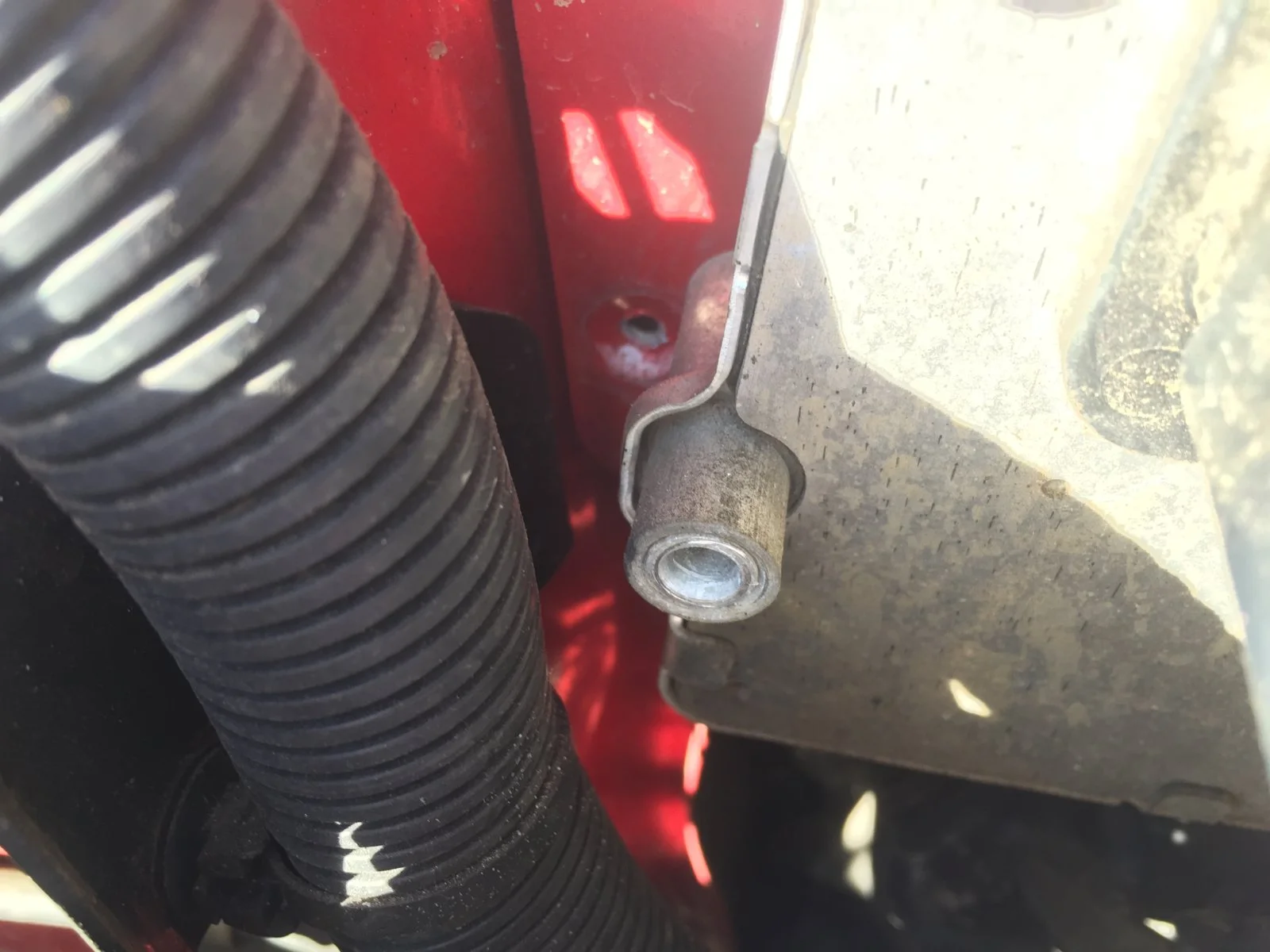

Fixed my stalling issue (fingers crossed) and have probably installed new cats and 02 sensors for nothing. Although that's another item I now don't have to worry about.
Turns out it was a ECU grounding issue, found a bit of corrosion on the mounts, removed that and Jeep is back to normal operation.

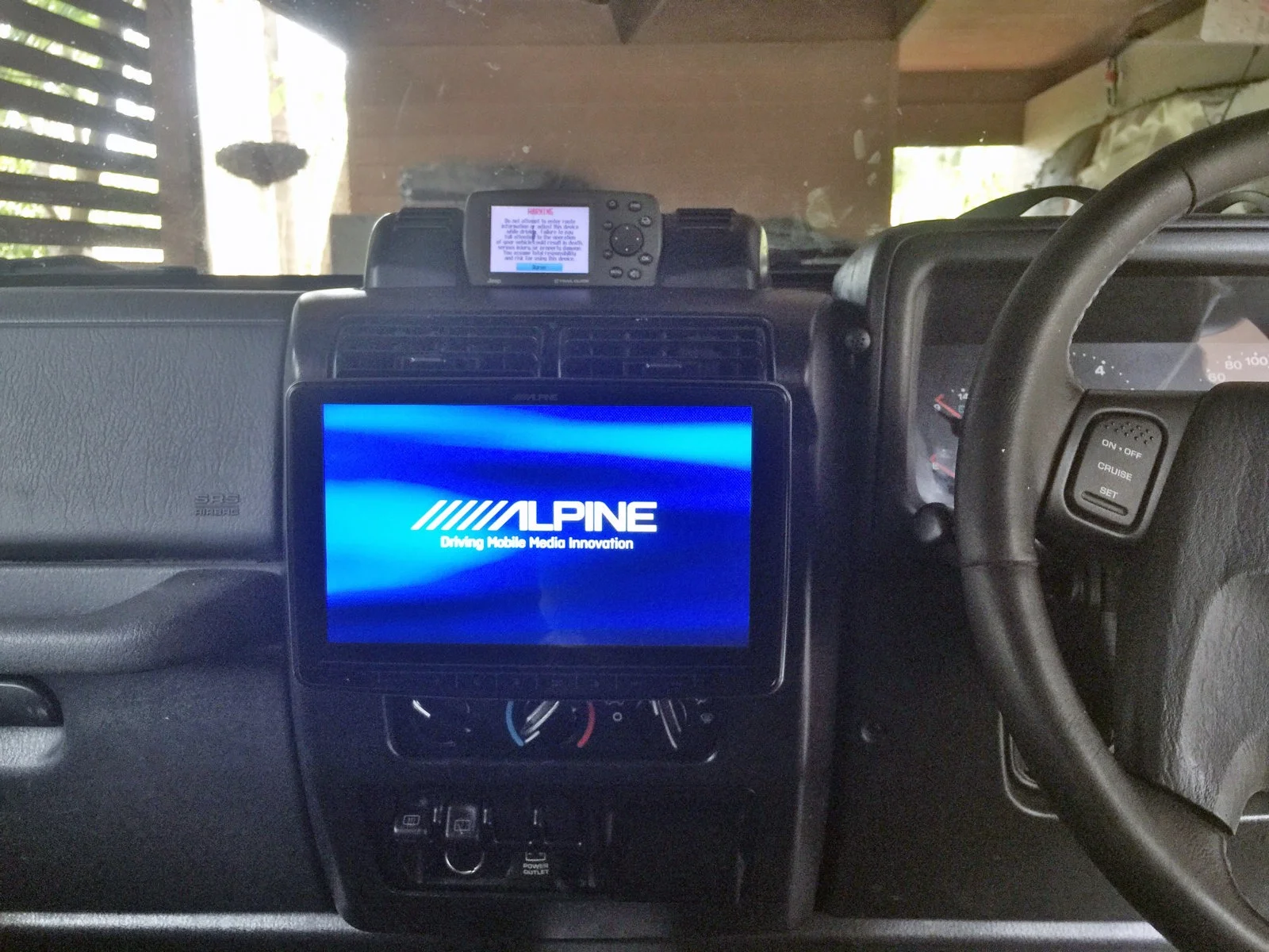

I am but further down the build path. Have had an issue with the head unit not liking the Apple connector that combines a hdmi and usb into a single iPhone connection as per the Alpine manual. Apple CarPlay is good however.
