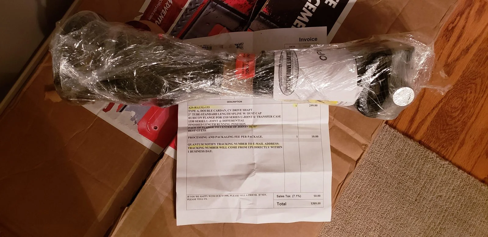

  • Tom Wood Double CV Shaft

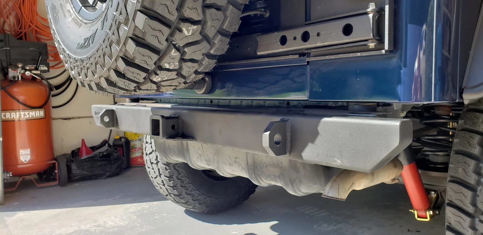

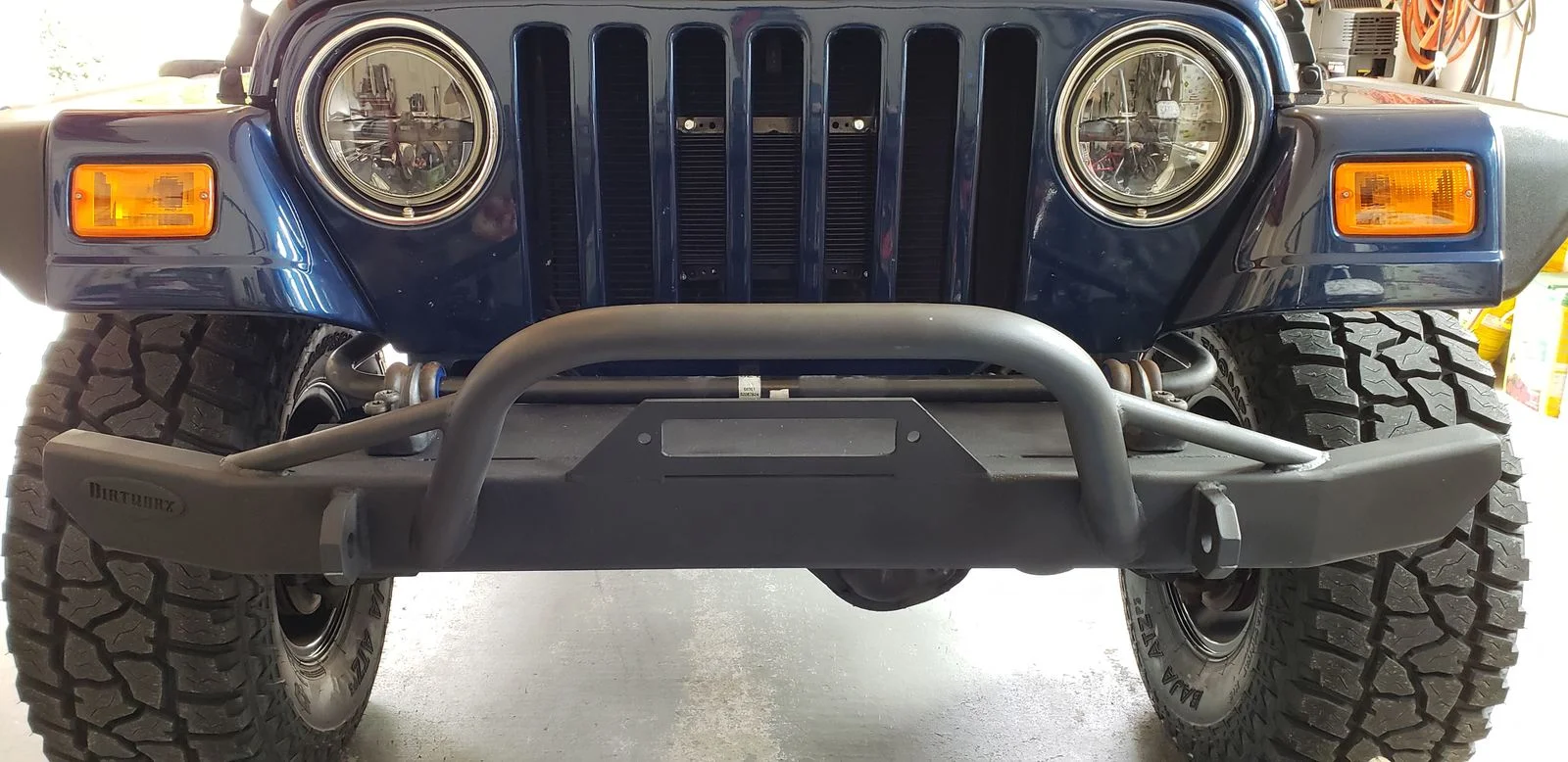

  • Dirtworx Front w/ Winch plate and Rear Bumpers

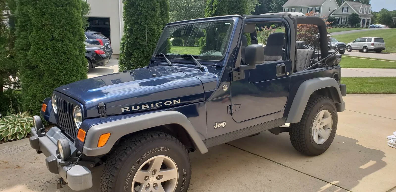

Stock
TW Shaft

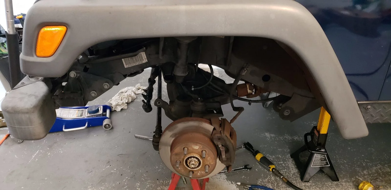

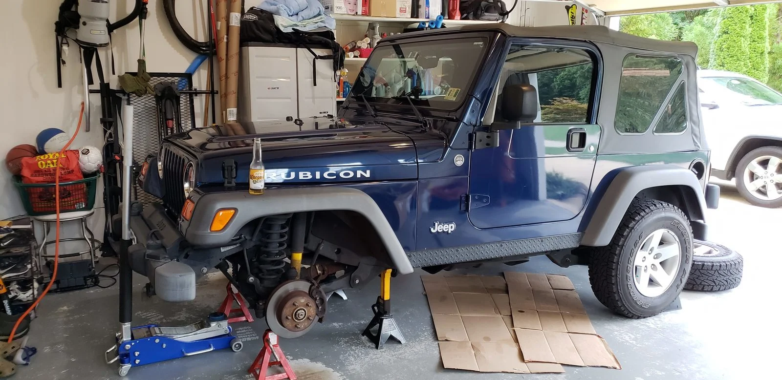

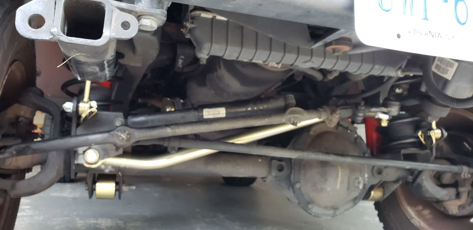

Started on Lift Install. Wasnt too bad since there wasnt any rust. Drilling coil spring perch sucked.
Front End installed

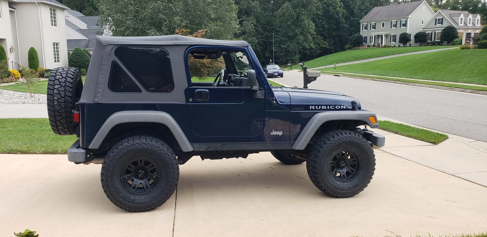

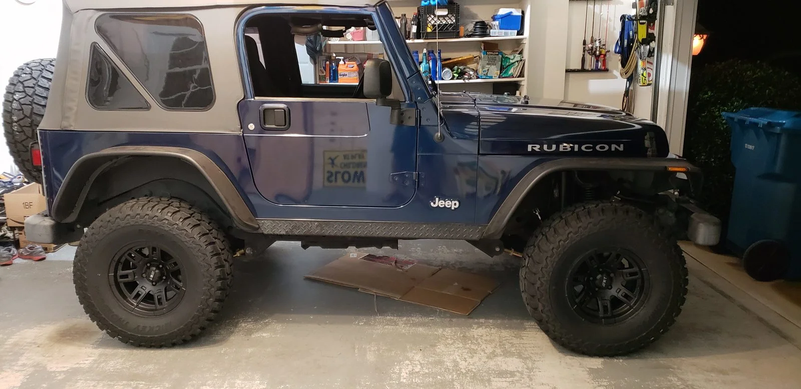

Lift, Wheels, Tires and Drive Shaft
With Flat Fenders

Wow. Super clean build! I was thinking about getting the same lift for my tjr. How do you like it?
Thanks. I dont have another lift kit to compare it with but so far on the road, its nice. Install wasn't too bad. Hardest part was drilling the coil spring perches for the bump stop kit. Everything else was pretty much bolt on. Adjusting pinon angles, alignments etc.. took sometime to get dialed in.

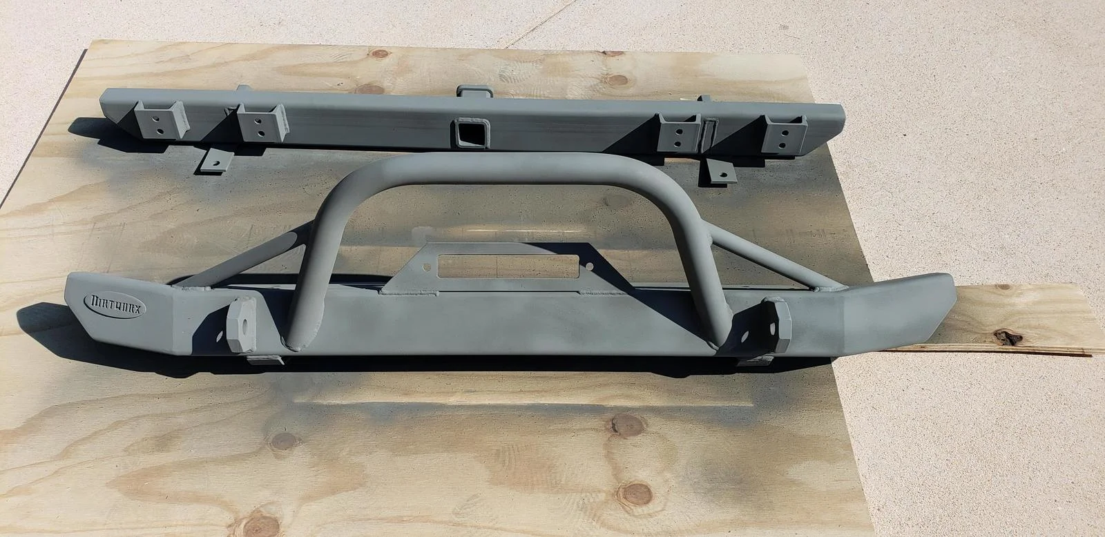

Are you me? :) I just placed an order for Dirtworx bumpers front and back yesterday! Good choice :D
Awesome. I'm not usually a fan of stinger type bumpers but the Dirtworx is done in a nice way. Got the integrated winch plate built as well. Hopefully done painting this week for mounting.
I ordered the fronts plain like the back, without the hoop. Do let us know how you like the bumpers. I am hoping I can get them primed and painted in my garage weather permitting.
I didn't think about ordering the front without the loop. That should be pretty cool.
