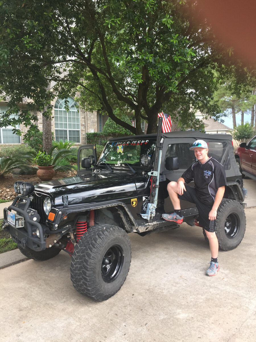

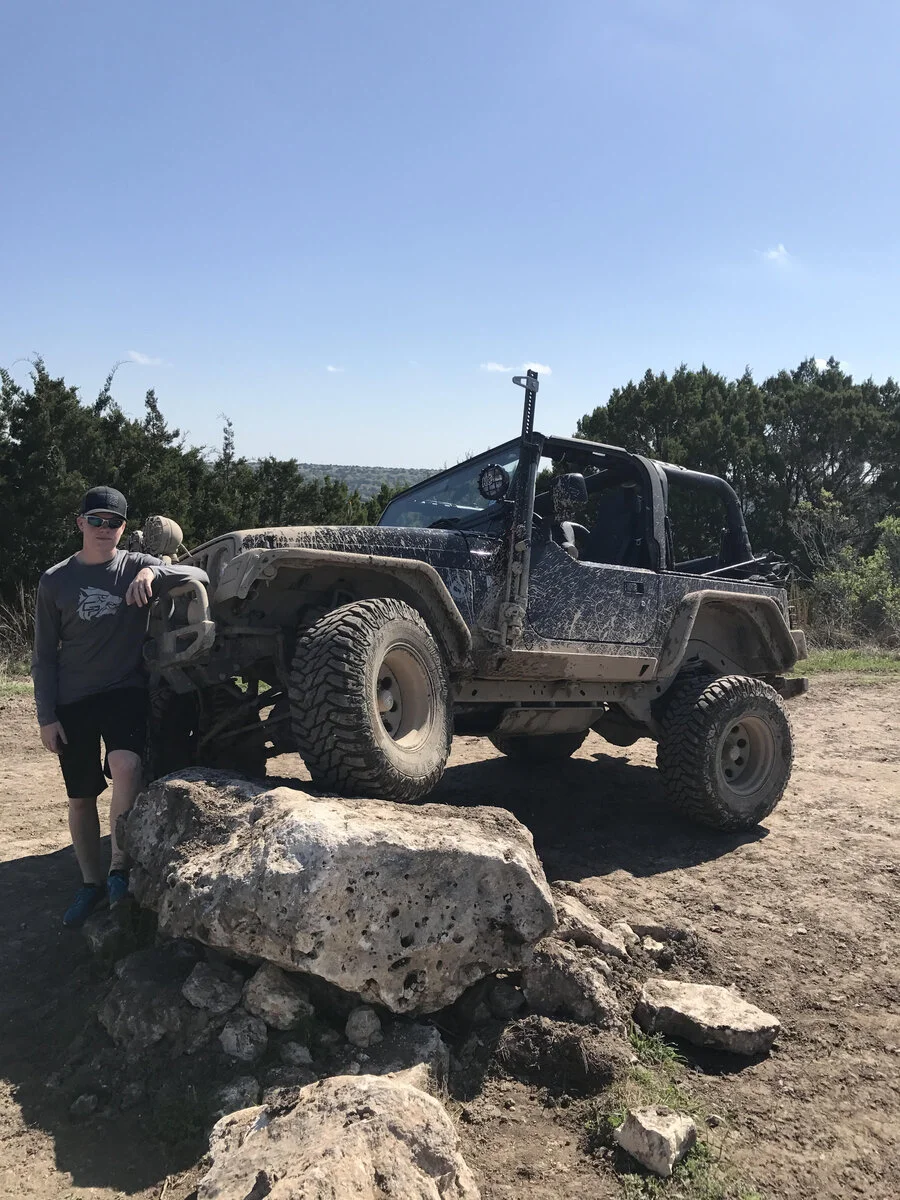

Just signed up to support and it suggested posting what I've got.
I'm in Cedar Park, TX outside of Austin in the Hill Country. My name is Jason, 48 years old. My first jeep was a CJ5 with a 4" lift, 304 V8 and 35" BFG's I bought in 1991 in college. I'm still sad I sold it when I got married after college to get a stupid Ford Explorer for work, ha. I went 2 full years with no top at all in that old girl, and loved every minute.
May 2016 I bought my oldest son a 2005 TJ with a 3.5" Rancho Lift 4.0 straight six with a 6 speed manual transmission. He just turned 15, so I got to drive it a ton for about a year until he turned 16....and this month he asked to take my truck back to Texas Tech, and I'm getting a TJ as a full time driver for a little while, and I'm never, ever selling it. Got it from a guy deploying to Afghanistan that wanted a 4 door when he got back....I should have known......it looked cool but was "Heavily Used" ha.
Day 1
When we got it, had 4.11 gears, ACT racing clutch (stiffest clutch I've ever used) 3.5" short arm Rancho lift, Flowmaster super 40 exhaust, 9000 LB Smittybuilt XRC wench, Smittybuilt front and back bumpers, Warrior steel tube fender flares, JCR Rock sliders, 6 KC Lights (old school not LED), 50" farm jack mounted, Ok Top, Bestop Half Bikini brand new, BT Windscreen, and Deck Cover all new and a Rooftop rack assembly.

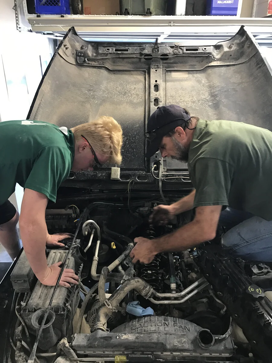

I took him out to Hidden Hills Adventure Park in Marble Falls to start teaching him four wheeling. Rock Climbing was fun, but mud pits are always a hit.....and through experience you learn the cleanup in the engine bay is not always worth it, I'd rather rock climb, ha.

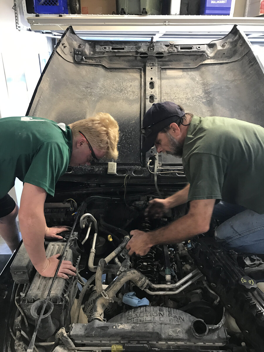

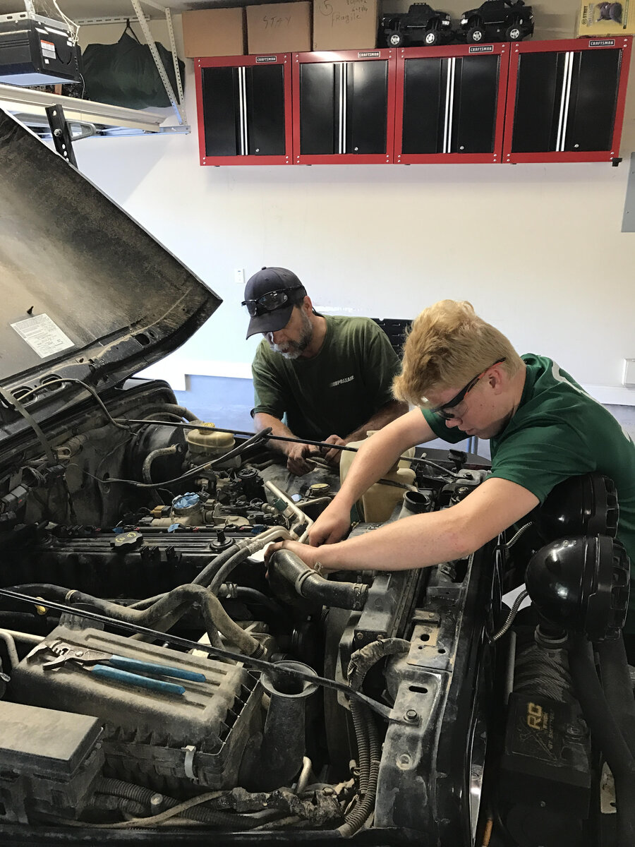

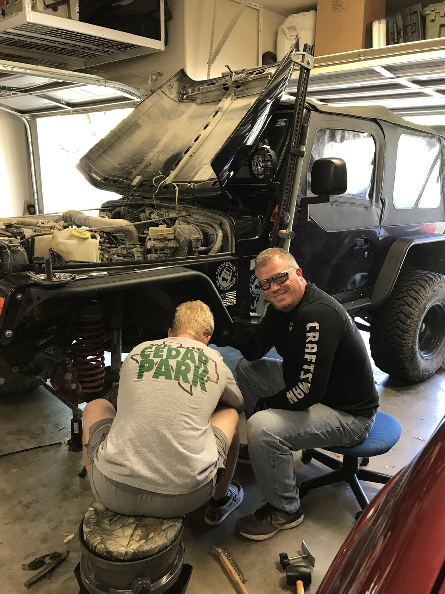

Then we went to work, with help from my brother who's been a mechanic since about 1982, and did a lot with 4 wheel drives at Off Road Unlimited building custom rigs in Houston, and a lot of huge oil field 4x4 Custom F150's that were shipped all over the world, crazy remote places like Siberia. I found this site looking because he said "We need to find some Jeep TJ guys that have experience with the little details that work on this Jeep."
We went to work:
Replaced the front bumper so it would have a quick attach tow bar.
Replaced Valve Cover gasket to fix 1 leak, the oil pan gasket to fix another, and then the rear main seal to fix the 3rd......it's bone dry for the past 3 years.
Put new pads on the roll bars, seat covers, new speakers and stereo with bluetooth to play music easier. Broke a rear axle and put in https://www.revolutiongear.com/prod..._tj_yj_and_93_98_zj_rear_axle_revolution_gear these revolution rear axles. That I actually had done, and I cannot remember if they took out the locker that was in the Dana 35, broke it backing out after baseball practice, just don't want to deal with lockers right now. Put on new front sway bar disconnects after we pulled the ball joint out having fun. Synchros went bad and last weekend just pulled the NSG370 transmission and took it to get a bench rebuild. Putting in a new LuK clutch, the ACT clutch was pretty worn. Just put in a rebuilt transfer case and front axle (it decided to drop out while towing it home from Texas Tech. Back when I towed my CJ I disconnected the axles....just in case....I know that's not necessary anymore, but I should have, ha. It was a one day 10 1/2 hour round trip to get out of the dorm quick during this COVID stuff, so I didn't even think to get under and check the u joints just in case, and of course. And new brakes last summer before heading to college. Also a new Quadratec top with the tinted windows for heat in Texas. I've got the new shift boot assembly coming to put in as well to cut some heat and noise.

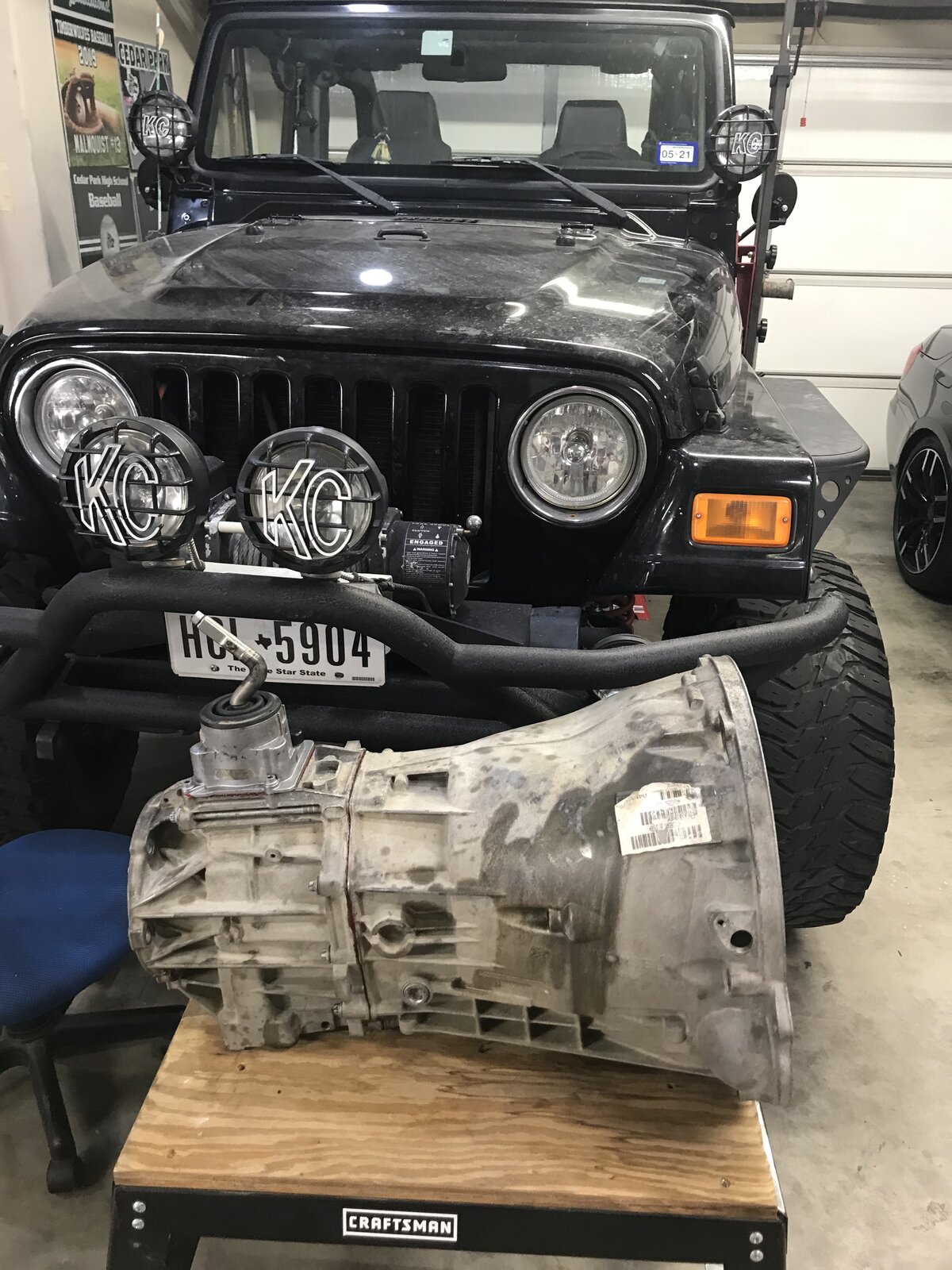

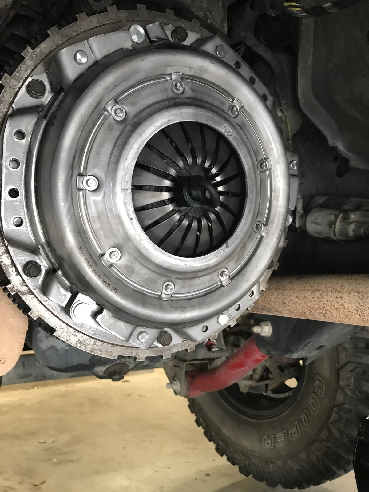

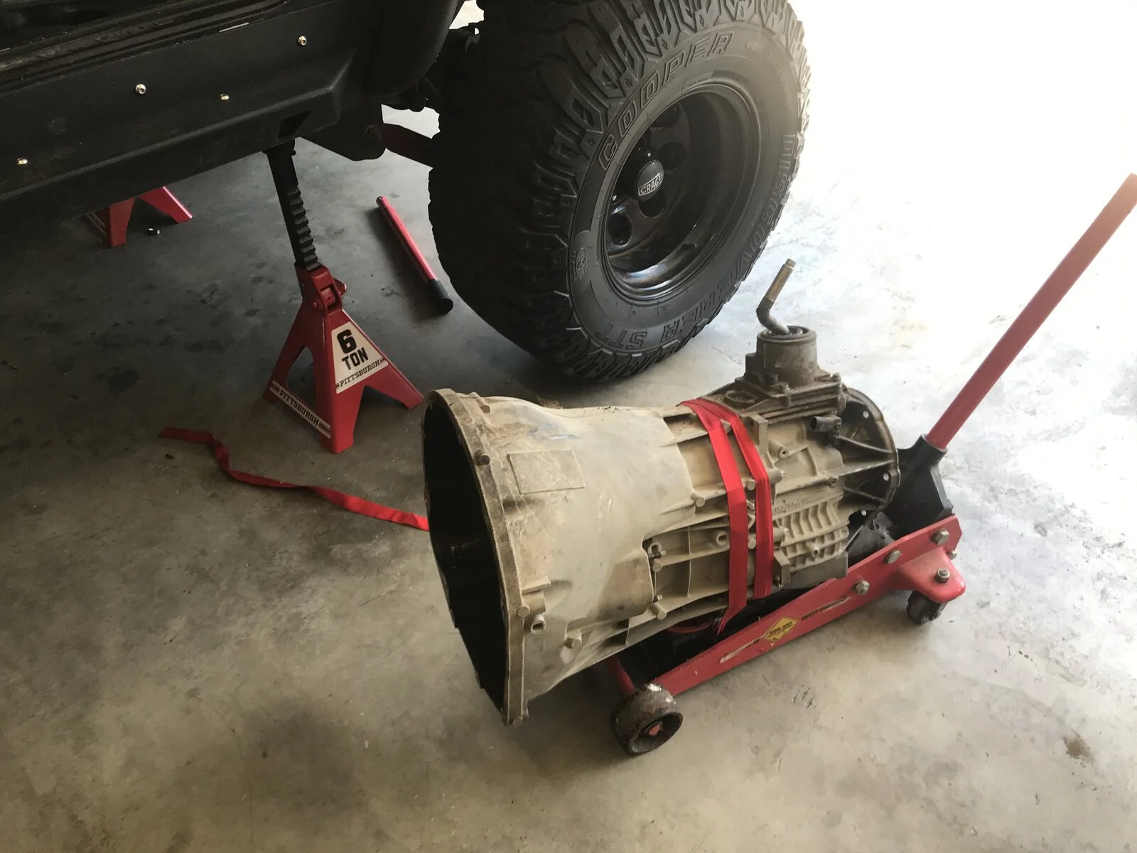

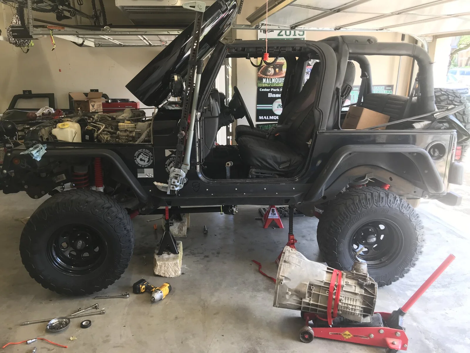

Well, parts for the NSG370 take time!
getting a full rebuild with upgrade synchros. Had to replace all of them, I’m really suspicious that someone put GL5 in there. Trans shop is legit here, talked to him and he said they and the sliders were jacked, and needed a new input shaft (I’ll be saving the old one as a clutch alignment tool, even though kits come with them).
Pilot bearing in, getting the flywheel on and clutch in and waiting for transmission. Put in rear u joints as well (front are 2 months old).
Friday he called and said the input shaft is 1/4” too long, got the wrong one,he’ll get the part Monday?! Argh, it happens, but I was ready to get this done.

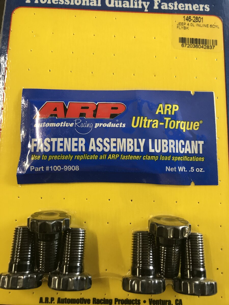

Got the ARP bolts, they come with lubricant.
*Got distracted on t 2008, gonna do a quick change in that NSG370 to Redline MTL, last owner used vice grips on the plug, chewed up threads and dealer said 5 days to get it, argh. I’ll put the old one in, threads are chewed on the end, but I’d rather replace it. Oh, and ordered the MTL on Amazon, and showed up 80% gone, box was solid oil, felt bad for the delivery guy.
2E72058B-77AE-4089-9FE8-5EE1A00A16D4.jpeg0D0EDD16-302D-43DB-A1AD-040DA9A976A1.jpeg2501FF88-9C75-4234-BD99-7EA36F8B8284.jpeg1692B73C-1A28-4787-BEFF-24A5AA62A9D0.jpeg3CD4AA8D-A397-4101-971A-2D44656C2A35.jpeg
Back to the 05, I also got the shifting boot to cut down on sound and heat in the cabin, at least it’s something to accomplish while waiting on the transmission.
Also spent time on two issues, and it’ll just make people flame, but loctite. I’m putting blue on flywheel bolts and pressure plate bolts. Lot of very experienced folks saying red is ok for pressure plate bolts. I build firearms as a hobby, I hate Red. Ugh, it’s caused some serious cursing, and I just can’t bring myself to put it on anything that may be removed ever, ha.
Also, all the 20% less torque when using thread locker Discussion (it’s a lubricant) makes for an argument. 20+ year owner of Ford Dealer, said he’s heard that over and over, and every technician at his dealership is told “use blue, and torque to the actual number” ha. Not saying right or wrong, by the technicality maybe wrong, he said he talked to an Exec at loctite group, whatever that is, and it’s debatable, ha.
Just love getting conflicting advice from very reputable folks.
I’m gonna mull it over after I visit the Bourbon cabinet my wife set up for me because our Spring Break Bourbon trail trip got Covid Cancelled , best wife ever!

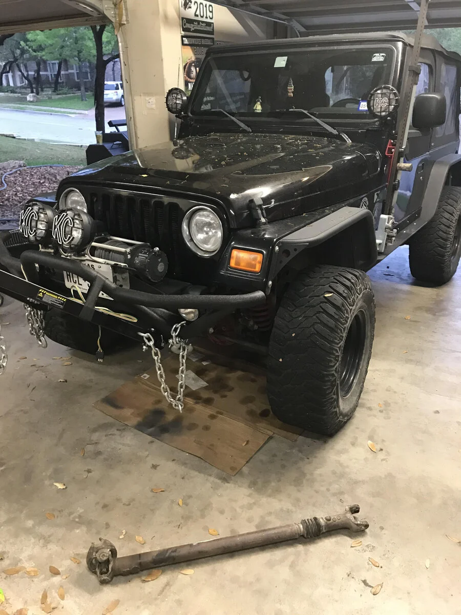

I’m gonna start updating my build thread.
I bought this for my son at 15 and he wanted to switch to a Truck after 2 years in college , and I gave him my F150 during Covid, ha., and now the TJ is all mine.
So this is what I’ve been doing, literally June 20 NSG (Covid Craxy time, although not much changed for me ha).
I got a New LUK Clutch since I pulled the 6 speed to get it rebuilt.
I pulled the flywheel. Mistake!!! Got new bolts and put it back on, you can’t get it turned or shouldn’t and everyone said it looked fine. So new bolts.
Oh, took it off as well, and got a new set, because I’m an idiot and didn’t put the Dust shield back on! New ARP bolts and all back on.
I did replace the e-Torx bolts on top, but frankly with good tools which I have it’s not an issue, but I replaced them with normal bolts.
Reactions: sideproject and L J

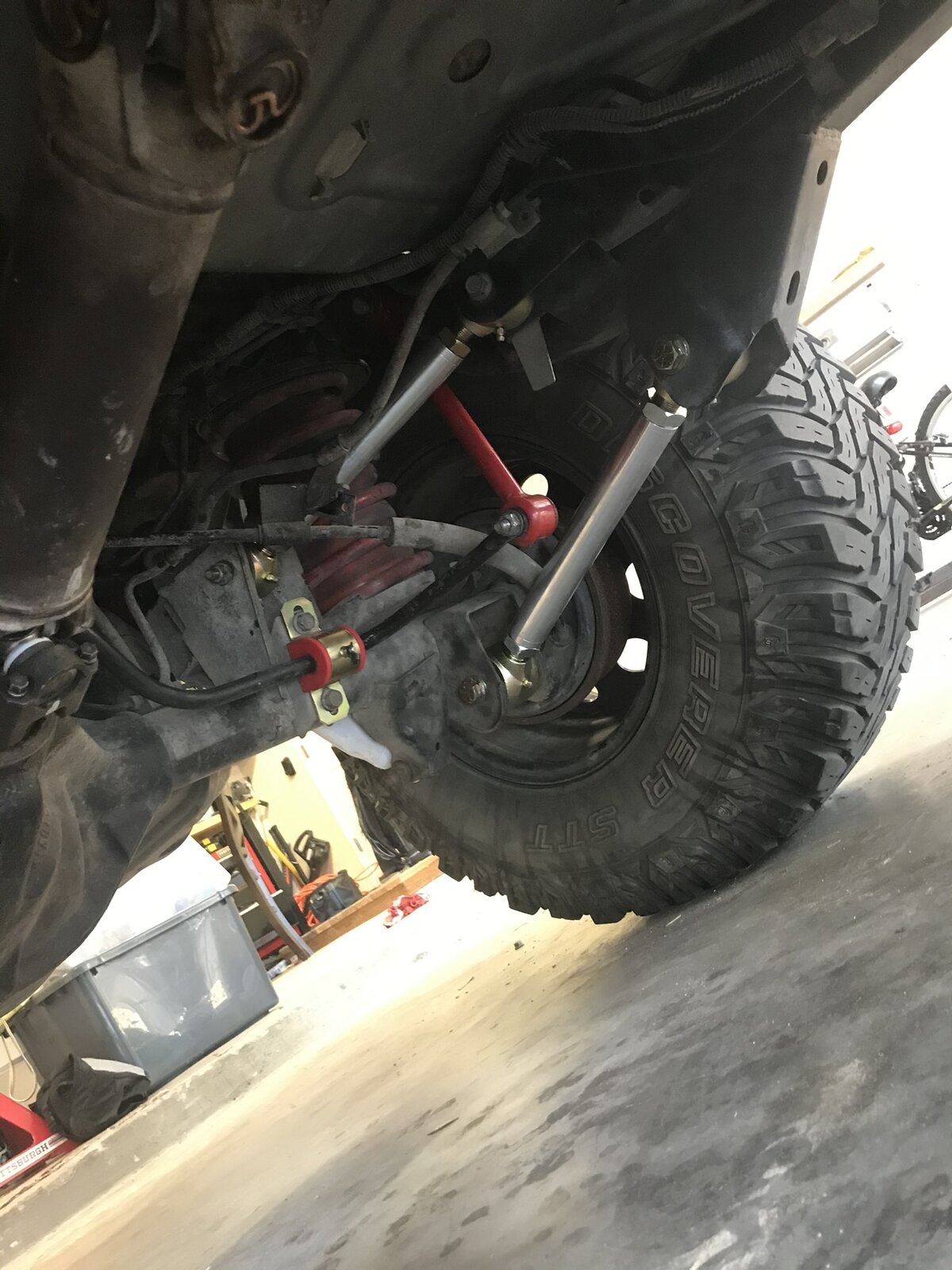

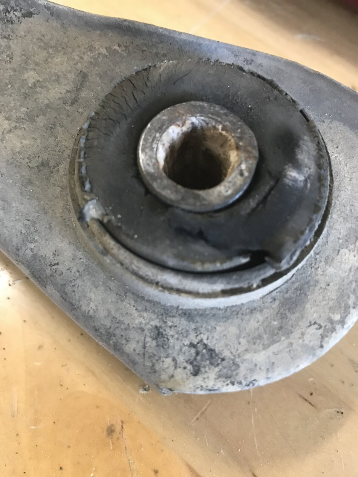

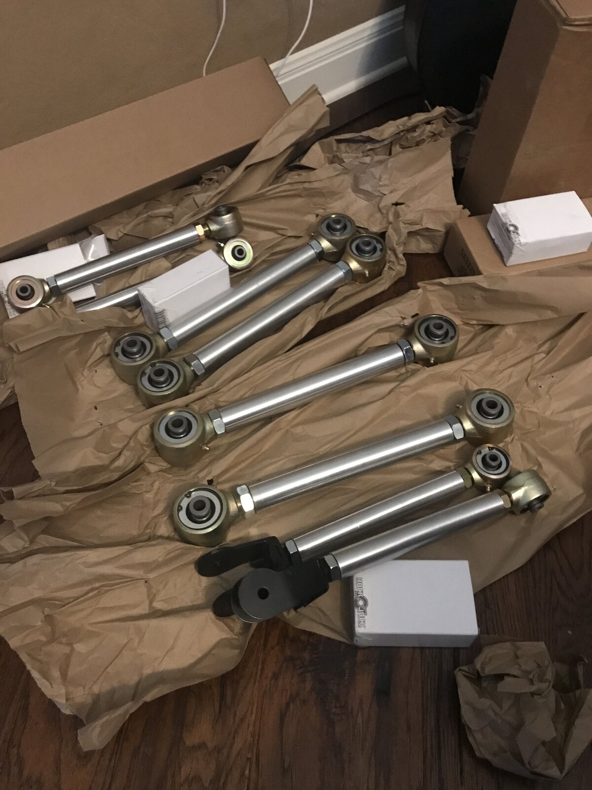

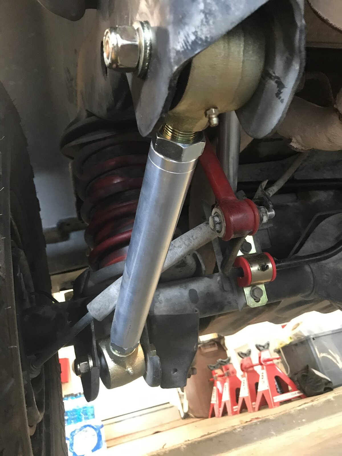

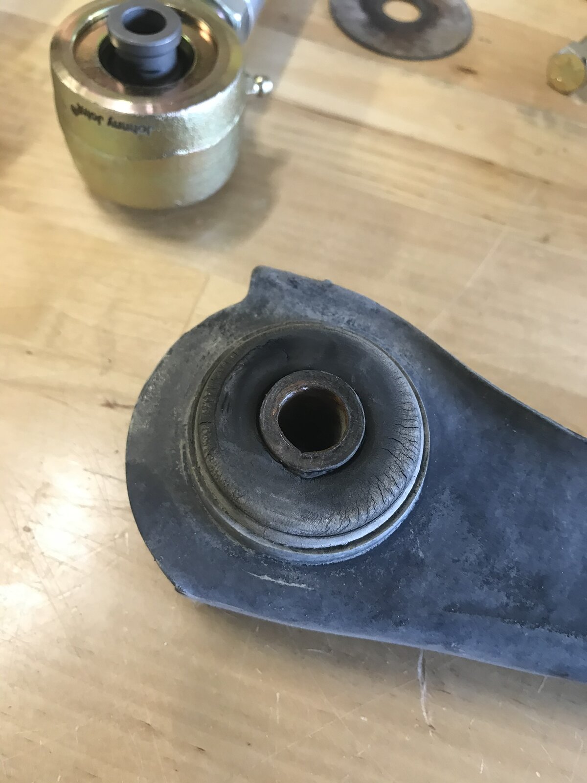

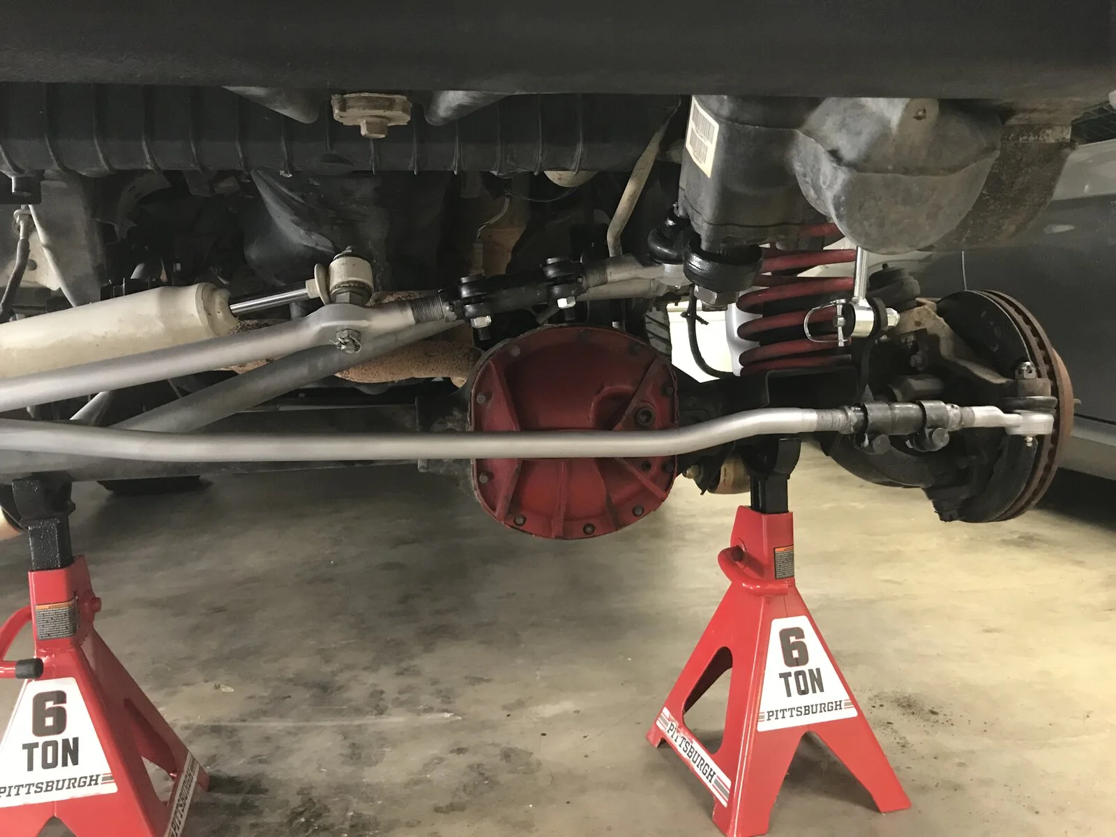

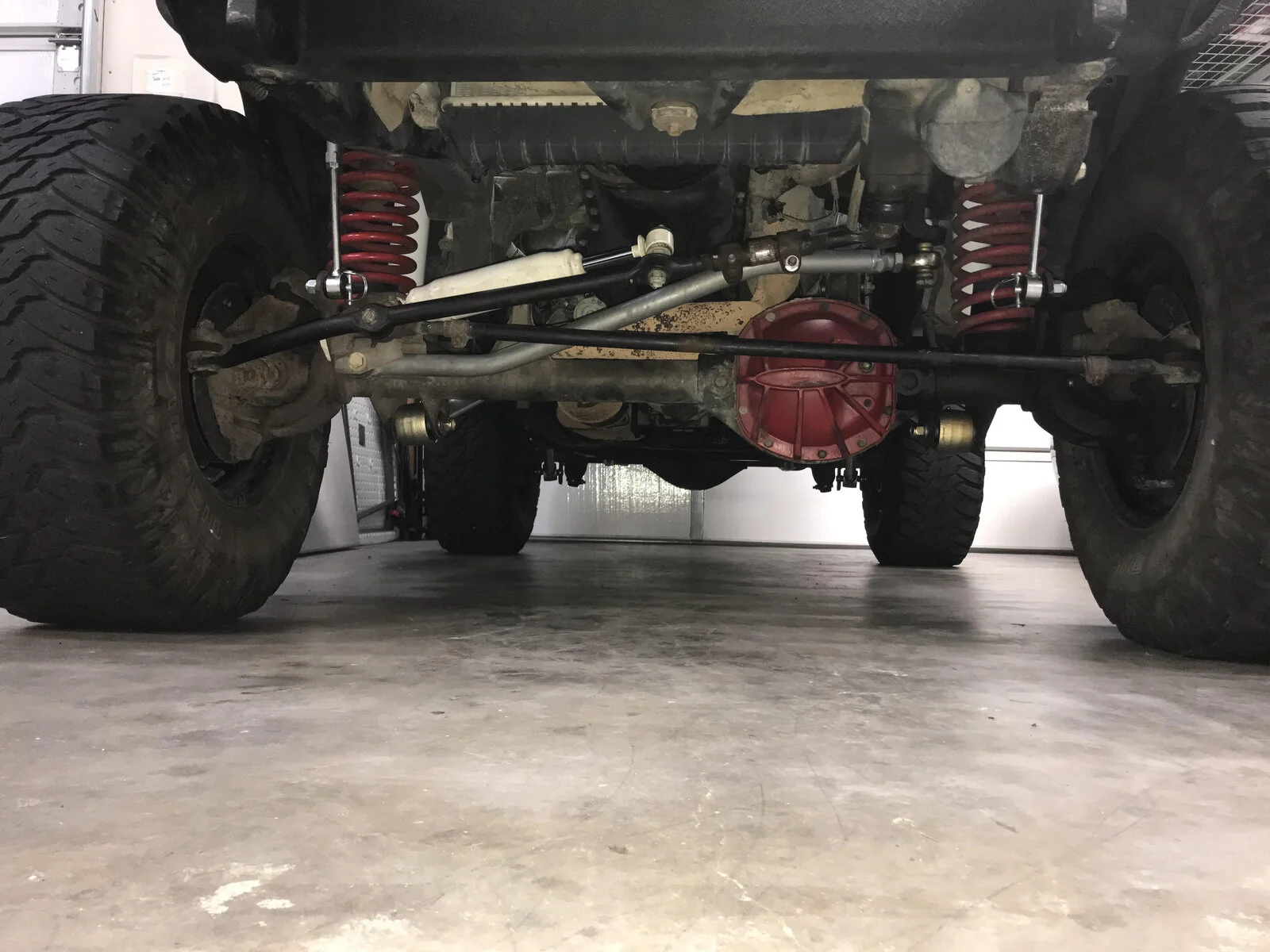

My next activity, HA, after reading a TON on this forum, was that this Jeep drove like crap. Bump steer, Shit Steer, Rear Steer....uMMMMMMMMM it did ALLL of those! Ha.

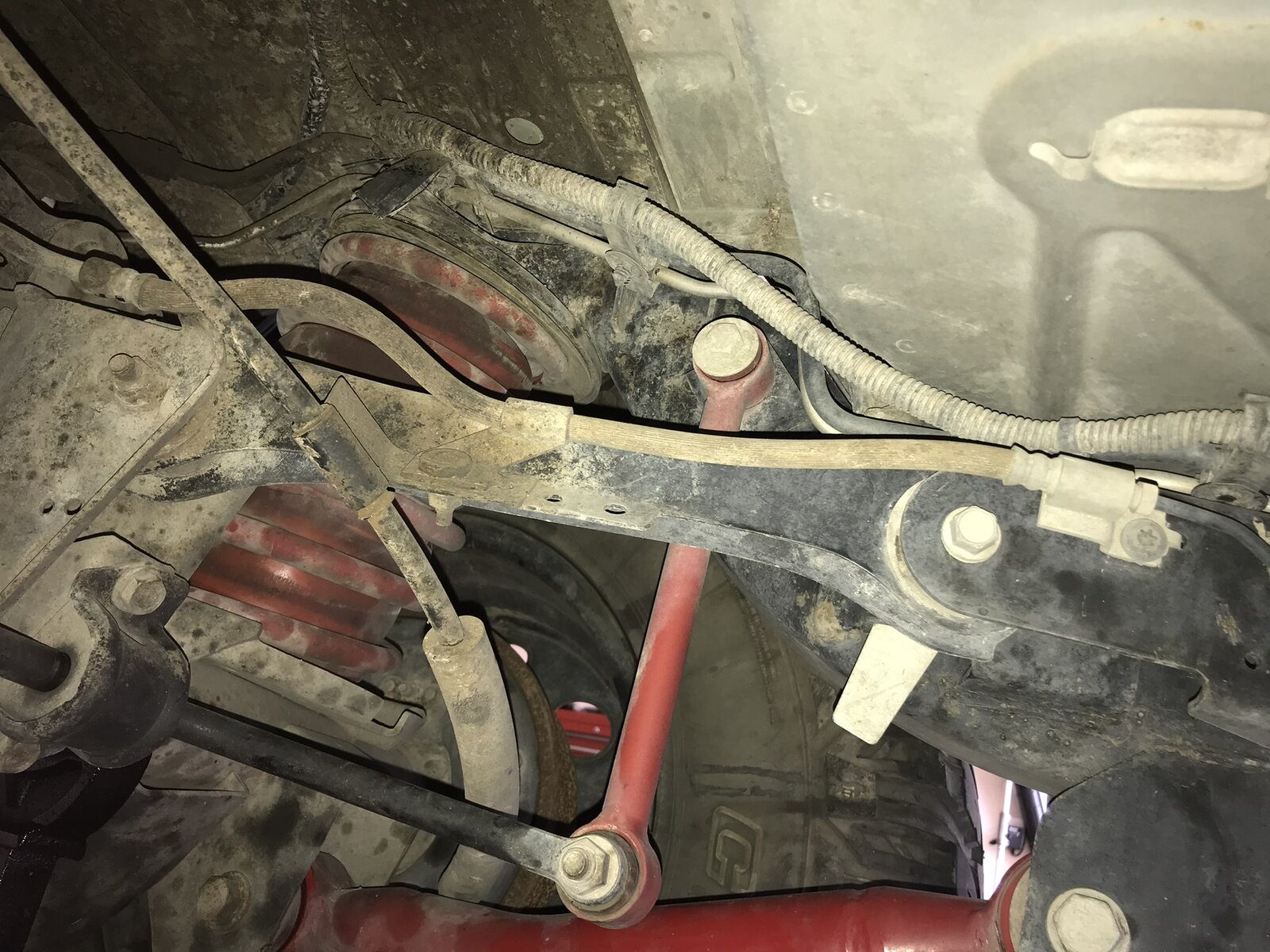

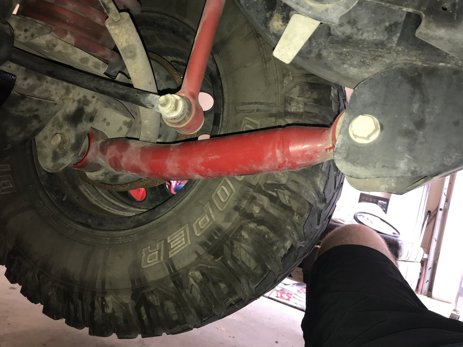

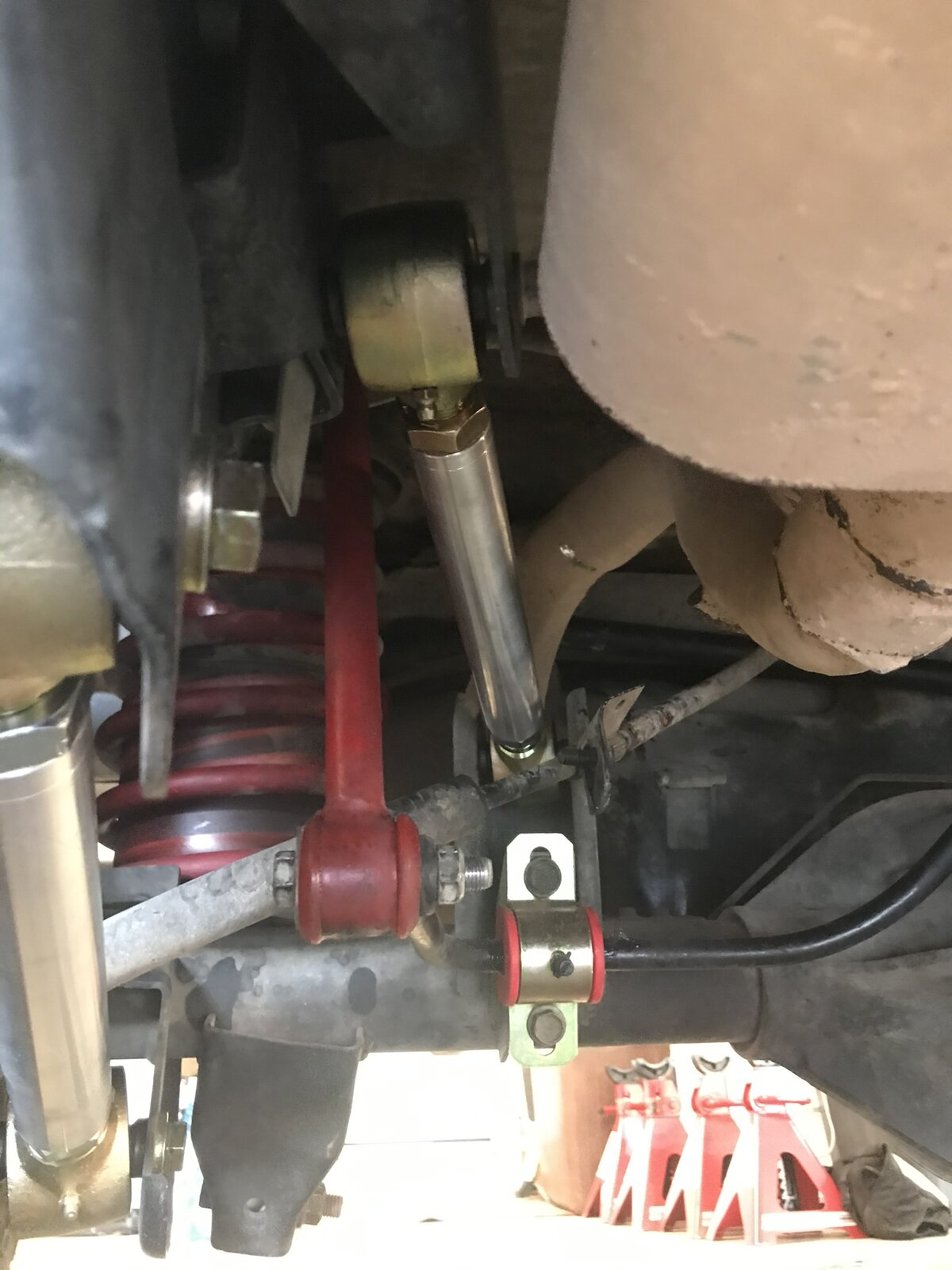

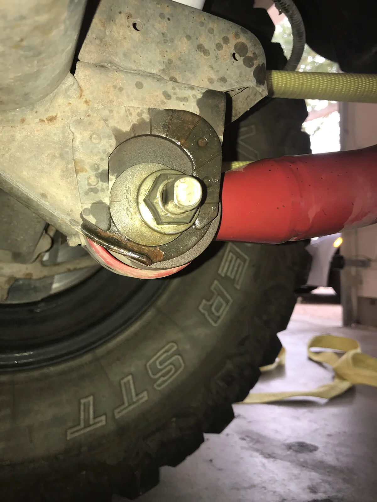

So I looked at the control arms first. They are Rancho fixed, and I got Savvy Double Adjustable control arms, I wanted the JJ's and I like the stainless look, ha.
These are the lower CA's front and Rear, solid red Rancho arms.

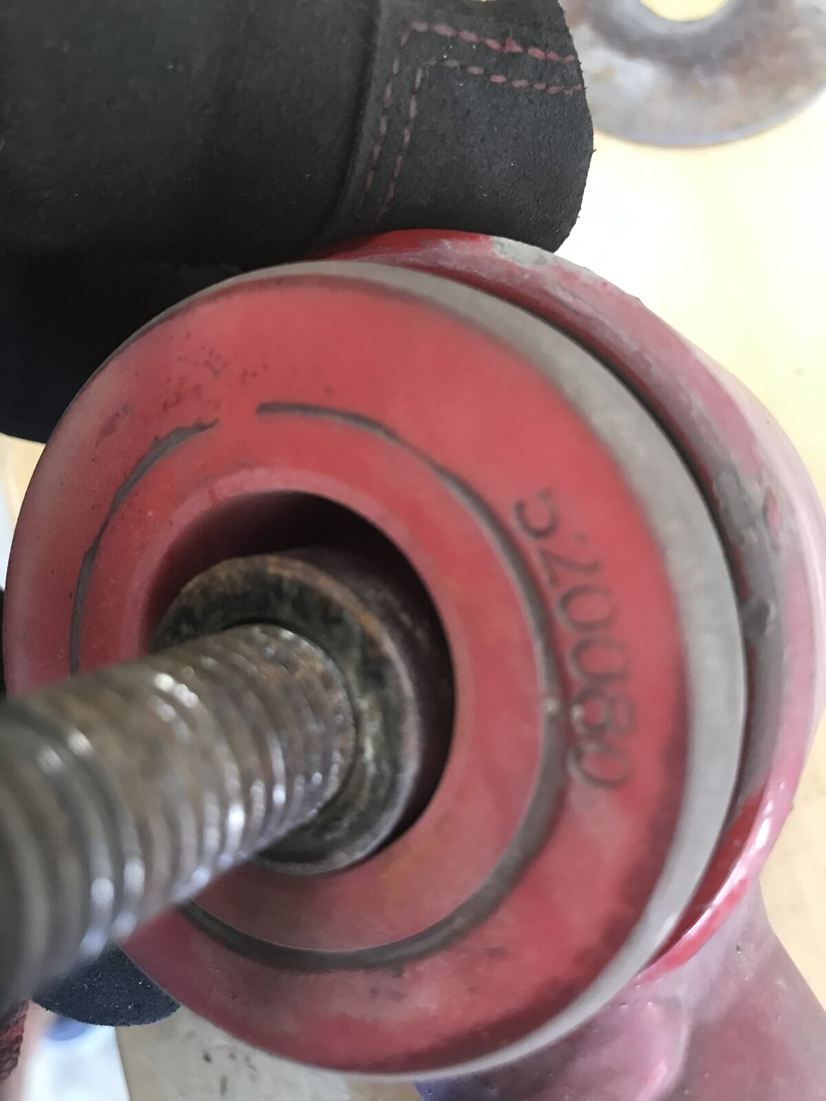

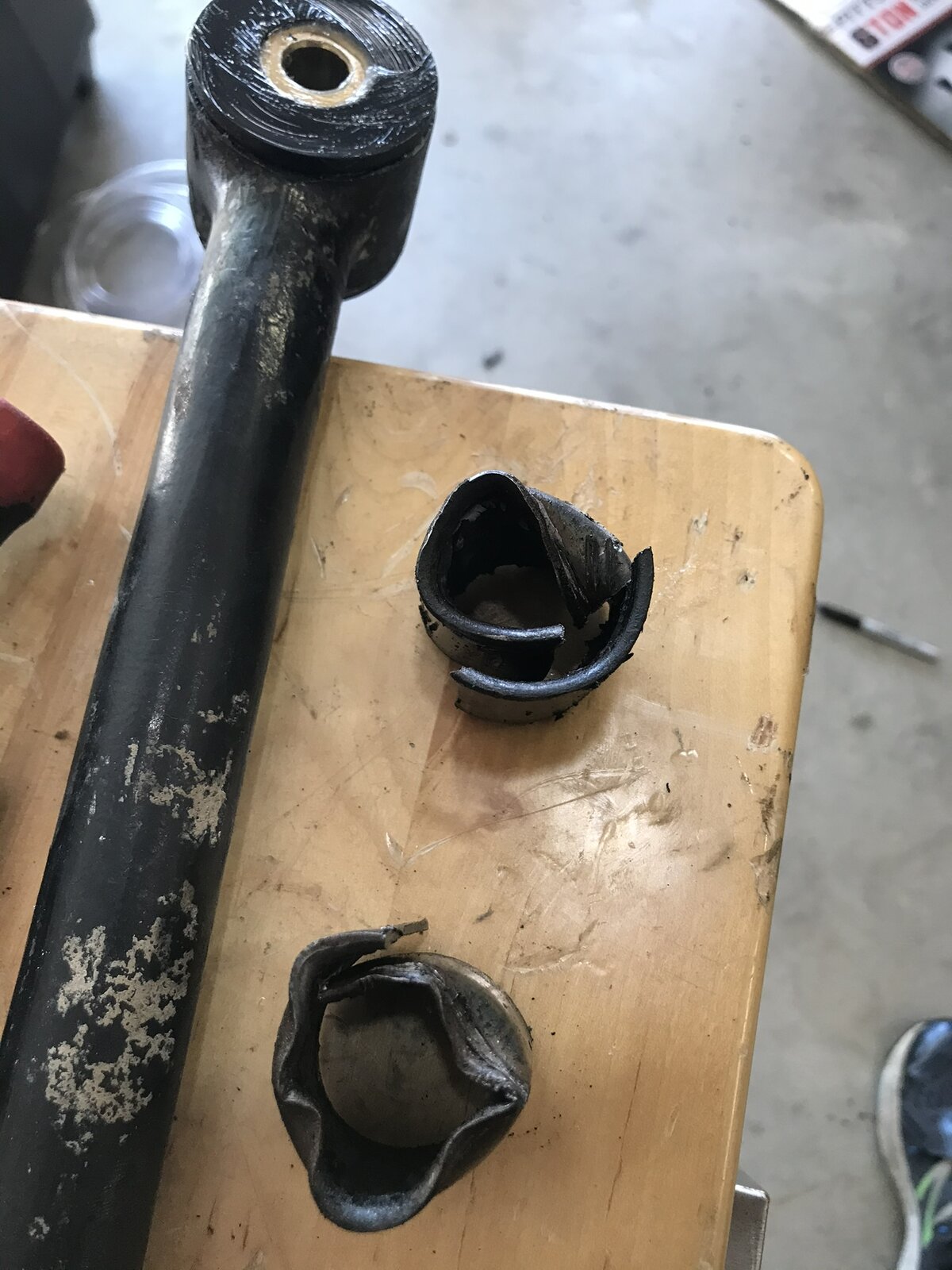

And....these are the amazing bushings....I was pretty sure they weren't supposed to be this loose. Like wicked loose, when I pressed in the clutch going from 3-4 the whole TJ felt like it was spinning under my rear end, crazy.
The uppers looked original and were toast as well.

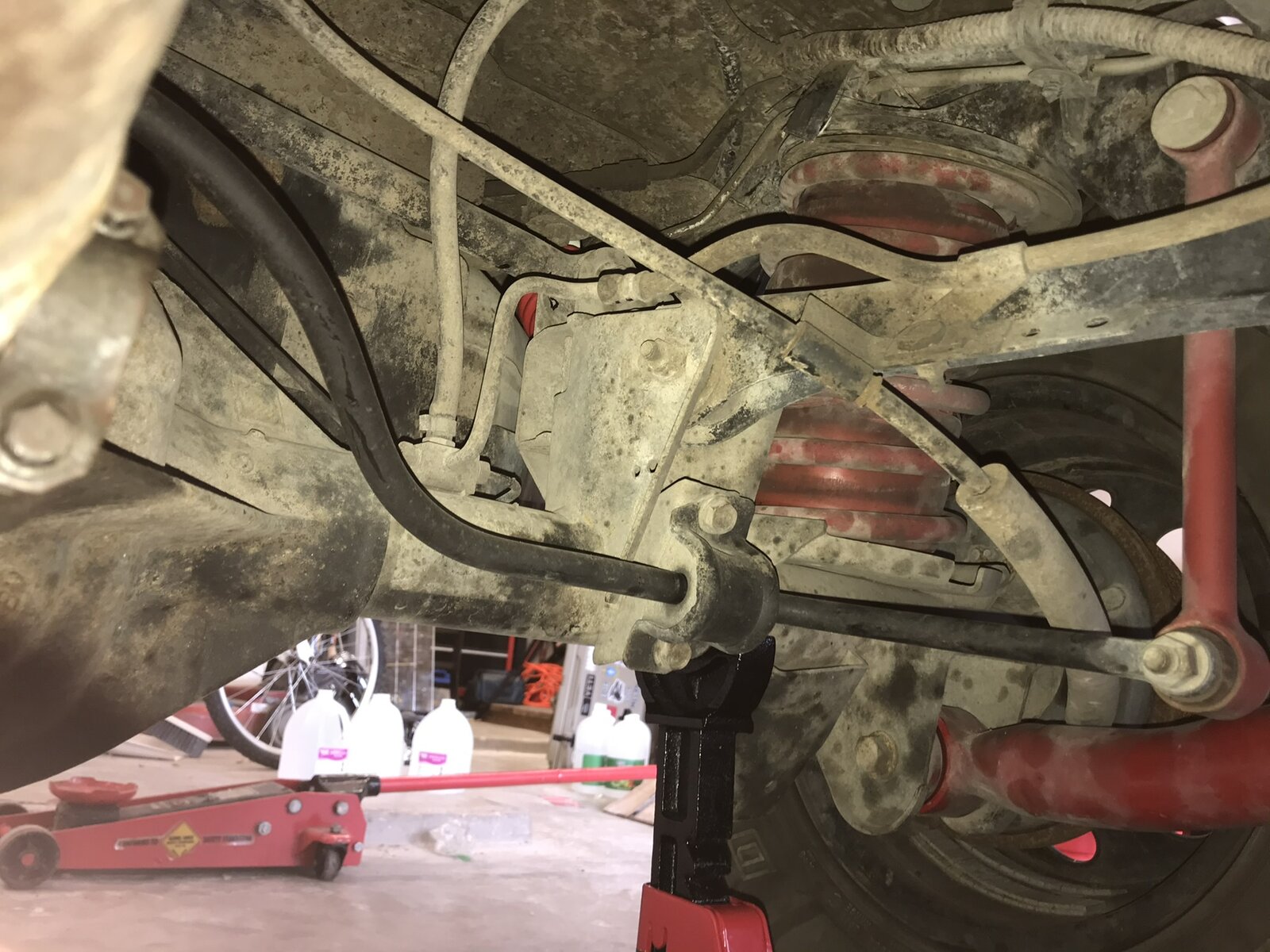

I got my Savvy Double Adjustable Arms on, and WHOA, the Jeep was getting back to solid. Couldn't believe my son had been driving it that way at Texas Tech....but.....well....I drove my CJ5 in college and it was about as bad, ha.

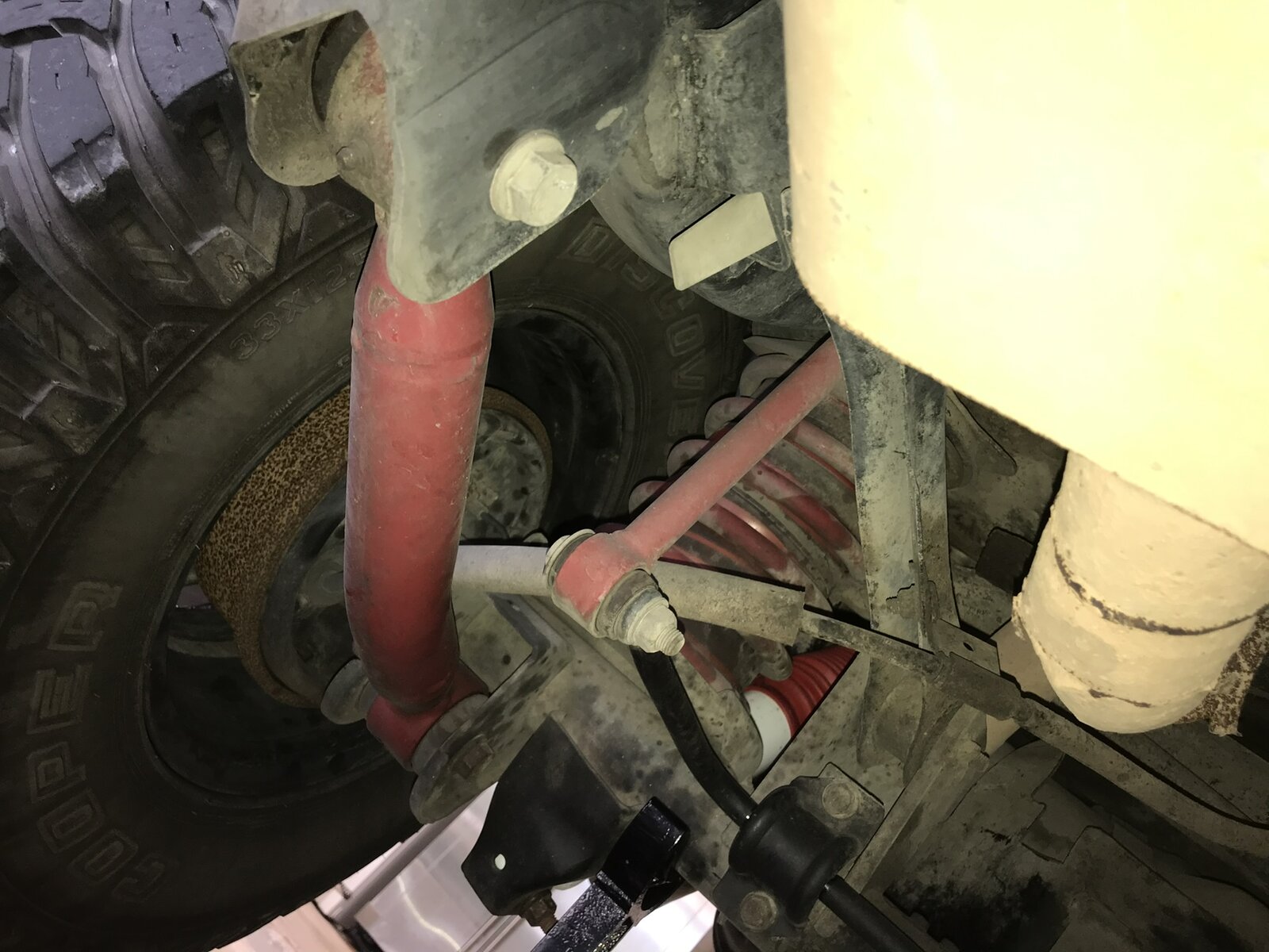

I also put in new bushings on the rear sway bar while I was at it. I'm actually in January 2023 posting this, and realizing I might want to change out those poly to rubber. I'll look into that.
They like nice before they go on, ha!!

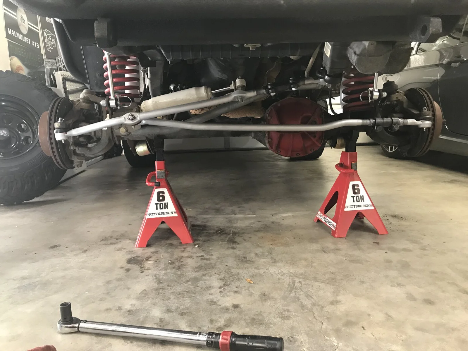

I also got rid of these Cam Bolts.
I got Black Magic Brakes washers. I know they were originally for other things (keeping grease in bolt on JJ's I think) but they can "also" be used like I did to center the bolt on the front lower axle CA's. I put the washers on. I had to file the hole just a bit to get it to fit in there flush. They do, and the JJ still is clamped to the bracket and the washer on the outside, so the clamping force is all there as it should, I've checked a ton of times on this before doing ha.
Reactions: L J

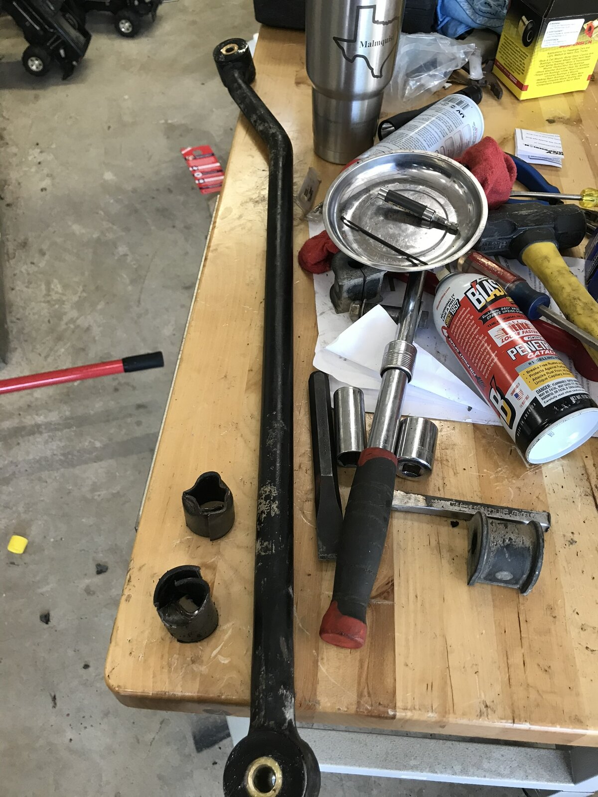

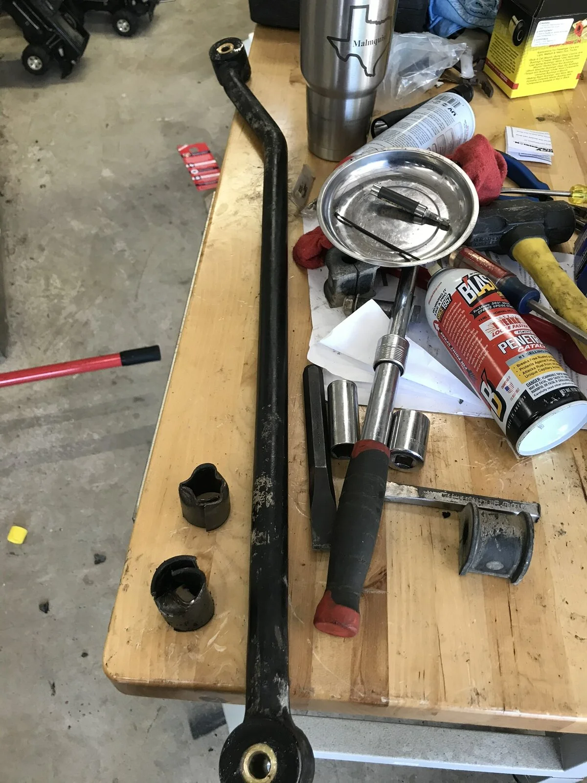

I also put new bushings in the rear track bar. While my son still drove it, I had "Just Jeeps" in Austin put in a Rubicon Express front track bar, adjustable. My at the time Dana 35 with 4.11 gears has a relocation bracket for the rear track bar, not angled. Just put in new bushings, and the darn thing didn't want to come out, was a lot of work getting the OEM out. (I switch the whole bar in 2022, ha).
But for July 2020, this was the next step.
Reactions: L J

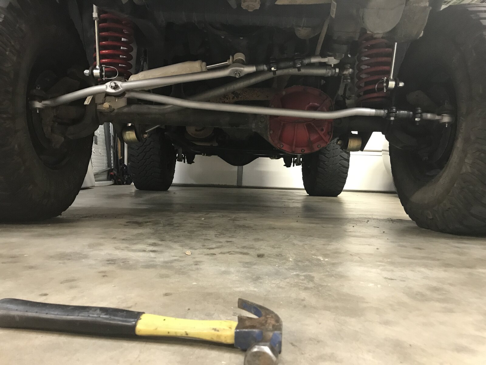

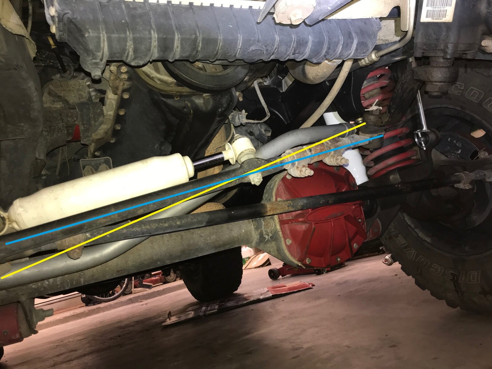

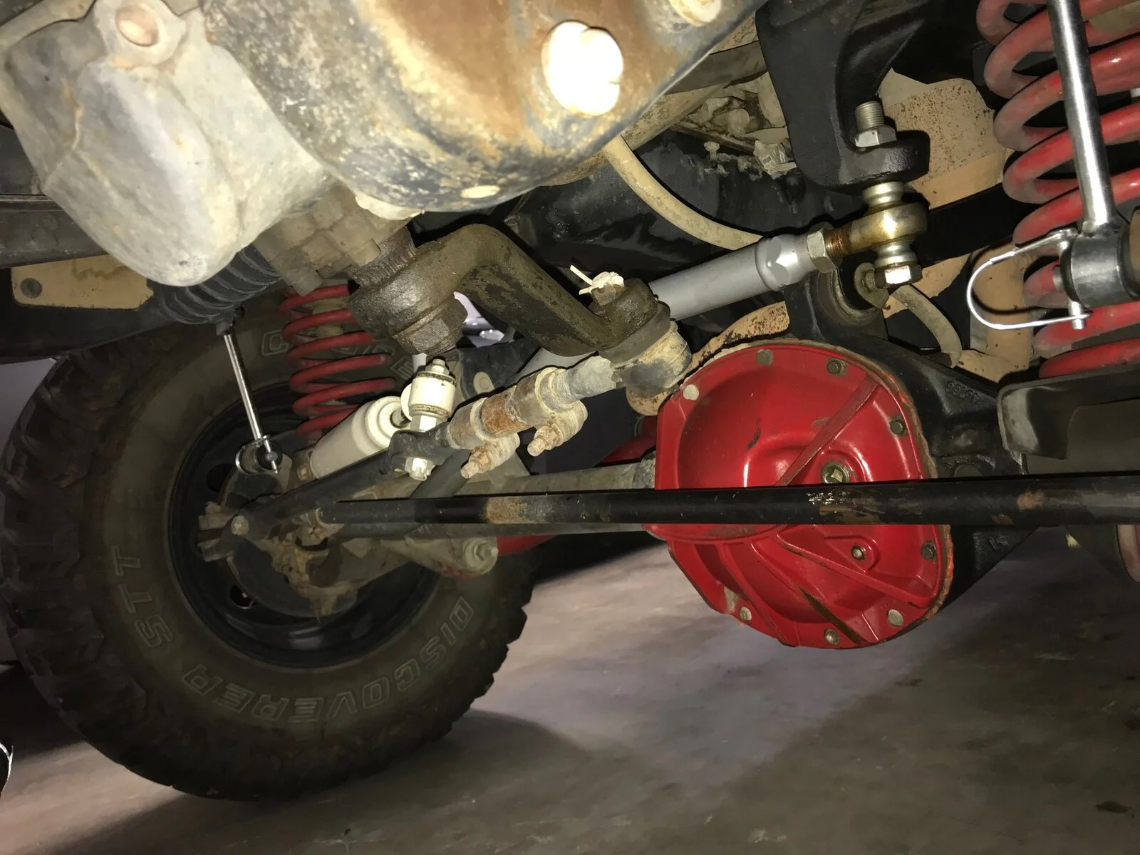

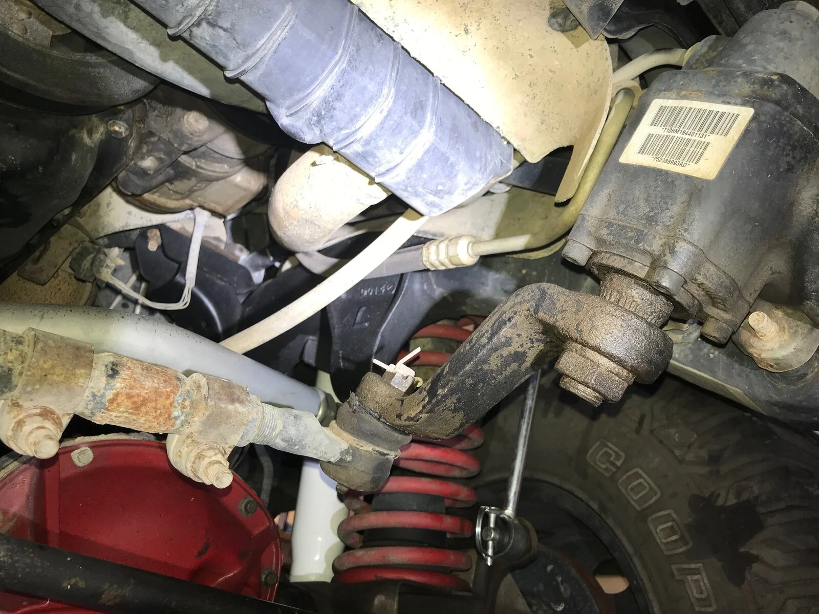

Then I attacked the Bump Steer.
This Drop Pitman Arm is obviously such a great idea....ugh, IT'S NOT.
Well, so I got a stock arm on Amazon.
I had mapped out here to make sure, that the angles were bad, not parallel (ish). So this needed to be changed and fixed.
So here we go, got the stock Pitman, and the angles are better.......and YES, no more Bump Steer. TJ Forum for another win.
Reactions: JMT and L J

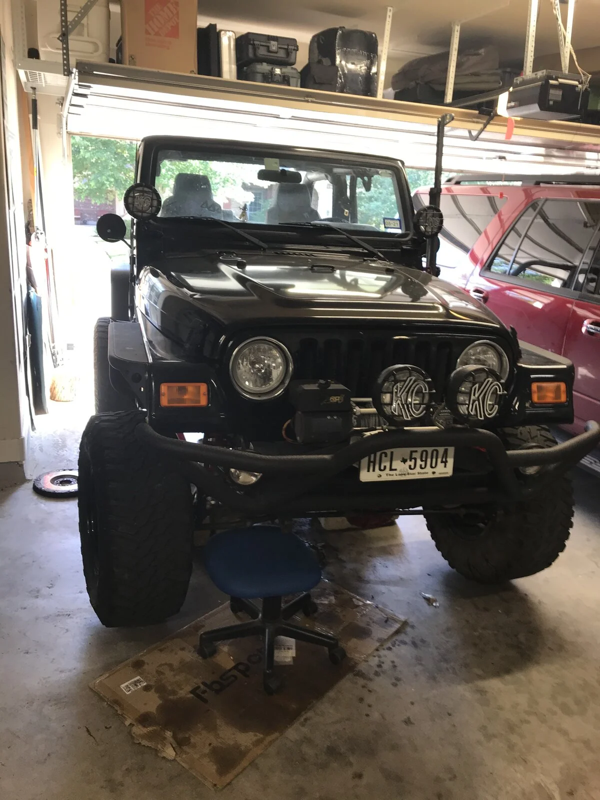

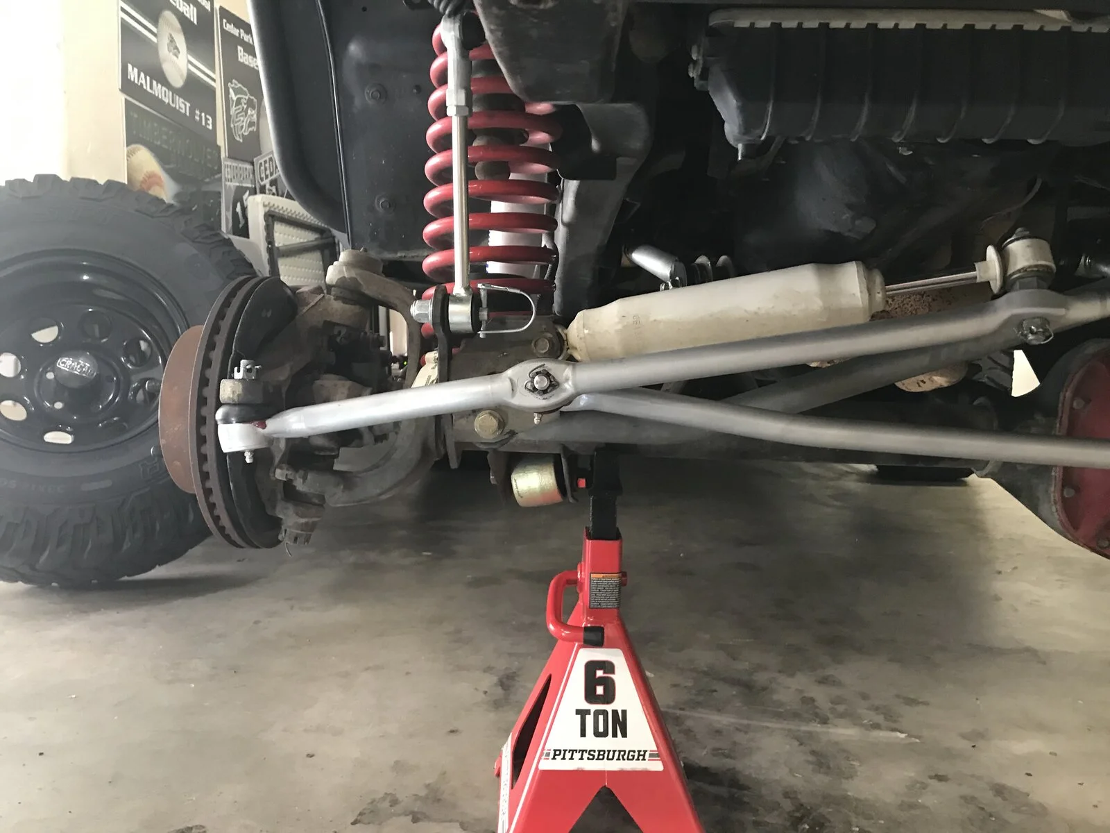

So August 2020, I had the jeep driving like a real car again.

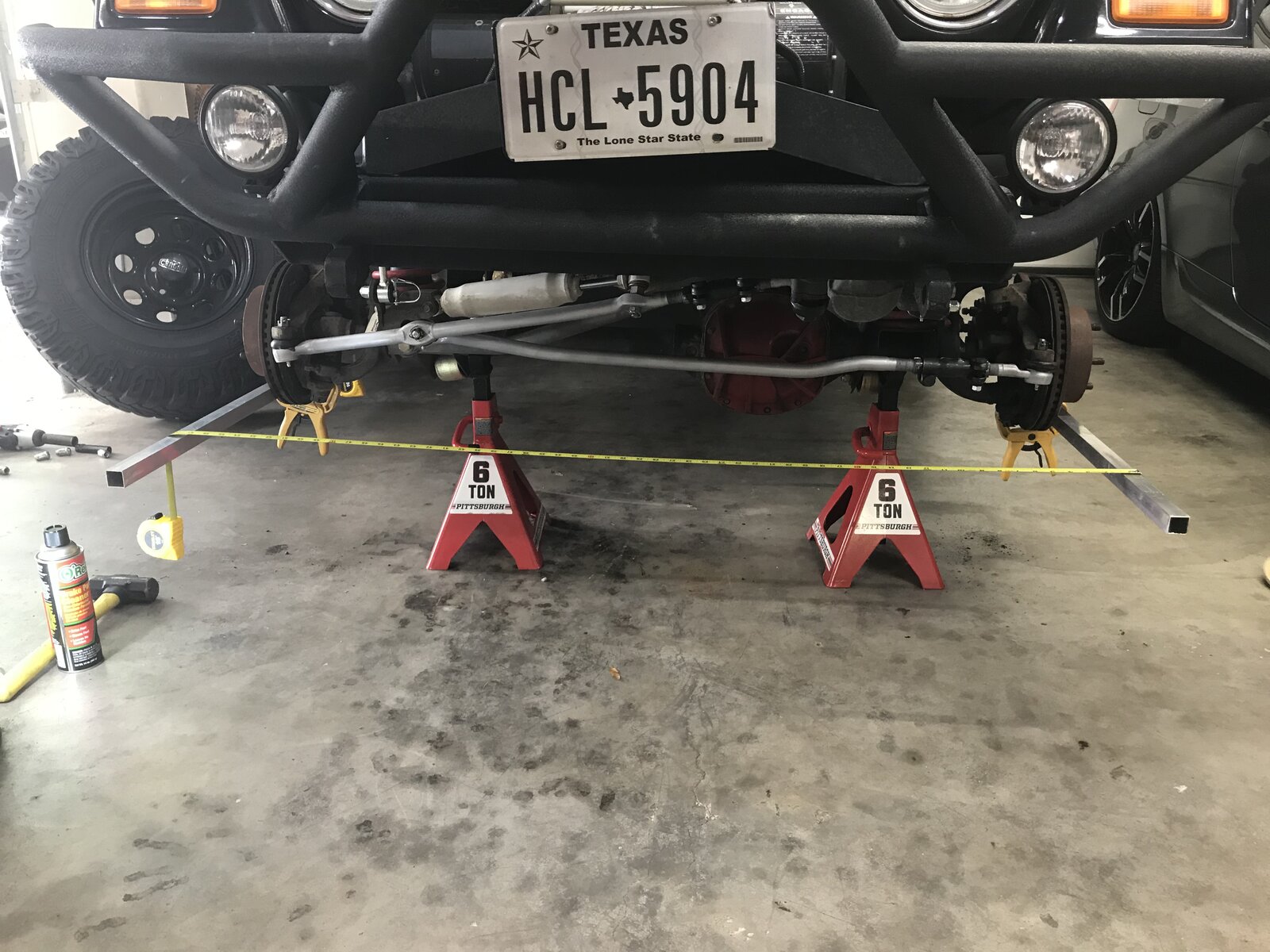

I decided to upgrade the steering to the ZJ and just got all new Moog everything, Drag link, TREs and Tie Rod.
Painted it silver, because I had it, needed paint, and it kinda matched the Savvy arms.
Also did my first home alignment from @Jerry Bransford write up.
Stupid TJ forum had me buying all kinds of parts at this point, right AFTER this, I decided to start getting all the parts, including axles, to go all in on my TJ.
So my son says "I want to get a Truck Dad" in April 2020, so I trade right then. I go "Holy Crap" this thing drives like dog Chit.
By August (I had life going on) I could drive it 75 on the highway with 1 finger.
And now I go down the rabbit hole!!!! Ha.

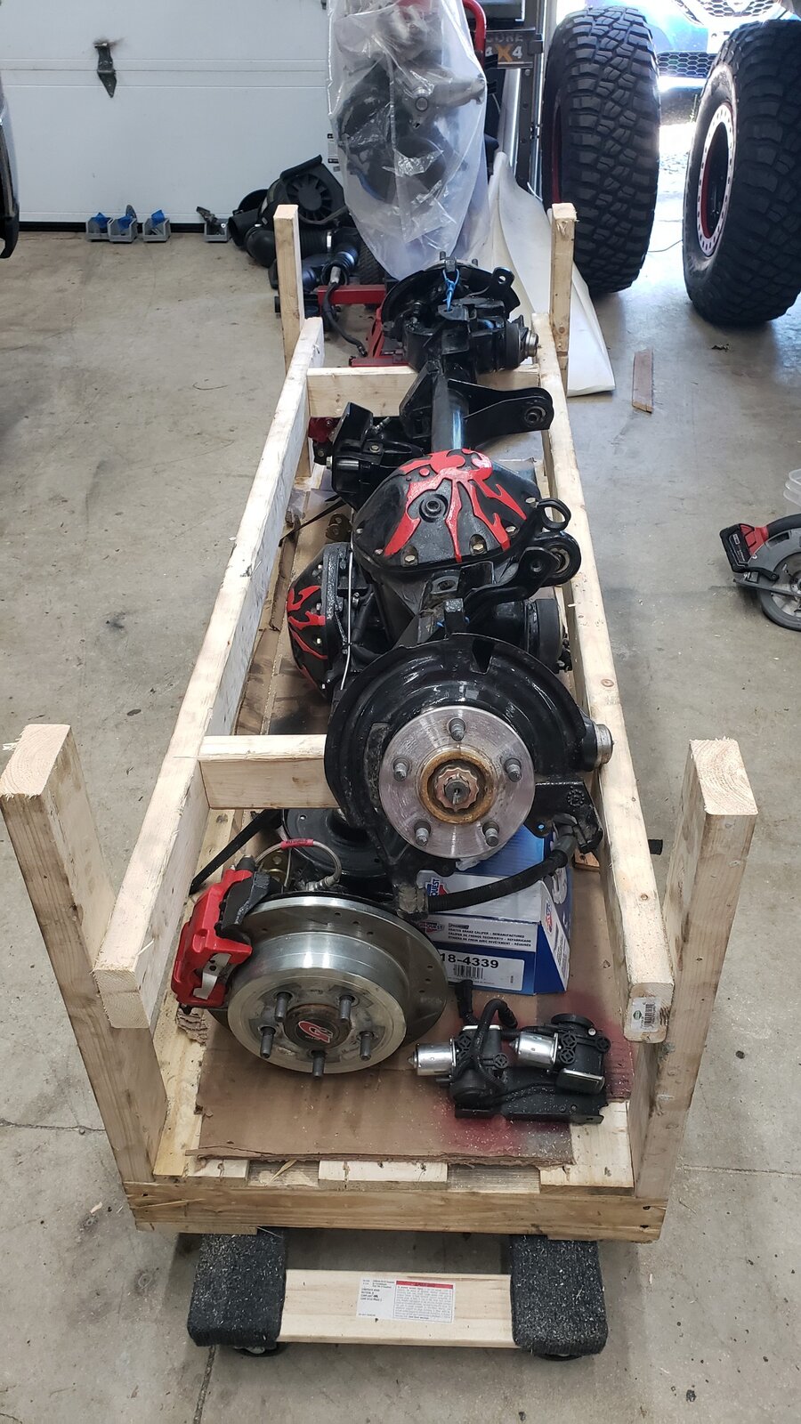

So, waiting until I get these axles, I was pretty much on holdAug 2022 through ….well until I got them.
They are Rubicon Dana 44, so I’ll need a new rear Tom Wood’s DS, and adjust the front shorter, so I wanted to do it and the SSSYE and the cable shifter and SpeedoHealer all in a project.
In the mean time, Justin who was selling them had setbacks and surgeries, really a bummer for him.

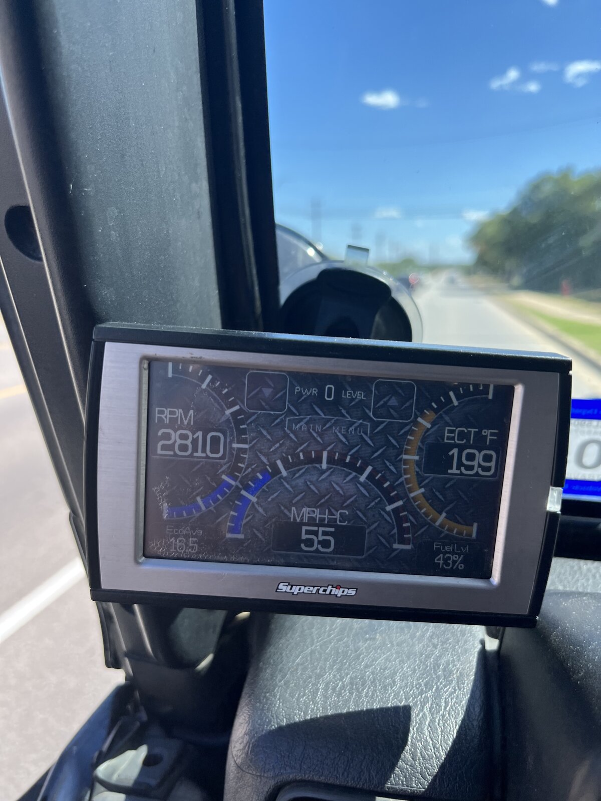

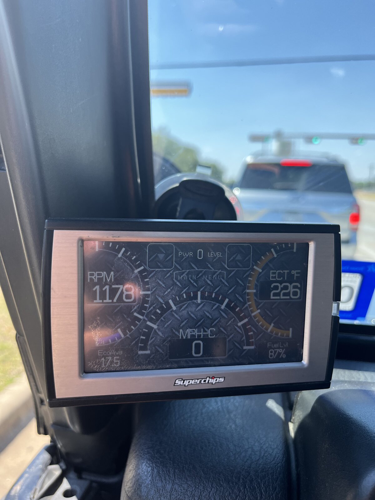

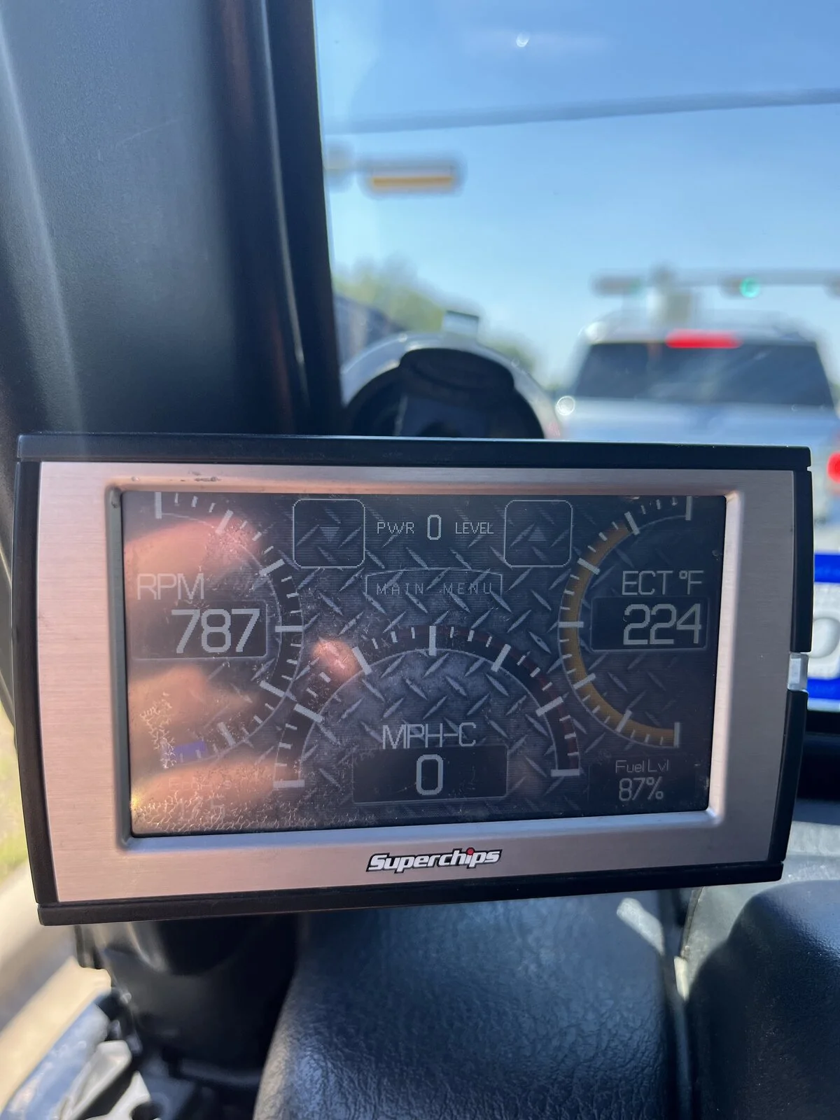

Funny, but the next thing I got to was in June 2022 (last summer). In Texas, it was just getting hot, as in 102 in the morning 107 afternoon kind of hot, and I've been all over for travelling, and with our humidity (not quite Houston humid).
So Here are the temps driving around in the Jeep, the TrailDash came with the TJ, so it's kind of handy here.
These temps were higher, and consistently up here, sometimes over 230.

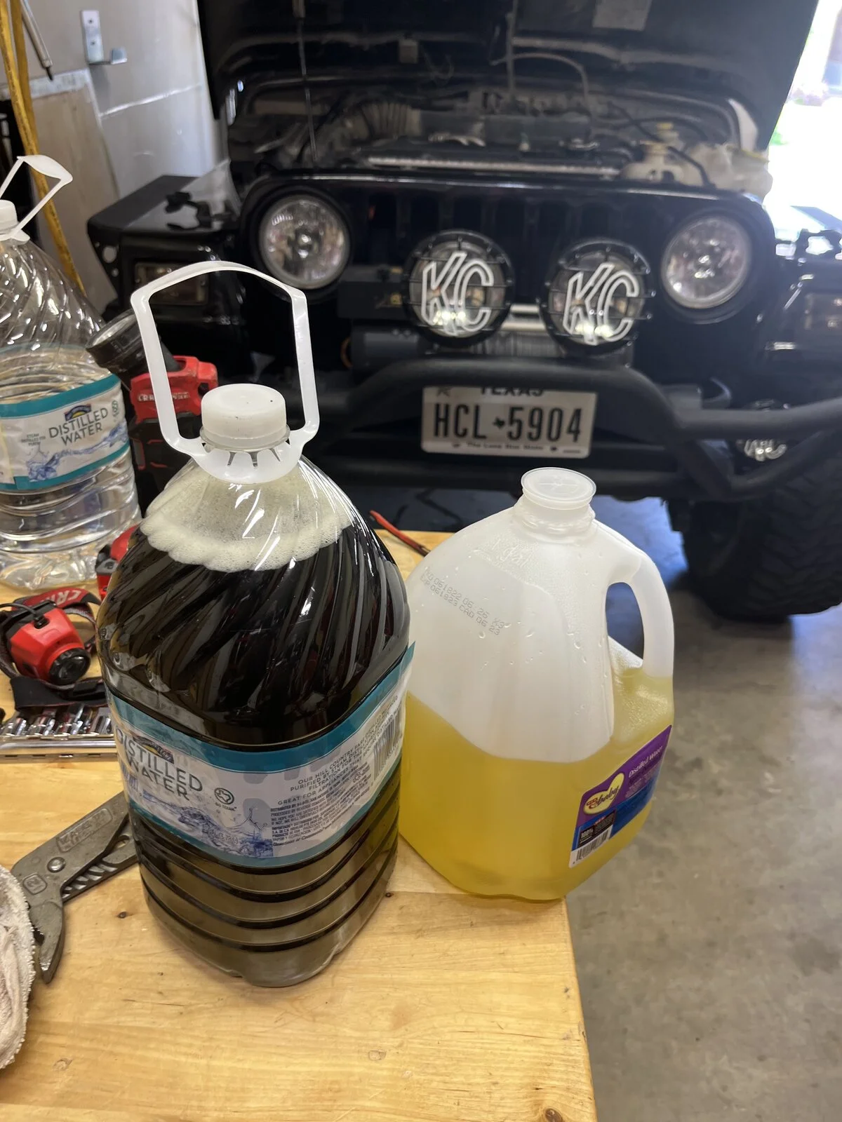

So, I got after it, new Stant Thermostat 195, new Mopar Radiator, because I know an aftermarket went in by a shop right after we got it in 2015, before I had time to really start working on this TJ myself.
I also have a small heater core leak I can smell, so I put a dorman bypass on, and figure I'll get to the heater core later, this is not my daily.
I also ran a flush, Prestone I think and then the Thermocure for sure.
Here is after the Thermocure flush, it came out 100% black, and then got it to clear.
I did get the square I think 8MM socket head and drained the block.
Word to the wise, this took me a week trying to get to things, because I hadn't learned my lesson. Here is the lesson from Blaine, that I now know:
Put in the ThermoCure, let it run a day around town.
Drain it, and take out the thermostat and put the housing back on with no thermostat.
Then fill with Distilled, run it (which means it will circulate and not have to wait until it heats up).
I could have drained, filled, run, etc 5 times in and hour.....instead I didn't know, and it took days to get it to clear, waiting for it to cool, etc.
I also drained the block each time. Final time, I put thread seal putty on the plug. It's easy and not an issue, just have the right socket and an extension.
By the way, this Thermocure black, smells real nasty, ha.

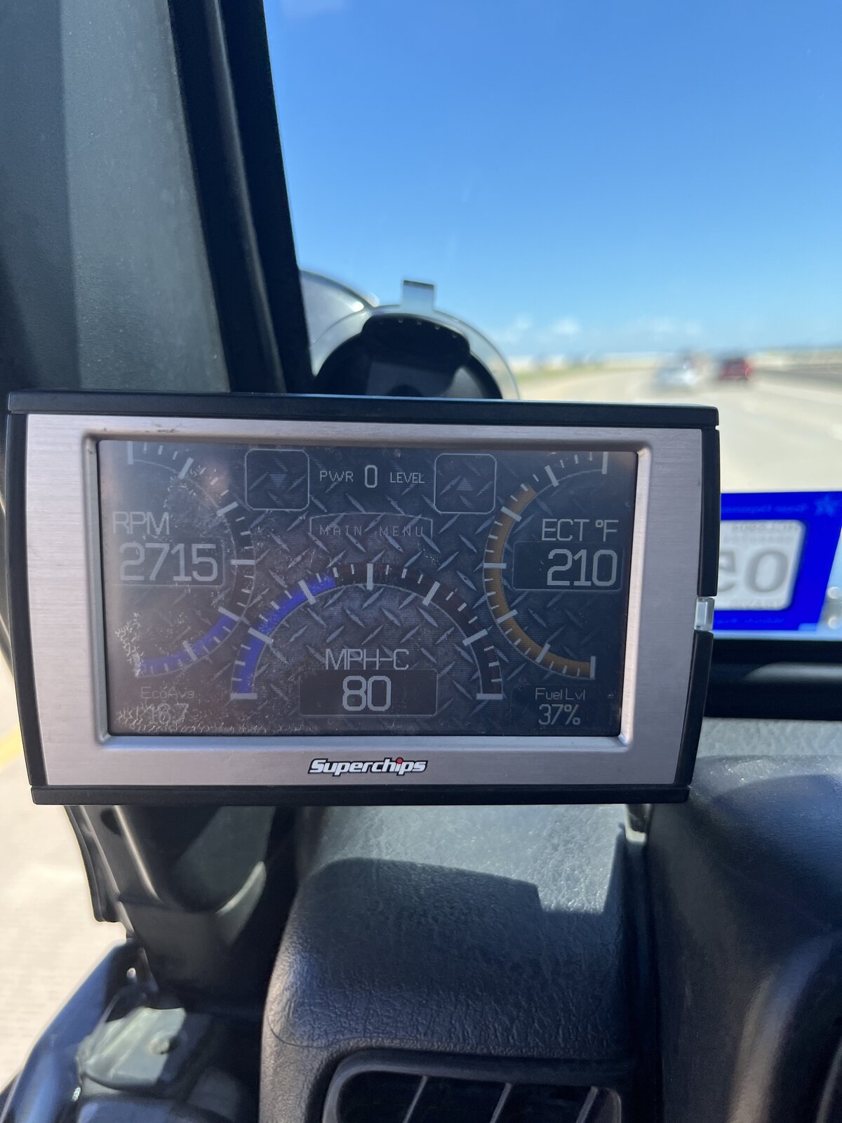

Here are the results. This is Stock Cooling system, 100%, ne electric fan or lower thermostat or cutting my hood for vents, and I have a winch and stuff in front. AC on, it was hot like the face of the sun, and driving around. At speeds, it was literally sticking at 199 and drifted up some here and there, but always came back down. It got to 210 once at 80 on the tollway (see, told you it drives way better) and it actually lowered a touch.
This is 102+ and also AC full blast. It's now January and there's not been an issue what so ever. I'm fully convinced the stock cooling system can handle the jeep. When at a stop light, it actually ran steady, sometimes came down a degree, which means the fan and clutch and everything with the system is working, pretty happy.
Reactions: JMT and NashvilleTJ
