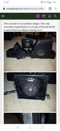

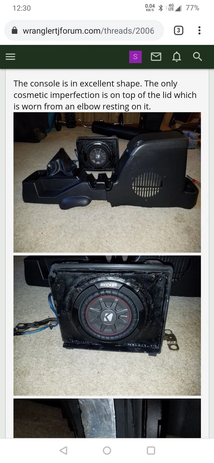

Here is the link to the 8” sub upgrade I’m trying to duplicate. If 6.75” is great, 8” must be better, right?!

Which way did you end up going? Been wondering if you could fit an 8 in the stock box with just a bit more dremeling.
