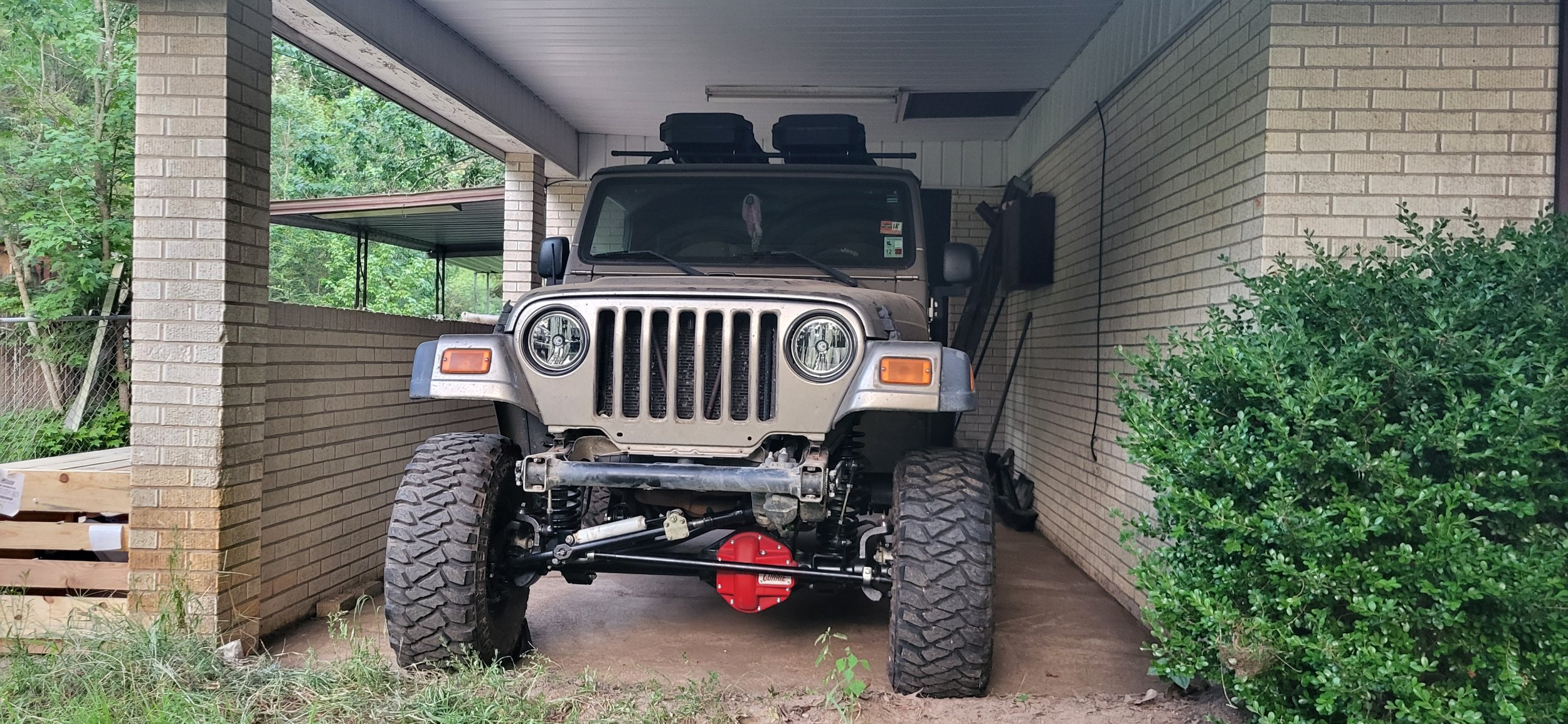

It's been a while since my initial post, but I've been replacing my stock front Dana 30 with the Currie high pinion Dana 44 as well as the control arms, track bar, shocks, and springs. My weekends have been pretty stacked, so I haven't been able to make as much progress as I'd like, but progress is progress. This is also my first time tackling anything this involved, so I'm learning as I go. Here's the progress so far.

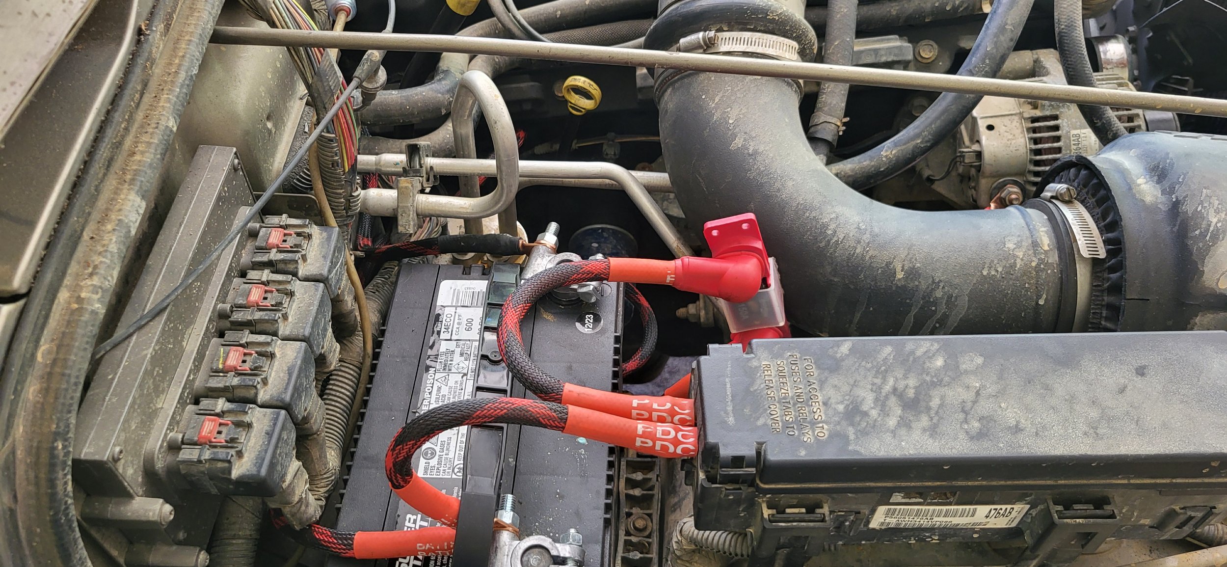

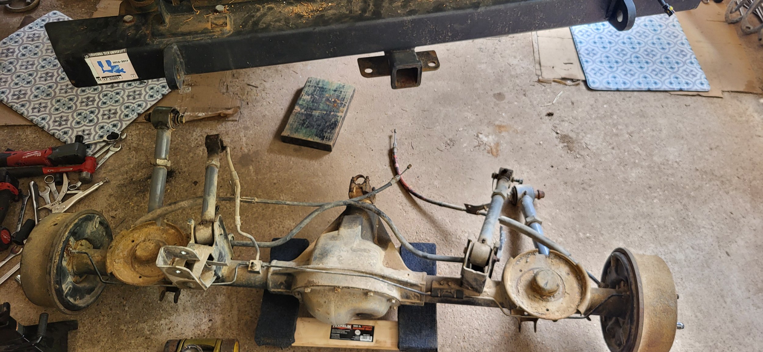

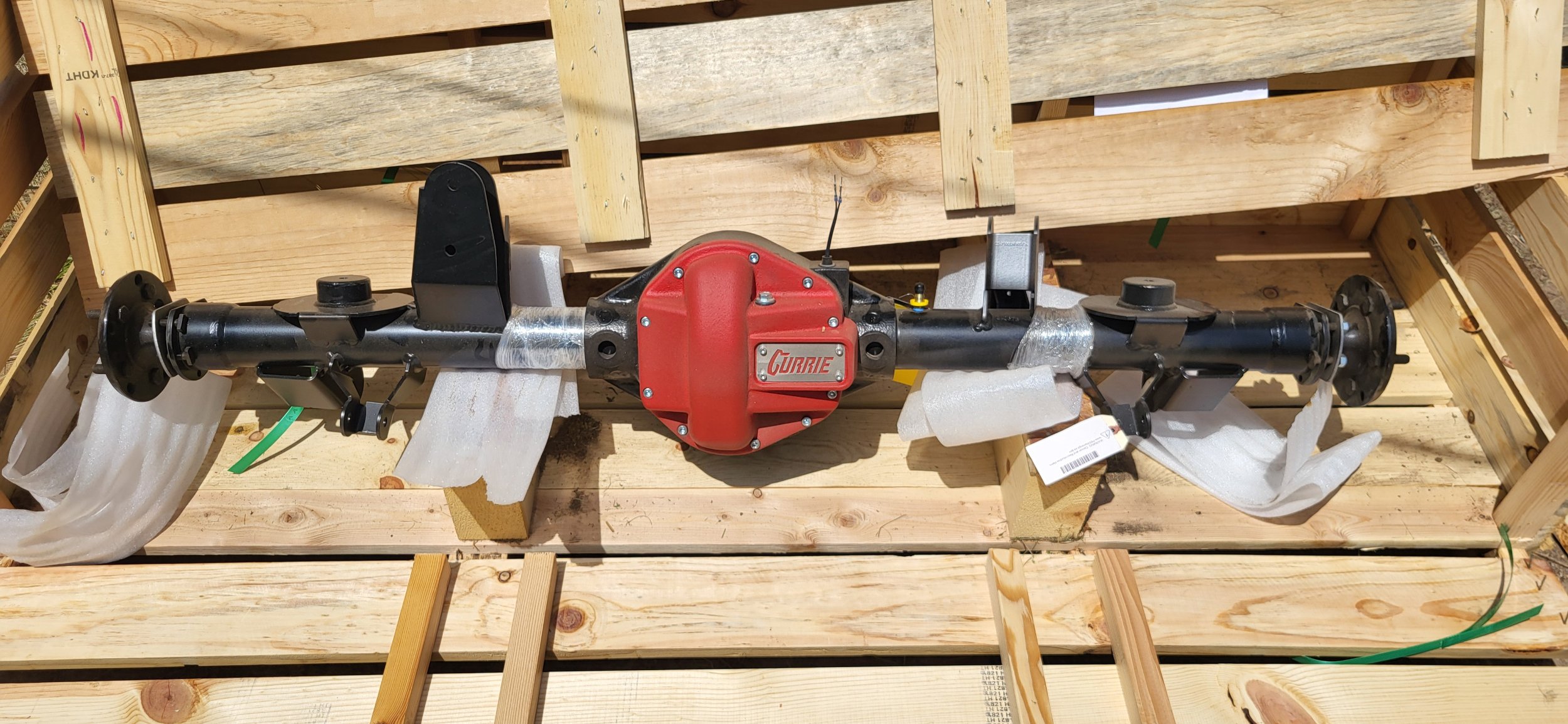

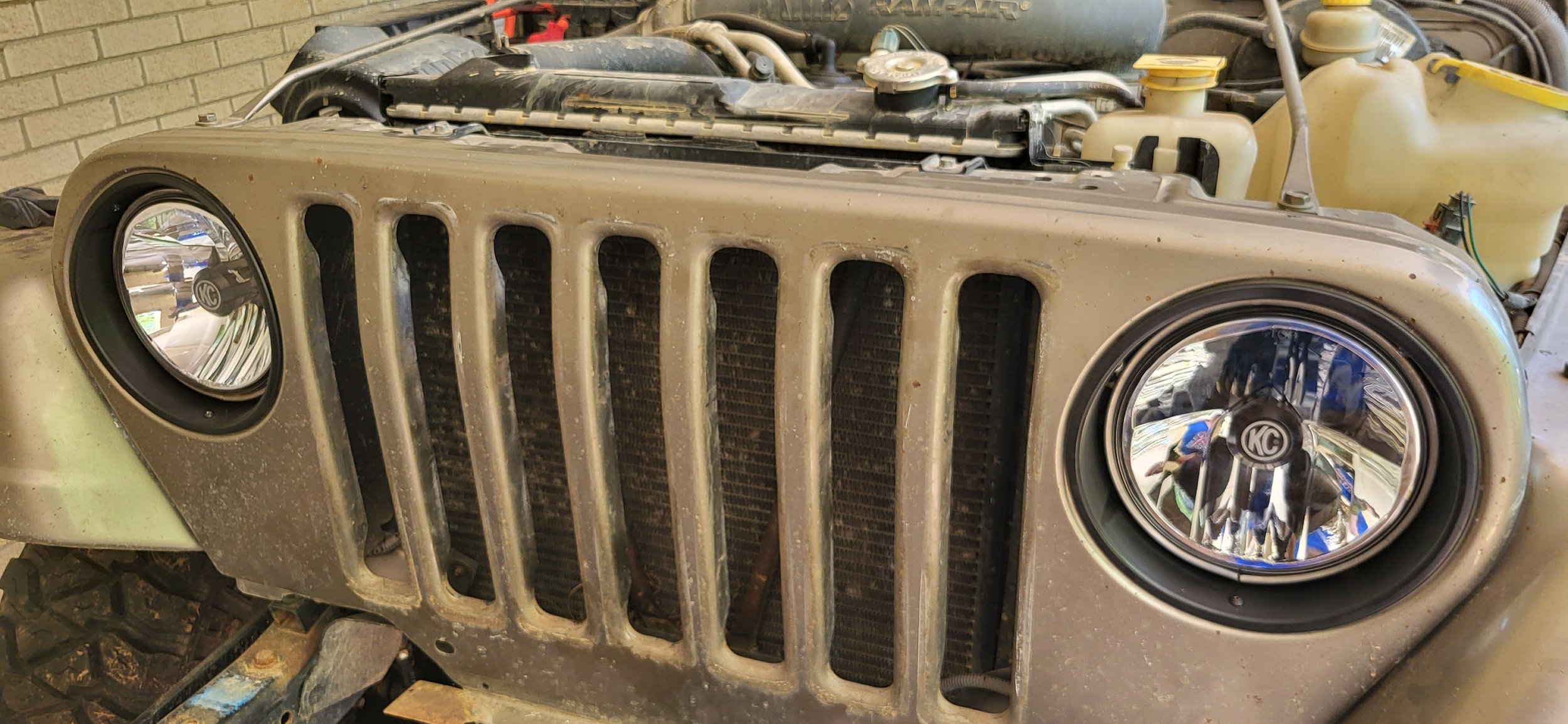

Since my last post, I've finished up the front axle swap, taken out the rear Dana 35 with the help of my old man, replaced my old headlights with some KC Gravity LEDs, and fixed some starting issues by replacing my battery wiring harness with JeepCables' Big 7 Kit. Next on the list is to add brakes to the new Currie 44 rear axle since it does not come with any brake components to include hard brake lines. I was going to reuse my old drum brakes, but after seeing how worn and dirty they are, I've decided to buy a new set. I'll also need to do my own hard brake lines since the Currie axle does not have the differential breather hose in the same location, meaning that I can't mount the block for the brake line in the same spot without drilling and tapping a new hole in the axle tube (which I'd rather not do). I'll play around with the flexible line's orientation and try to mount the block to the upper control arm mounting bracket since that would only need a drilled hole with a bolt / washers / nut to hold it in place. As per usual, here's a photo dump:

You may want to tie off that fuse somewhere. There should be enough cabling to zip tie it to the grill support. I just did this in my build thread. I don't love that solution for a solid mount — but I'd be careful with 12V lugs just flopping around...
Axle looks beautiful!
Thanks for the reminder! I've got it zip tied for now until I can come up with a permanent solution. I'm definitely surprised with how well built they are!
Reactions: FarFire70
It's a great cable set. Just try to be helpful as an outsider if I see a potential problem for a fellow Jeeper! I'm thinking to weld a tab to my grill supports... but that'll be after about 50 other engine bay changes...
So I just zip tied it up there for safety to wait for a better solution (welded tab).
I tried to use some tubing I had on-hand that was too large diameter for the grill guard supports. So, the right size tubing with tight zip ties could be a perm solution, too.
Now that I've finally had a few weeks at home, I've been able to make some pretty decent progress. I have the rear axle mostly installed, but I still need to mount the bump stops, get a good alignment, and finish out the new brake lines. I also took out the transfer case and installed a JB Conversions SSYE, and plan to get it mounted back to the transmission today when I get home, along with a Savvy cable shifter.
