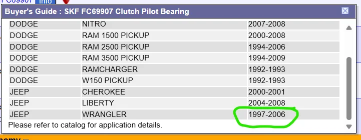

Nothing in the crank changes between 04-05. The pilot bearing and bushing remain the same.
I picked SKF because they include the bushing that the bearing presses into.
Unless you are doing the swap differently and rounding up parts you don't have, just use the 05 manifold.
