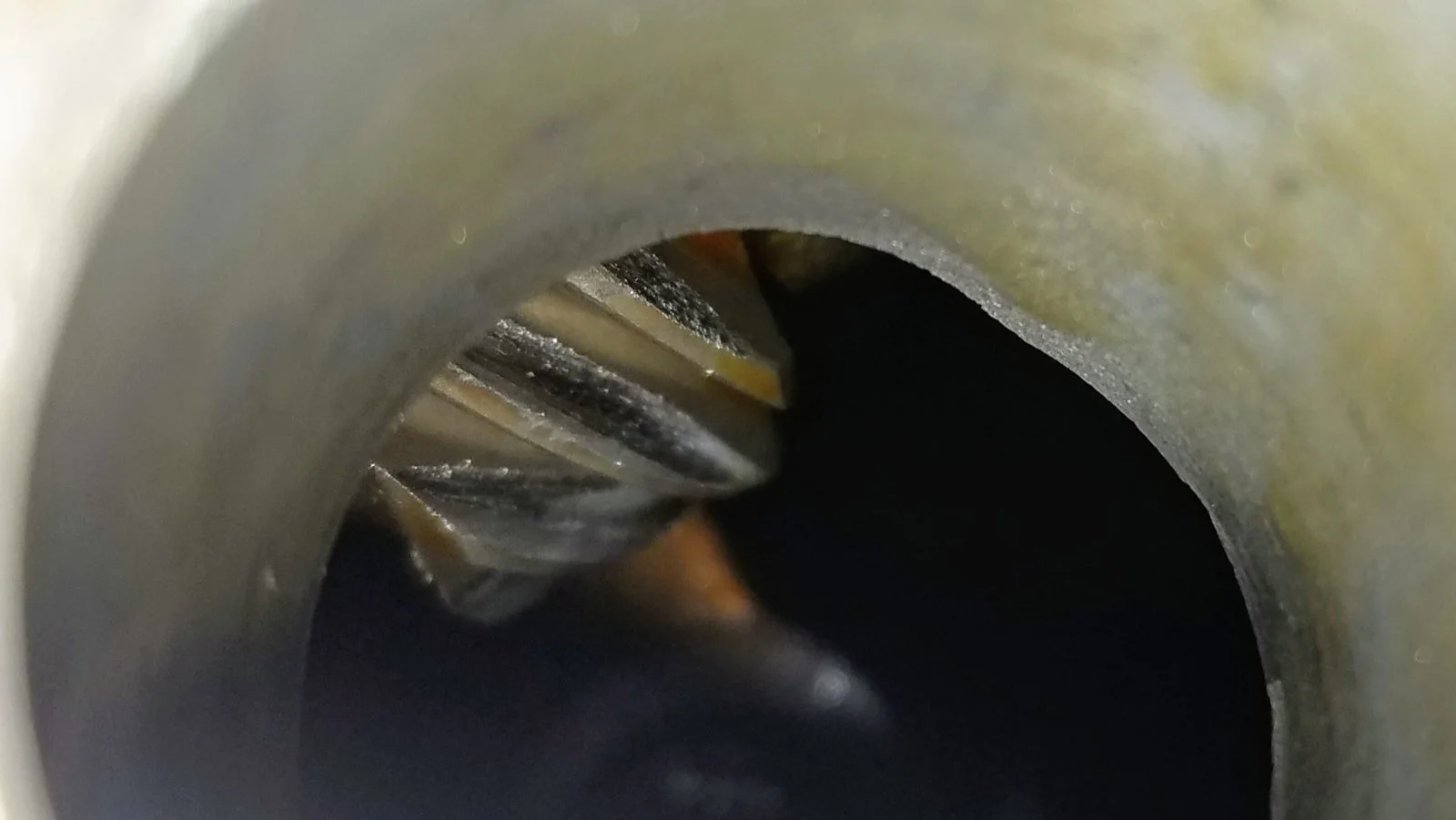

@JonTX have you taken a look at the condition of the gear on the camshaft? I am have been struggling with the issue as you on my '05, and when I recently pulled the opda and looked at the camshaft I found this...

@JonTX have you taken a look at the condition of the gear on the camshaft? I am have been struggling with the issue as you on my '05, and when I recently pulled the opda and looked at the camshaft I found this... View attachment 85019
