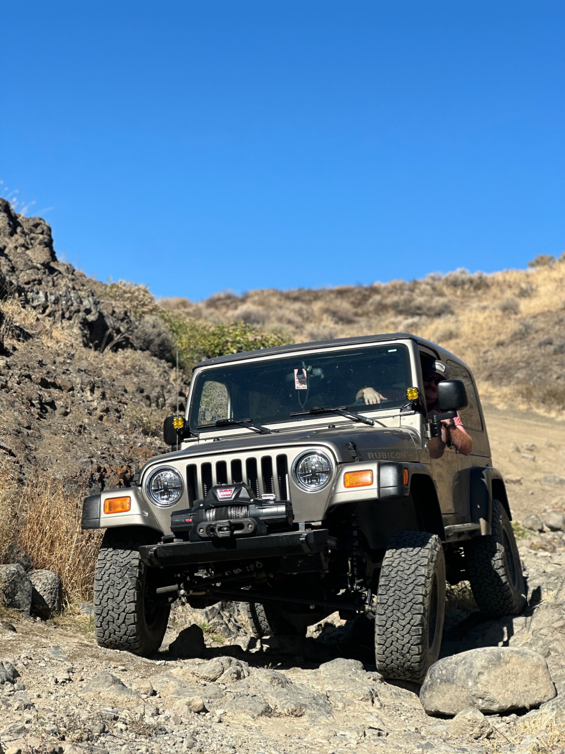

Here are a few pictures of where the Jeep is currently sitting and over the next few days I will be working on looking for photos and laying out a more detailed process of what I have done and how far the jeep has come since August.

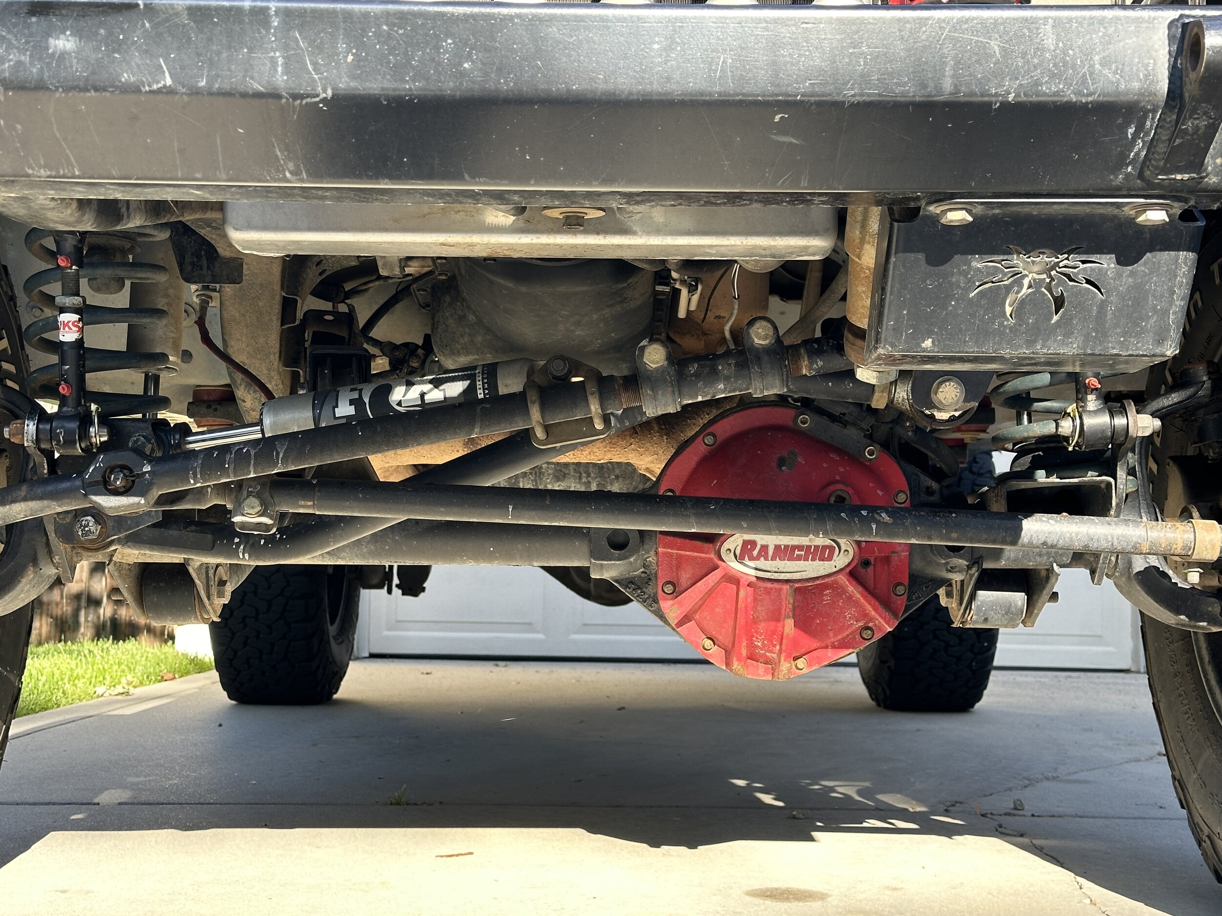

One of the first projects I did to fix the mess of suspension that I made as a high schooler. This being the dual shear trackbar bracket that I had hoped would solve the loose steering I had been dealing with. I had decided from the start that I wanted to work on slowly converting the cobbled together lift I had to something like a RockJock 4” so I ordered a front trackbar from them. I cut off the dual shear mount and cleaned up the frame. Thankfully the hole was undersized for the bolt that the RockJock trackbar used, so I was able to drill it to spec and have the correct tolerances when I installed it. Unfortunately I did a lot of this work without planning for this thread so I don’t have a ton of photos of the process up to the Jeep’s current state
Here is what I started with:
I also replaced the axle side mount with one from Barnes as the factory hole was worn out past repair. In the process I also installed new Barnett diff covers to fix the clearance issues with my tie rod, RockJock 4” front springs along with their extended bumpstops, and an Antirock front swaybar.
