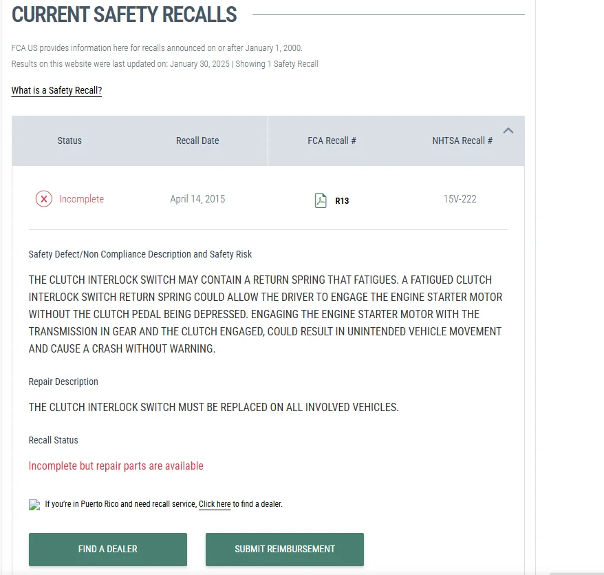

Your clutch safety switch may have failed. There is a recall on them. You can either jumper the switch or put a fuse in the off road slot. I believe it's in the PDC under the hood for an 06. Mine is a Rubi, so it will override the clutch switch in 4L, therefore not sure of the fuse slot number.

Also, even if you're clutch switch is bad, don't go buy one.
There is a recall on the 06 clutch switch, dealer will install for free.

You can go to Jeep.com and see if the recall has been done to your VIN. Mine failed in the "good" position...
Yeah just went did my VIN and it pulled it up said mine is done and dated and all. But cant it go bad again?
