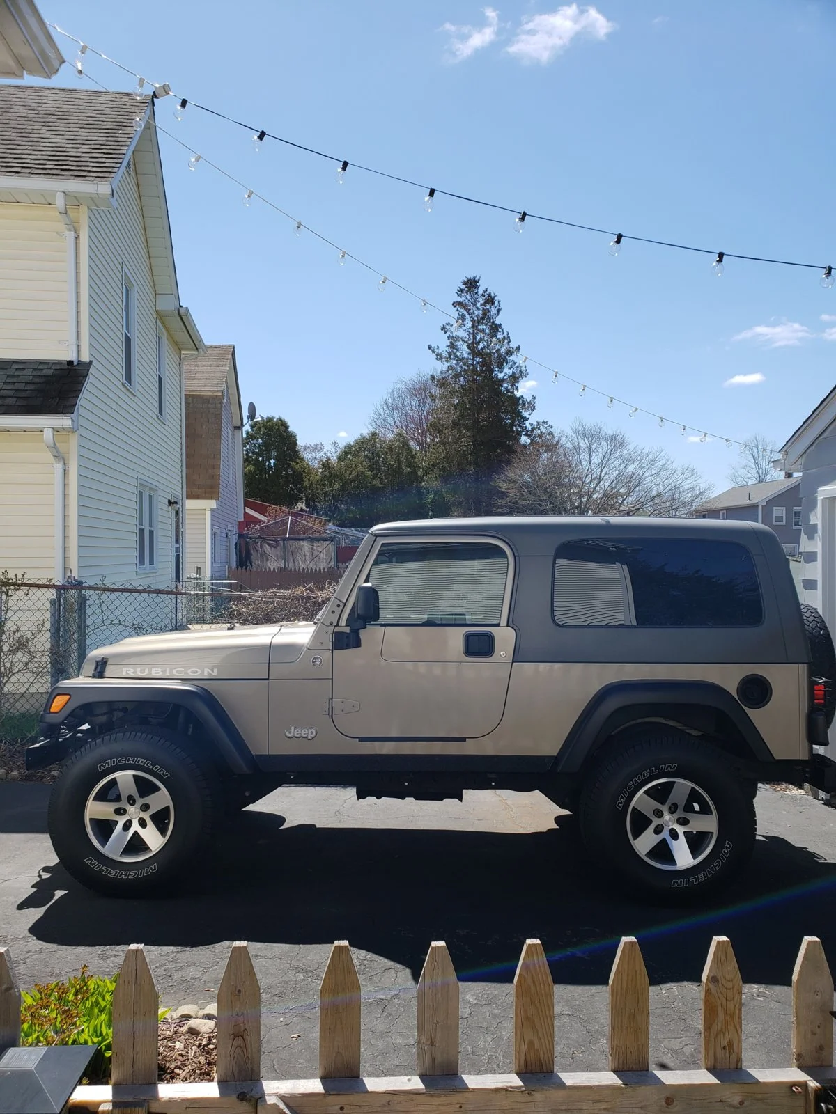

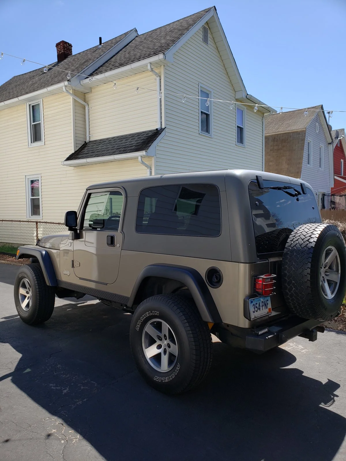

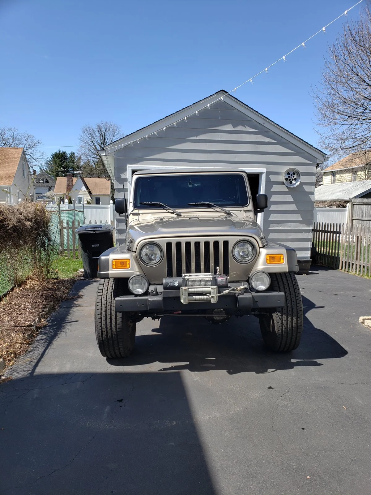

Mine, the day I bought them:
qxN575Kl4Z2zPsoopdux9RAZHVlM_Ygwj0IwmjKfs5RL8riGA9whIK8mMFnanFqACWcJlH486-eW9xur2eA=w850-h637-no.jpg

Mike, there looks to be plenty of tire on your Rubi. They look quite beefy.
