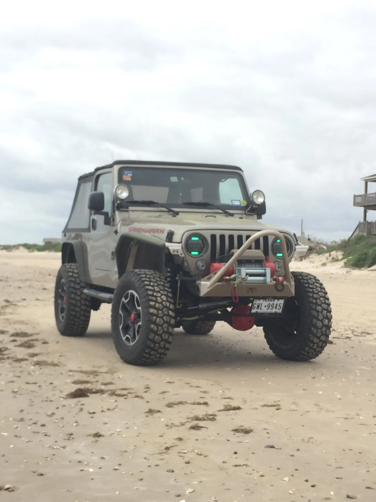

I did not. I had it on my JKU which I sold. Now I just have my TJ and am running the zone lift and adjustable trackbar the original owner installed. I'm not sure what brand because he painted it to match the Jeep. I plan on replacing it eventually.

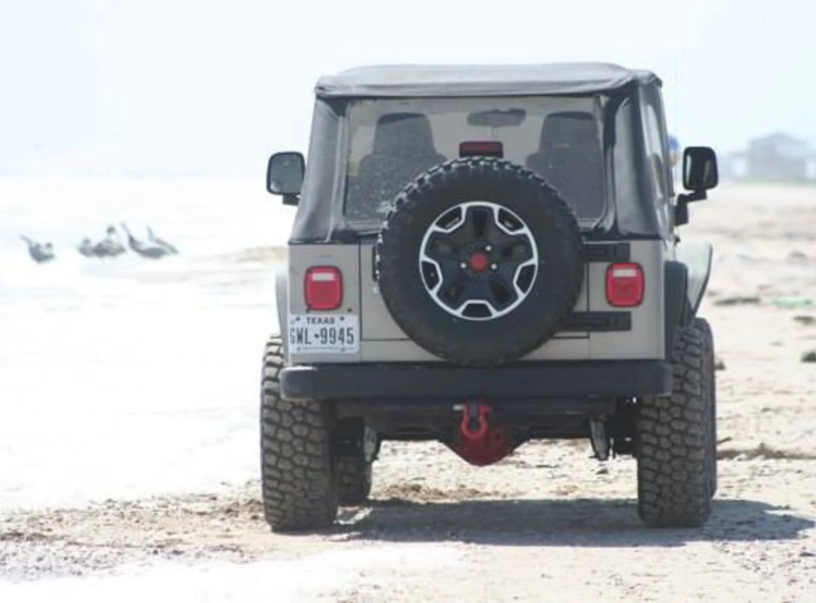

I have a 05 LJ & went with the Zone 4" lift with hydro shocks , also ordered a Metal Cloak adjustable track bar , my front shocks are Fox 2.0 tuned by savvy. I run 33" Km2. It's a daily driver & rides great , a great start to build on
