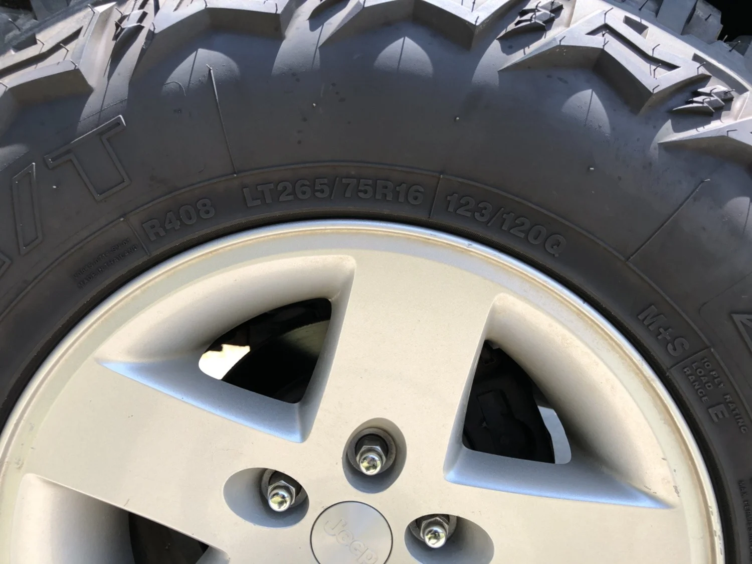

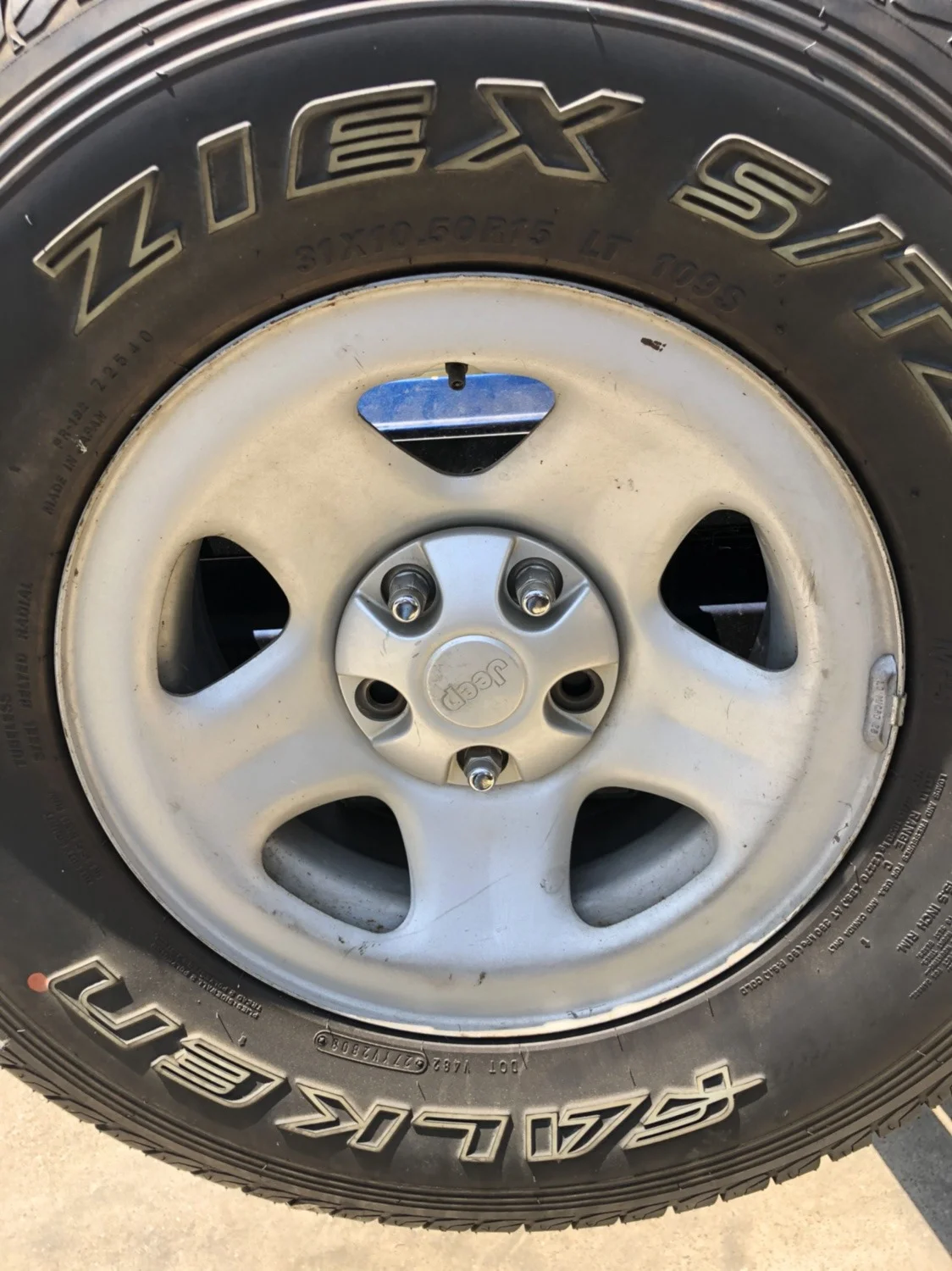

Hey guys, I was just about to take my tj to American tires to get a matching spare tire. I have 31 inch (I think 30 1/2 really) M/T tires on it. So I was taking the cover off of the spare and saw two things.

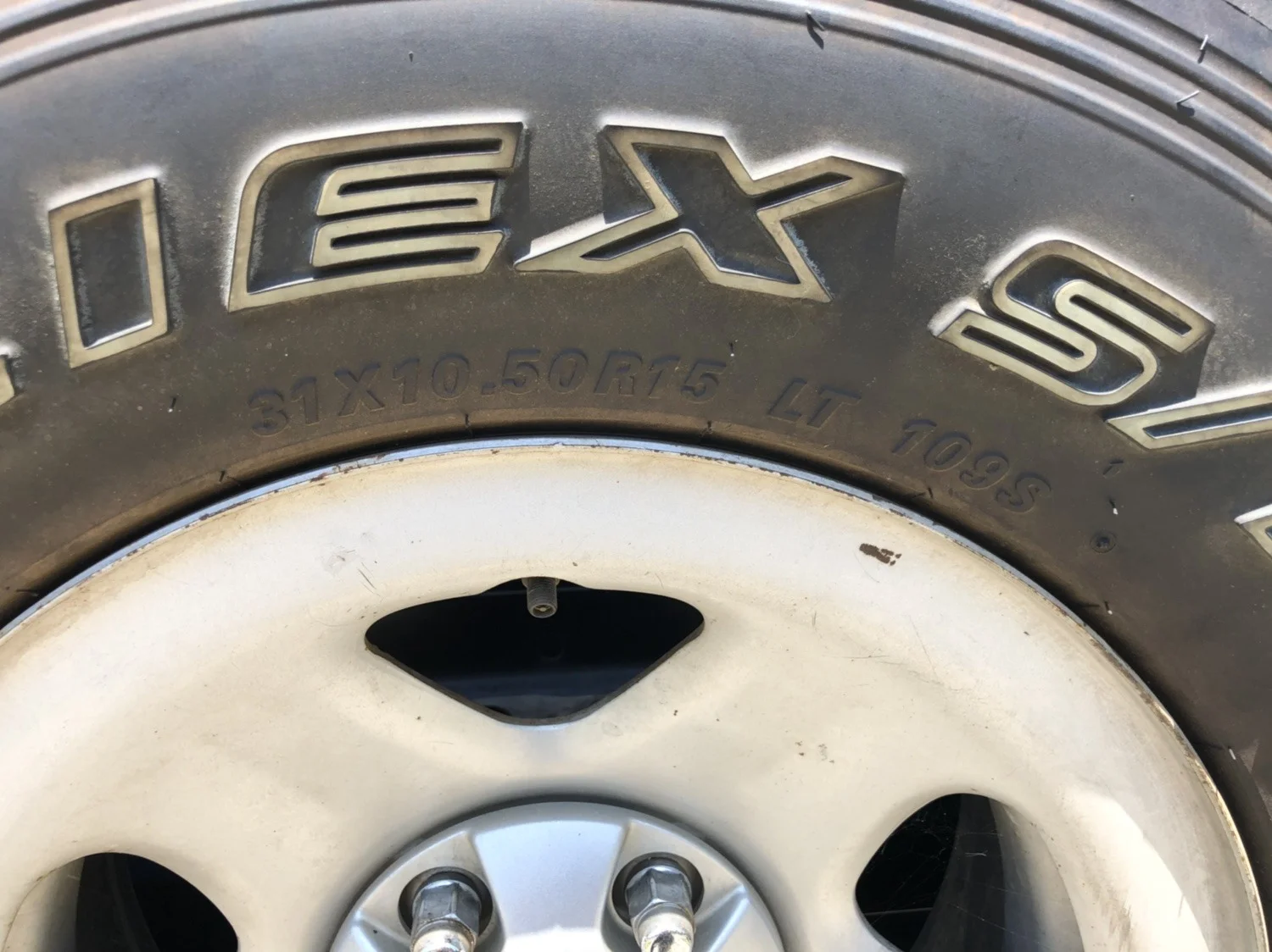

First that the spare looks like an all terrain 31 inch tire.. condition isn’t bad but isn’t great. I’m guessing P.O. might have gotten it used to match the 31s he put on it.. so I guess I do already have a spare even tho it’s not matching lol.. what do you guys think? Will the spare work with my tires?
the second thing I noticed was my spare rim isn’t a Moab.. I have a rubicon.. and all 4 rims are the Moab’s that Jeep put on the rubicon’s.. is that normal? Maybe it came with a spare Moab rim but P.O. destroyed one and used the spare to replace it. I’m not sure.. I am only wondering because it would be nice to keep the cover off when I do get a matching spare
here are pics of the tires profiles.. Moab wheel is the M/T and regular Jeep wheel is the spare..
I appreciate your guys help and input, I don’t remember the name of the tires I have, they are some knock off tho.. Americana or something.. when I looked them up the actually had pretty good reviews so idk I think I will use them haha
Spare tire, non Moab rim
One of the M/T tires and Moab rim
Close up of spare tires dimensions
265/75R16 comes out to 31.6x10.4
So yes, it will work. However, I wouldn't run that spare on the vehicle for long periods of time, unless it's just to get home. Mismatching tires and tread patterns isn't ideal.

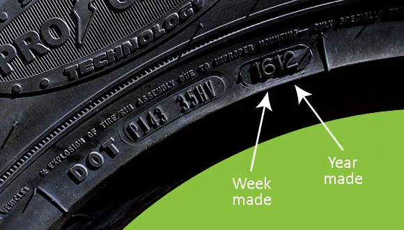

In addition to that, that tire looks severely dated. I would look for a production date on it. If it's 7 years or older, it's no longer safe to drive on, regardless of the amount of tread on it.
Tires DO go bad with age, even if you've never driven on them.

Tires always have a date stamped somewhere on the sidewall. Often times it's small and hard to find, but it's there somewhere.

Sadly, most of us just buy a car or tires without checking the dates to confirm the age, it's of particular importance when buying second hand tires, in addition, I would only be using second hand if I lived on a rural property and wasn't intending on infecting my shortcomings on fellow road users so here's how you find when your tires were manufactured: whos running to the garage right now?
"The first two digits are the week of manufacture, and the last two digits are the year. For example, if the last four digits of the DOT code are 0203, that means that the tire was manufactured during the second week of the year 2003."

Ok I see, yea those are class e tires. Now I thought having a higher ply rating (class e are 10 I guess) is good for wheeling.. they won’t puncture as easy.. but maybe I’m wrong?
A higher ply rating will mean stronger sidewalls (less likely to puncture). However, an E rated tire is a LT (Light Truck) tire, and is meant to hold somewhere around 80+ psi, due to the fact that it's meant for a truck, which weighs nearly double what our TJs weigh. Put those stiff tires on a TJ, and they can rattle your fillings out.
Now, I will say that having run E rated tires on my Moab wheels, if you keep them at 26 psi, they aren't all that bad. However, I can tell you that a C or D rates tire still has a softer and more comfortable ride.
