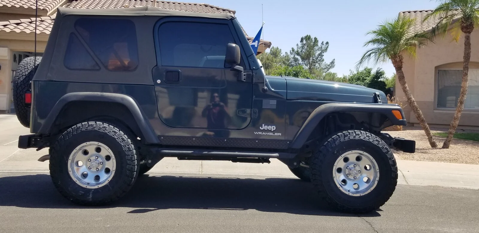

2.5" OME lift (closer to 2.75) + 1" body lift and 31s to give you an idea.
