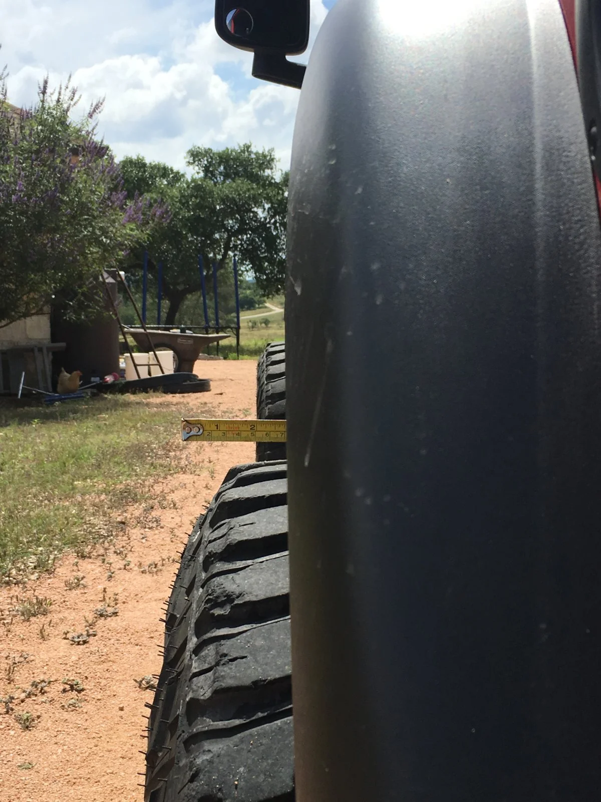

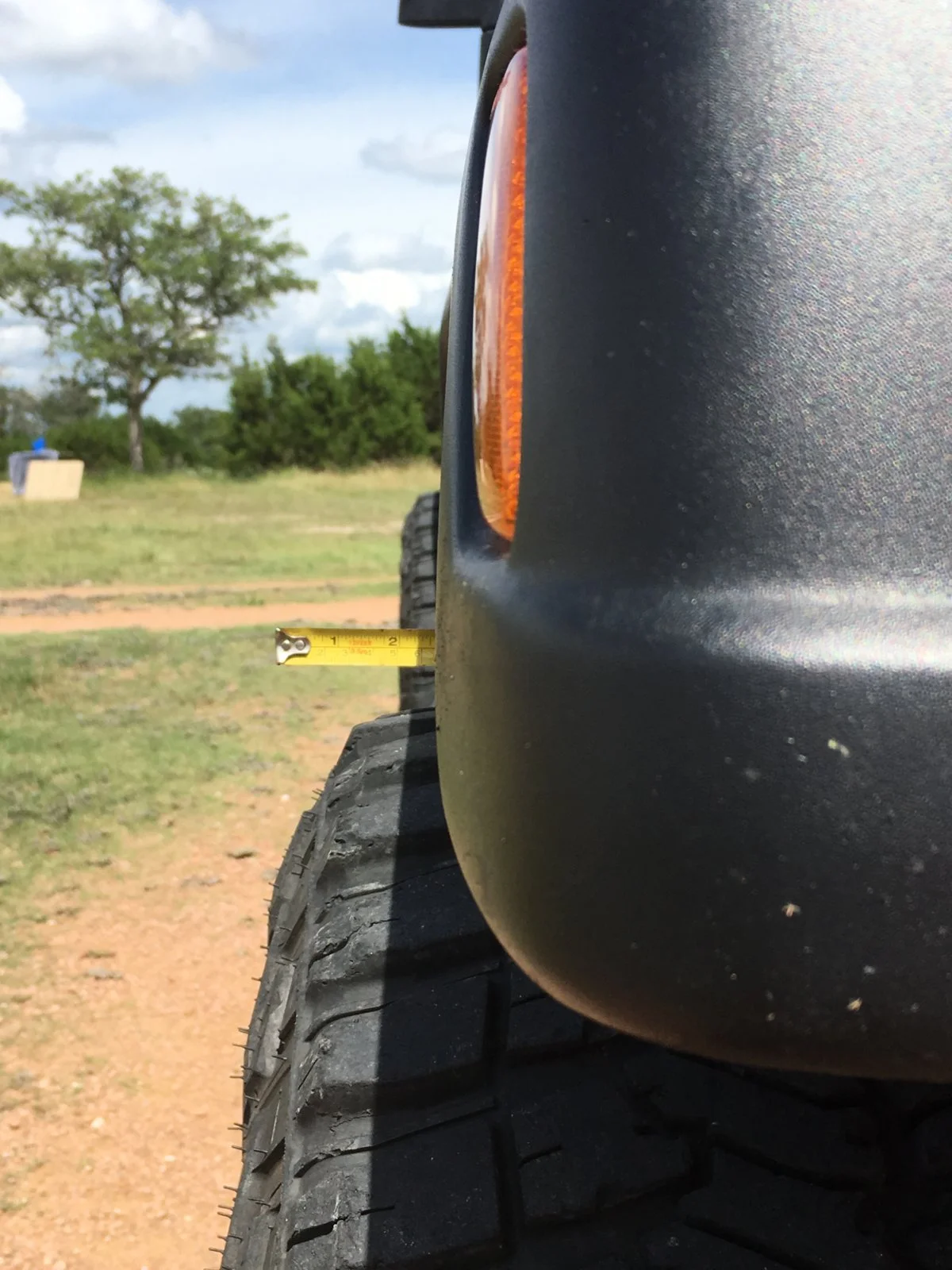

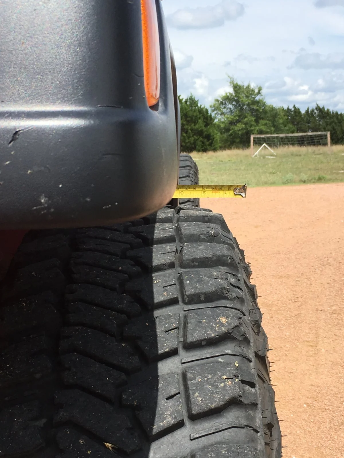

@JMT, how far outside of the fender flare do your wheels/tires sit? Can you take a picture looking down the side (either side works) of your TJ from the front? I'm curious how far the wheels and tires stick out on 31s and 3.75" of back spacing with the Dick Cepek wheels. Thanks

@UpperMI Ok, keep in mind my front axle is off center 1 1/16". Next week I hope that is fixed. Anyway, here goes!
Drivers Side Front
Passenger Side Front
Drivers Side Rear
Bc of the axle shift up front, the rear is probably the truest representation. I thought about some Rubi flares which would give a little more coverage, but I'm not one who likes full coverage.

Thanks for taking those pictures for me. I appreciate it. It looks like you have 1.5-2" of tread outside of the flare before the sidewall roll starts. I think the Rubi flares would be perfect. That would leave you about an inch exposed.

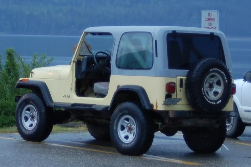

I really wish BFG still made the 33x9.50KOs. Here they are on my YJ with a 2" lift and stock steel rims.
I'm with you. Getting tall and skinny is getting harder and harder which is a real shame for those of us that daily drive more than off-road. I think there are only three manufacturers left making 255/85R16 (33x10) anymore and, unless someone can find one that I can't, 33x10.5R15 is the skinniest 15" I can find.
