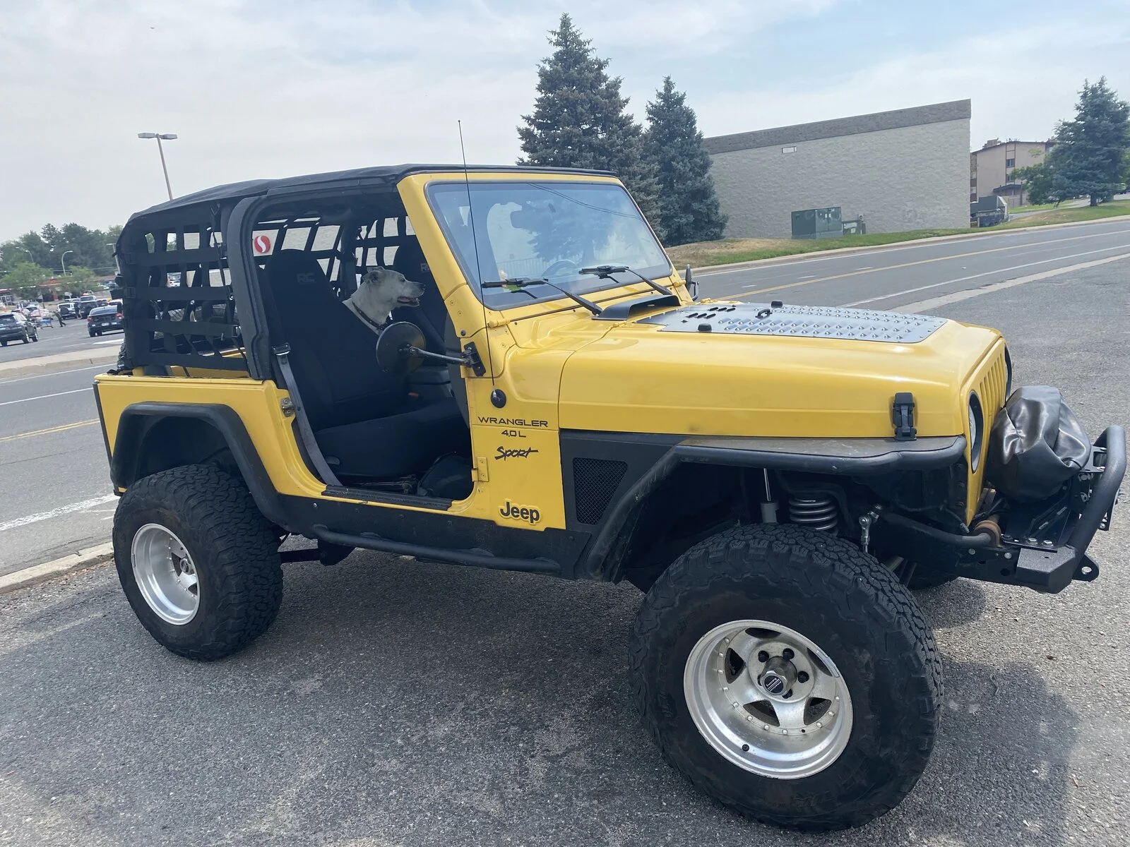

I stepped down from 285/75R16 to 31x10.5-15 and the ride is better around town and back roads. I have a 2.5" lift . IMG_1263.JPG
