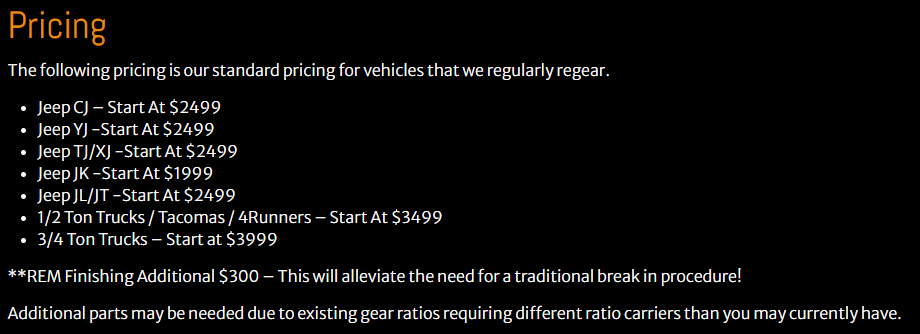

Dallas Offroad is a fairly well-known and respected shop here in north Texas. This is from their website:
What is this, NTJC? I have no issue with Dallas Offroad, but the number of people around NTX who knee-jerk recommend them for putting air in the tires or changing headlights is just insane. But I shouldn't care how other people spend their money. Good for DOR for having found a way to print money.
Although I'm not sure why they needed to break CJ/YJ/TJ/XJ/JL/JT into 4 line items all for the same price, but I'm super surprised they didn't just make the JK be the same price, knowing full well nobody would question it. Why is it $500 cheaper?? Regardless, that's consistent with the quote I got from them last year for a regear.
