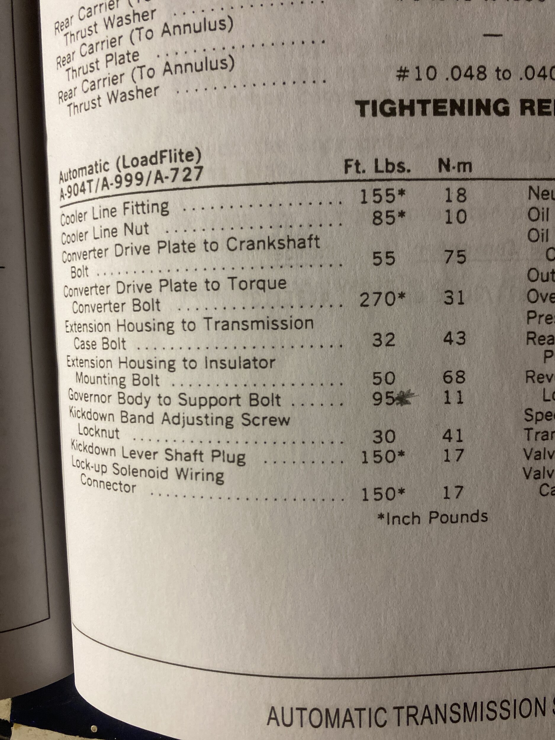

Torque Specs
Pump-support bolts: 15 ft-lbs
Pump-case bolts: 175 in-lbs (this is incorrectly listed as 175 foot-lbs in the ATSG manual)

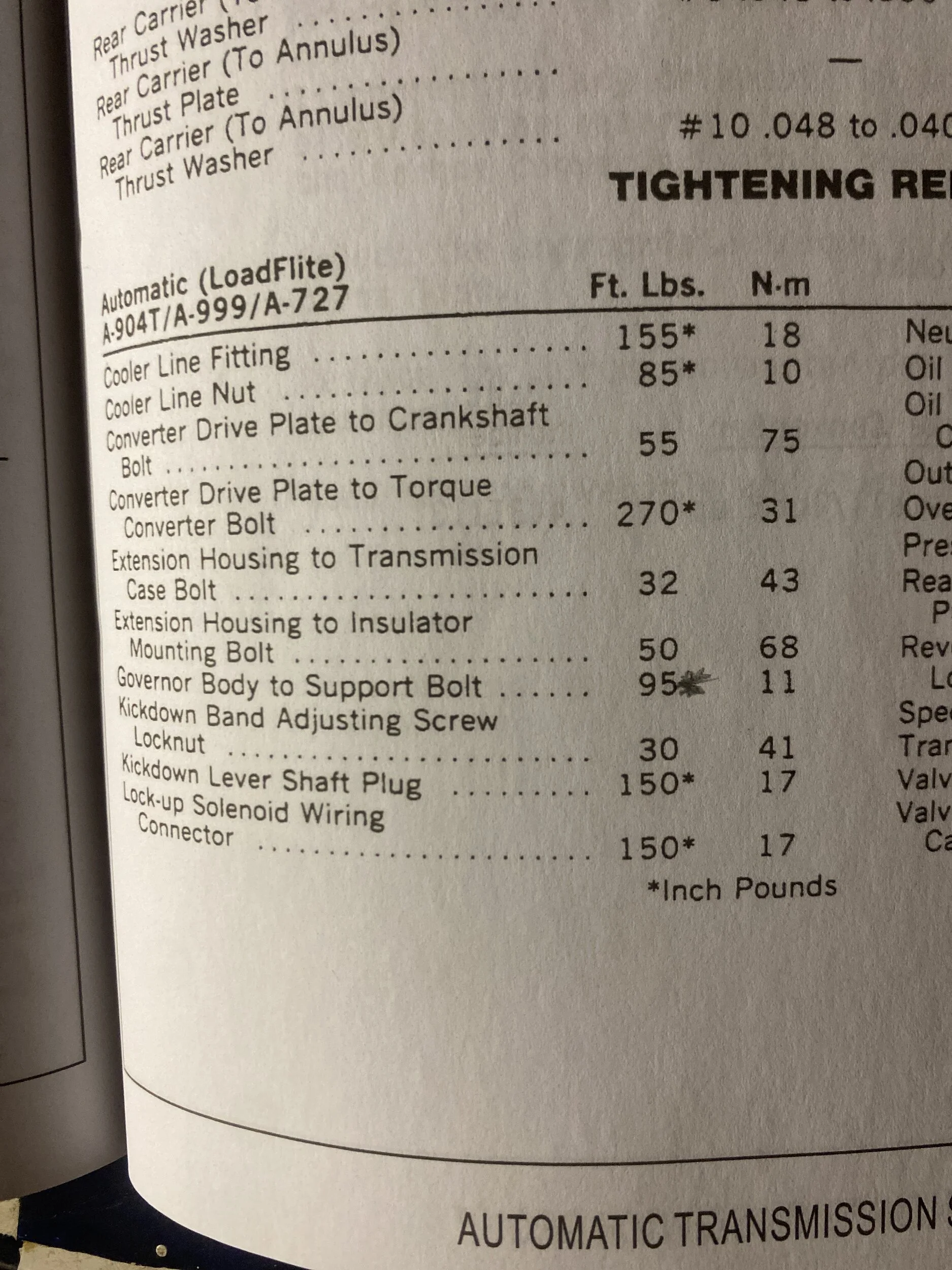

Torque Specs
