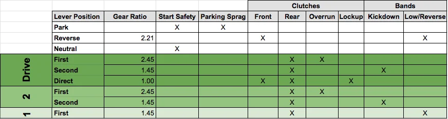

If you have drive but won't shift out of first, it's likely your kickdown band isn't applying or is unable to apply. If you have a little more courage, see if you can get it to shift into 3rd. 3rd releases the kickdown band and applies the front clutches, but reverse also uses the front clutches so it doesn't sound like those are the problem. But if you're saying it's taking more RPM to achieve less vehicle speed then you probably have some slipping going on with the rear clutches or possibly the overrun clutch, either of which very likely means an overhaul is in your future.
The good news is that it's an easy rebuild. But I would not rely on what I saw on the dipstick tube to draw a conclusion about the fluid quality. You need to drop that pan and see what's going on.

I don't know that you can adjust it enough to make it hold 1st gear beyond 5k RPM. Even if the TV valve were all the way open (or is it closed?) it would force a shift out of 1st prior to that. Out of adjustment the other way would cause it to shift way early. My hunch is that it's trying to shift into 2nd but the kickdown band isn't grabbing the drum. But it's all wild speculation until we see the pan & fluid (and/or perform all the in-vehicle pressure diagnostics, but who actually does that??)
