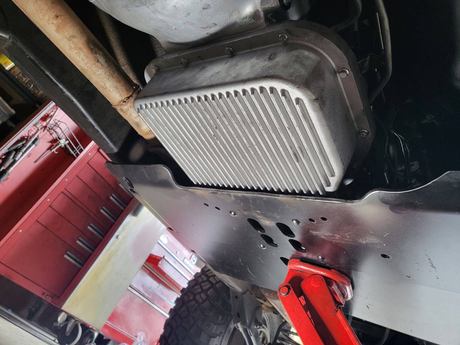

She's back!!! After a lot of part hunting and a shitload of cussing I got her back together and on the road! The deep aluminum pan I put on took a LOT of mods to make it work with my tummy tuck, but man was it worth it. She drives fantastic!! You can definitely feel the difference in the way the transmission behaves. Again I am beat after a day of wrestling with the beast. I will post some more updates after I get some rest. View attachment 323253View attachment 323256
You went DEEP I hope you don’t rub that thing off in a rock,or does your engine skid cover it?
