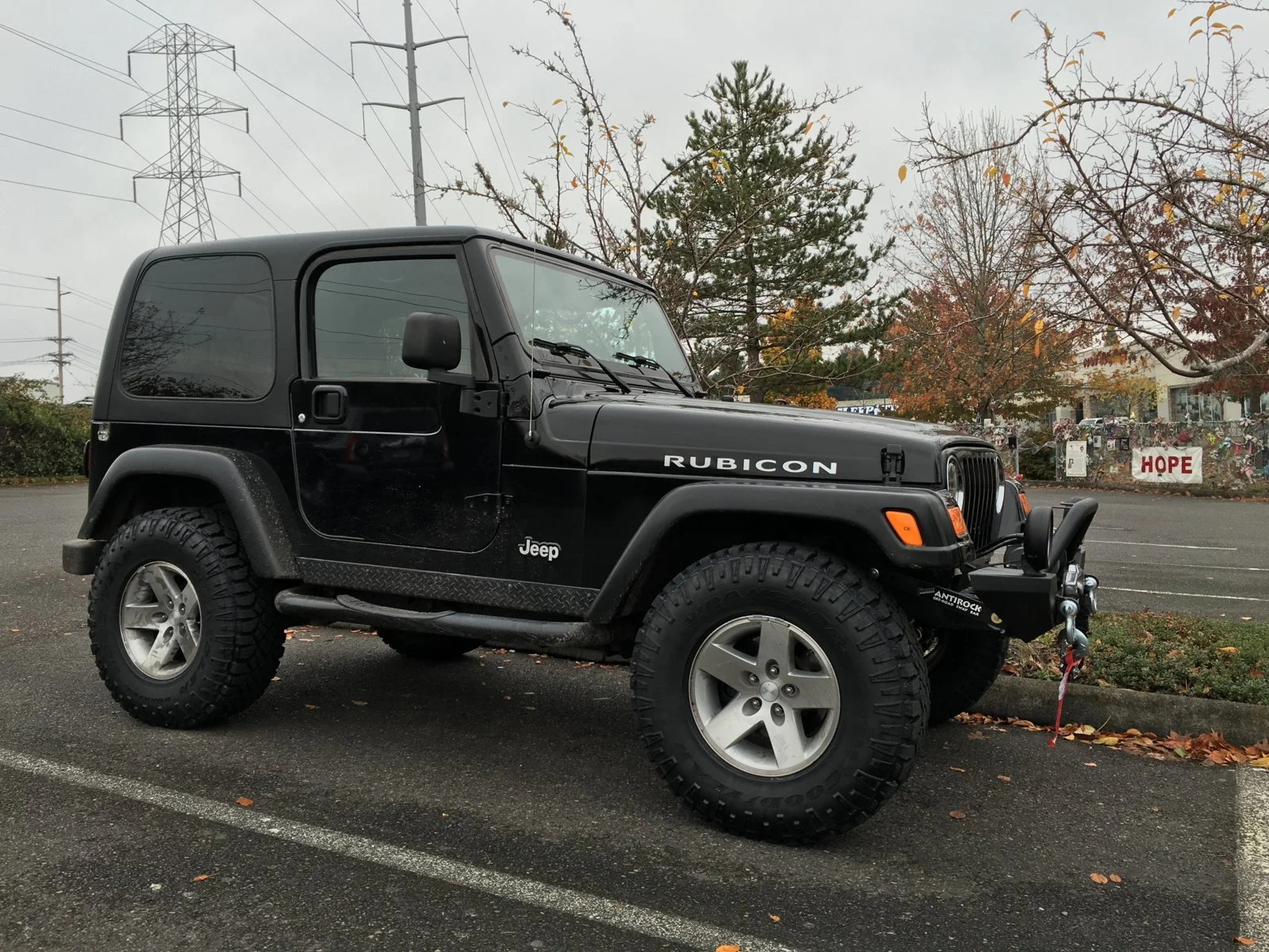

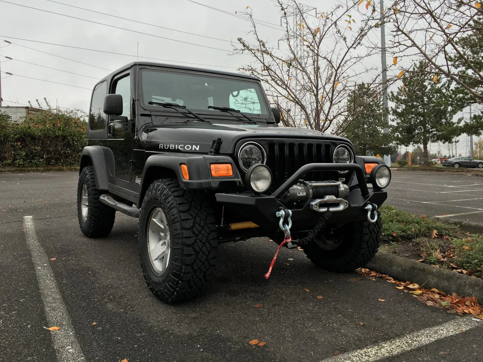

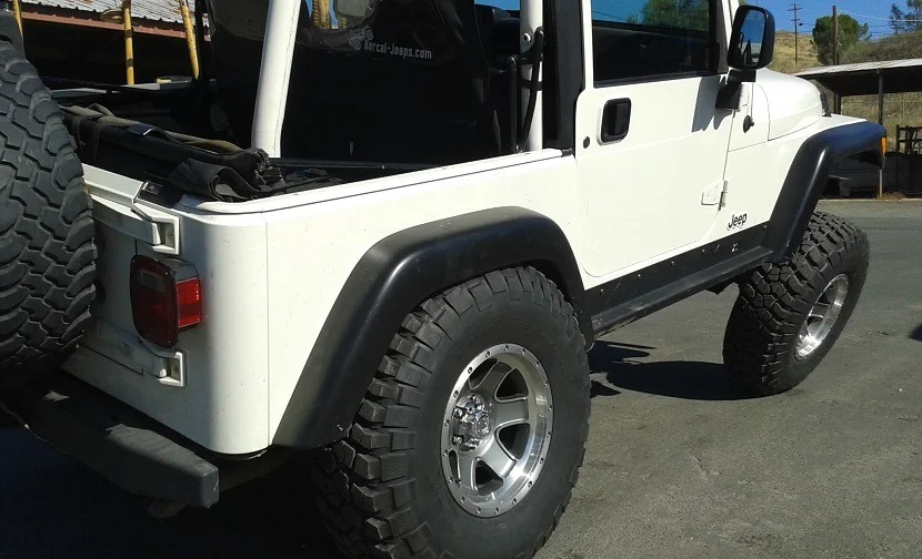

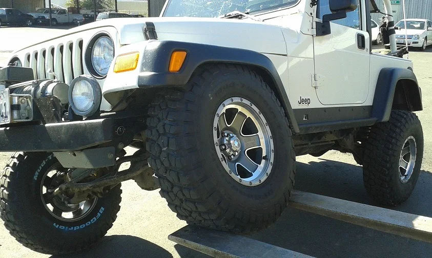

33" tires might be a little tight on a 2.5" lift. Not that bad, but here is a photo of my TJ with 33" Duratracs on a 2.5" OME lift:
Okay, so maybe it's not that tight, but I think 1" more of lift would be good, so maybe at some point plan on adding a 1" body lift and you'd be set.
As for the wheel / tire setup, I think that sounds perfect. I'd stick with the 10.5" width as well.
It can be done on 3" of lift with the proper bumpstop extensions. 2.5" of lift is ok if you don't plan on disco'ing your sway bar or getting super flexy. Keep in mind a 33" tire is only 32" once mounted and the weight of the jeep is on it, and even less if you air down to offroad. Rubi flares will help with clearance if you stuff the tires, and you are spot on with a 1050 wide tire.
With proper bump stop extensions, you can clear.
View attachment 21994 View attachment 21995
Did this set up rub at all?
Not on-road at all, even under full turn. I didn't get a chance to really flex it off-road. Since I had it bump stopped correctly, it shouldn't have rubbed off-road either. My plan was to install a 1.25" body lift in addition to the 2.5" OME lift, but instead I just swapped it out for the Currie 4" lift.
