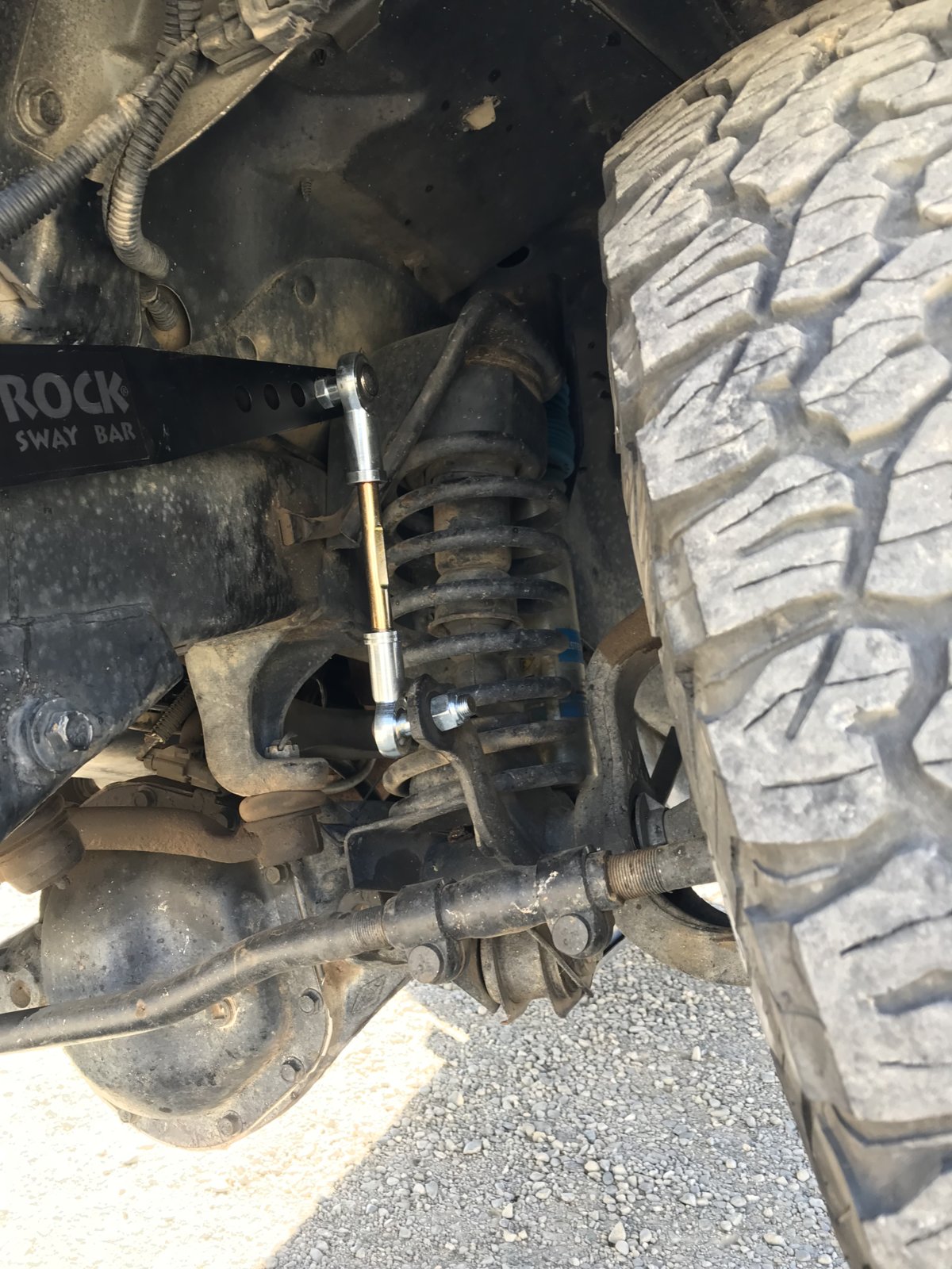

33's and your 4 banger might leave you wishing you have either more power, or better gearing. I ran 32's, and now 33x1050x15's on a 15x8 wheel, 3.75" BS.
32's on 2.5" suspension lift, with 1"bumpstop extensions to keep the tires out of the fenders.
33x1050x15's adding 3/4" coil spacers, and a 0.5" body lift, adding bumpstop extensions to 2".
Even with my 4.0L and 5 speed, 33's pretty much left 5 gear useless, and I felt like I was also starting off in 2nd gear from a stop. I lived with it for a couple years until finally re-gearing.
