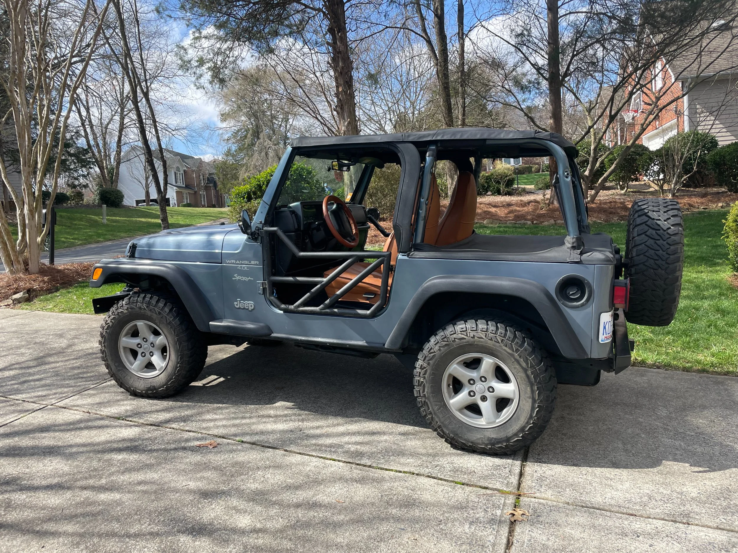

- Are my wheels fine for 33s? 15x8 jeep brand wheels, I don't know what the specific name is, I can figure that out if needed though.
The wheels in your photos aren't 15x8, they're the Ecco wheels, which are 15x7. They'll work fine for 33x10.50, but many tire shops won't mount a 33x12.50 on them. With 5.5" of backspacing, the tires may rub on control arms when turning sharply. You may want to space your steering stops or add wheel spacers, such as the Spidertrax 1.25" or H&R 1" spacers.
Thanks for that correction! I had always assumed they were 15x8…
