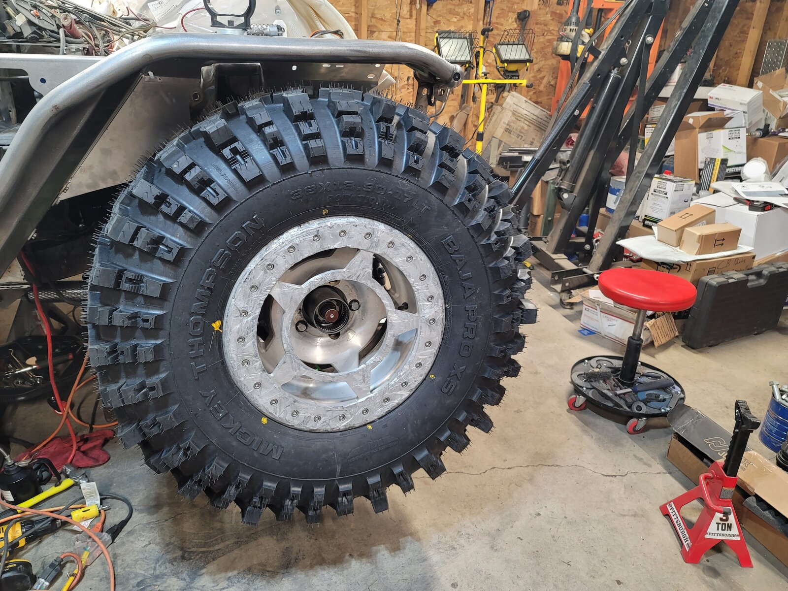

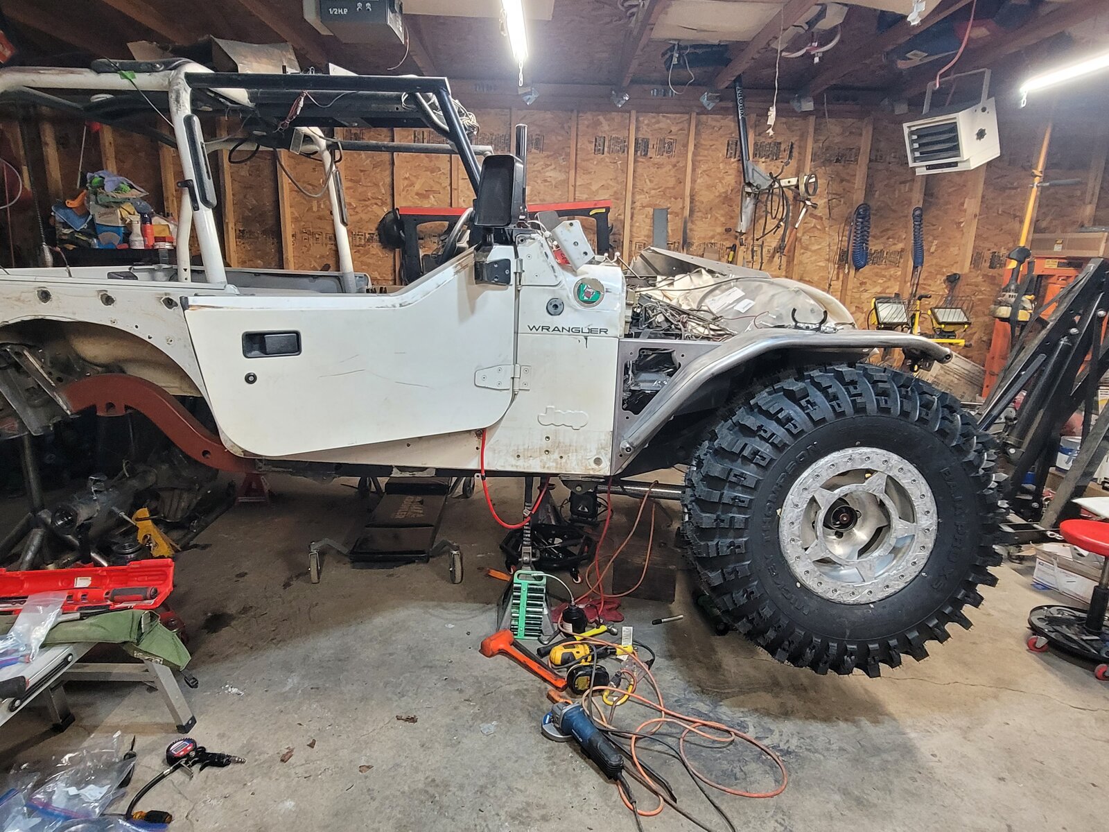

I have the Overline fenders and rear corners for my TJ.
And I'm running 38" tires but NOTHING is stock on my rig.
What rear setup are you saying MC doesn't have on their website?
I went with Metal Cloak because of the option to remove the flares. On tight trails the 8" wide flares would be a issue. But it keeps me more street legal for the times I drive it on the roads.
And I happen to like the look of the Overline fenders.
