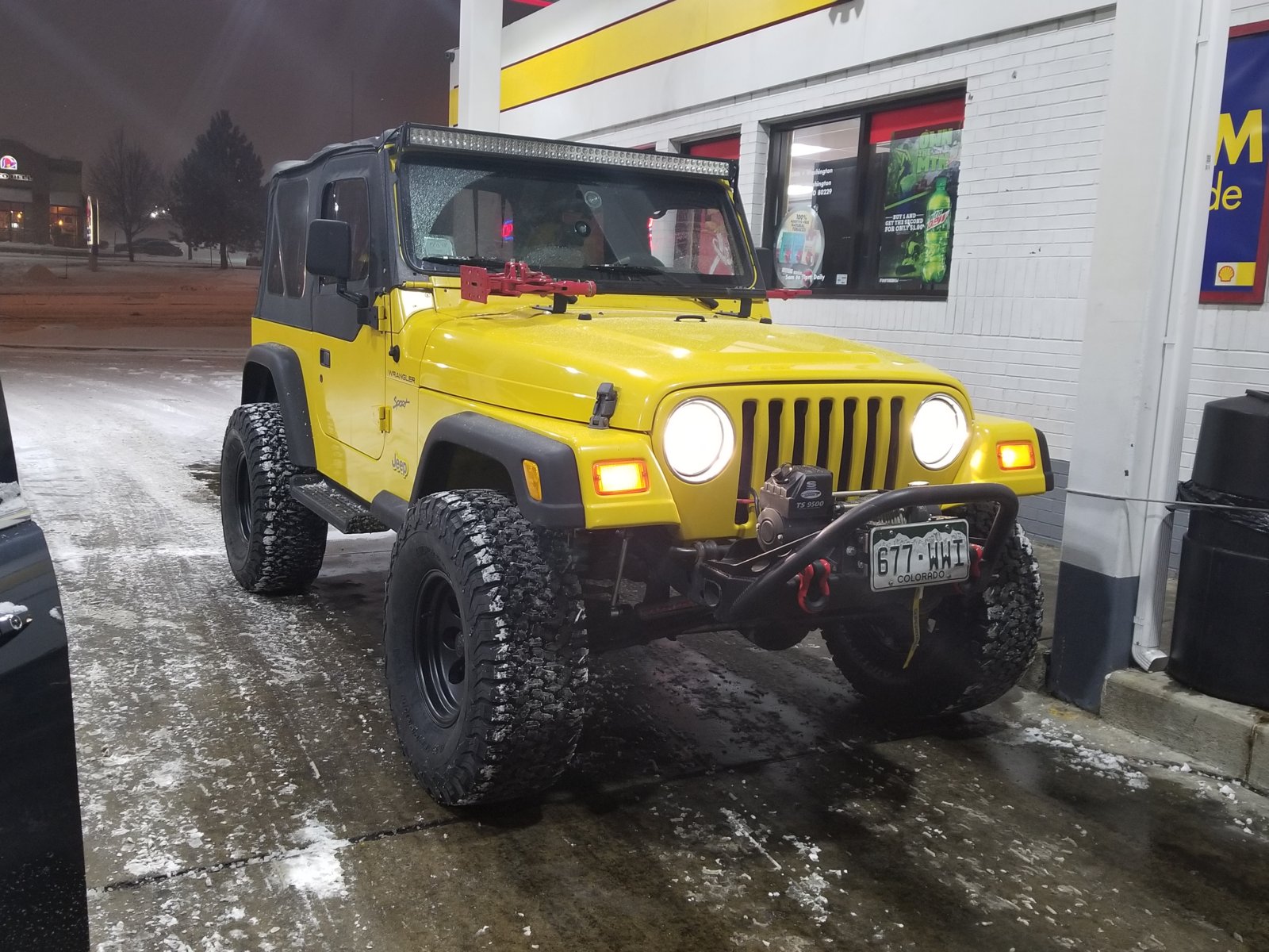

Here's mine with 11.25", does that count? Haha
View attachment 25314 View attachment 25315

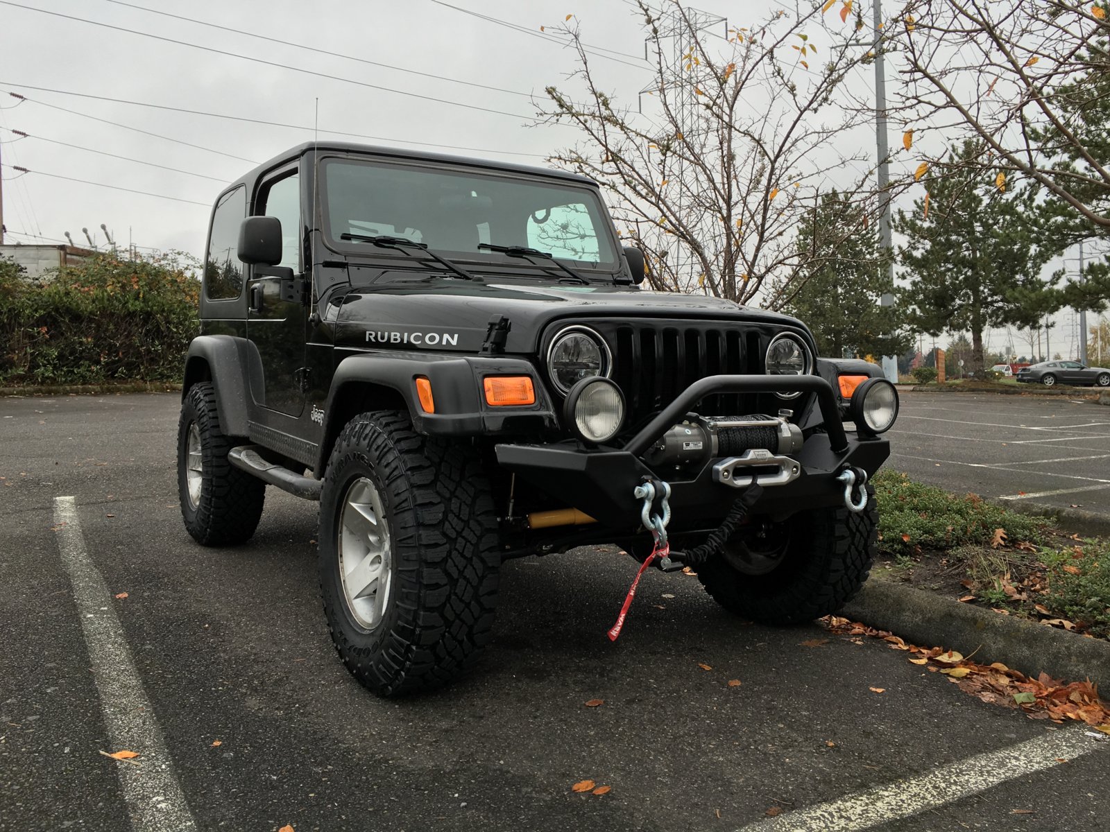

Those are factory 16x8 Moab wheels. 4.5" of backspacing would be enough to clear the control arms with a 10.5" wide tire for sure, and with a 12.5" wide if you adjusted the steering stops.

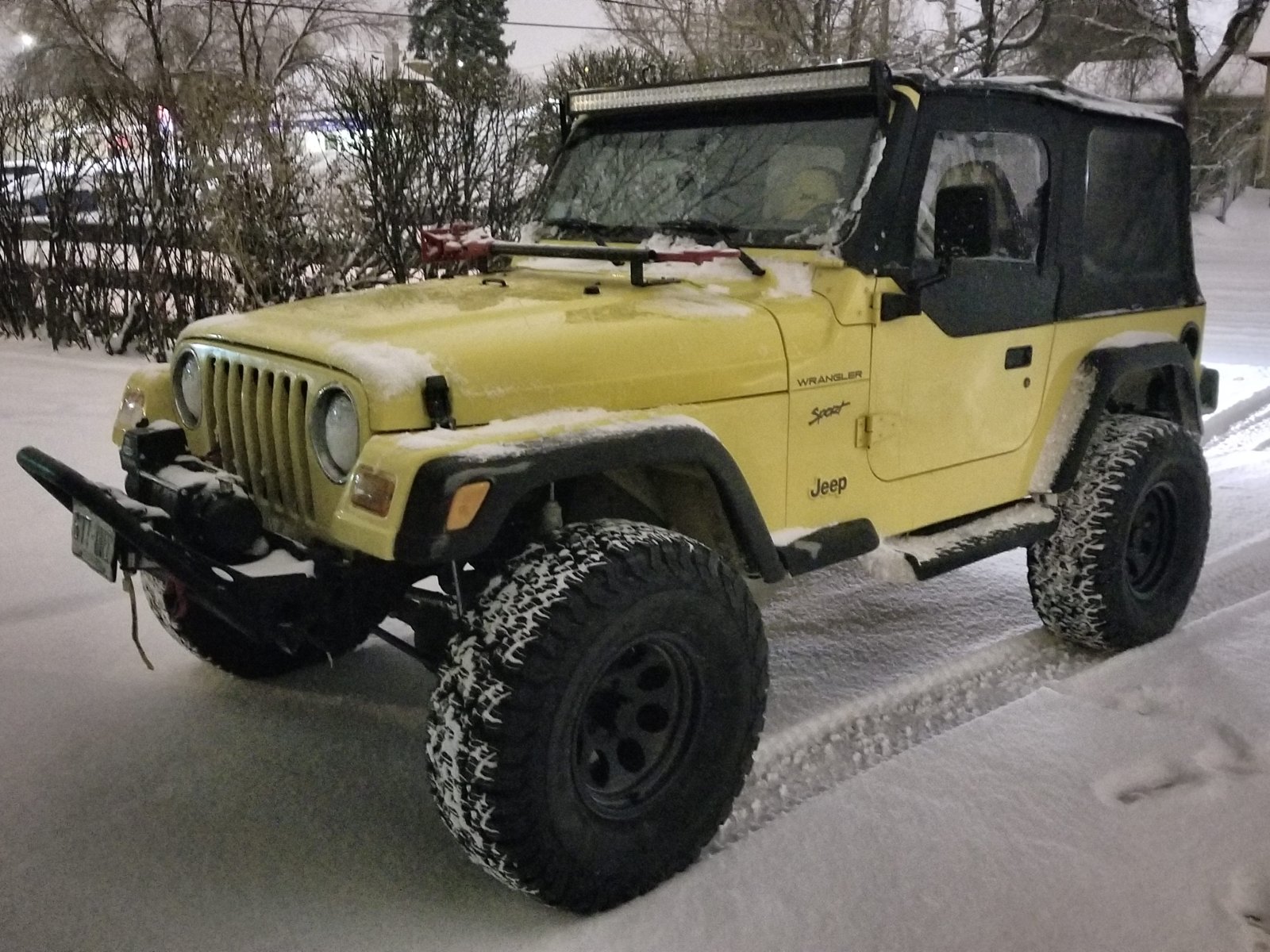

A little before and after. Apologize for the poor quality pictures, but I just got my lift and 33s 2 days ago and it has been snowing since. I went with 12.5's and I absolutely love them. I have the 3 speed auto with 3.73's and it actually rides MUCH better on road than my tiny little worn out 30s. I think my last tires were too small for my gear ratio because my RPMs were always through the roof, and the speedo was geared for bigger tires (my speedo always clocked me going about 5 miles or more over at highway speeds).
Any idea what the backspace is on this set of 15x8’s?
