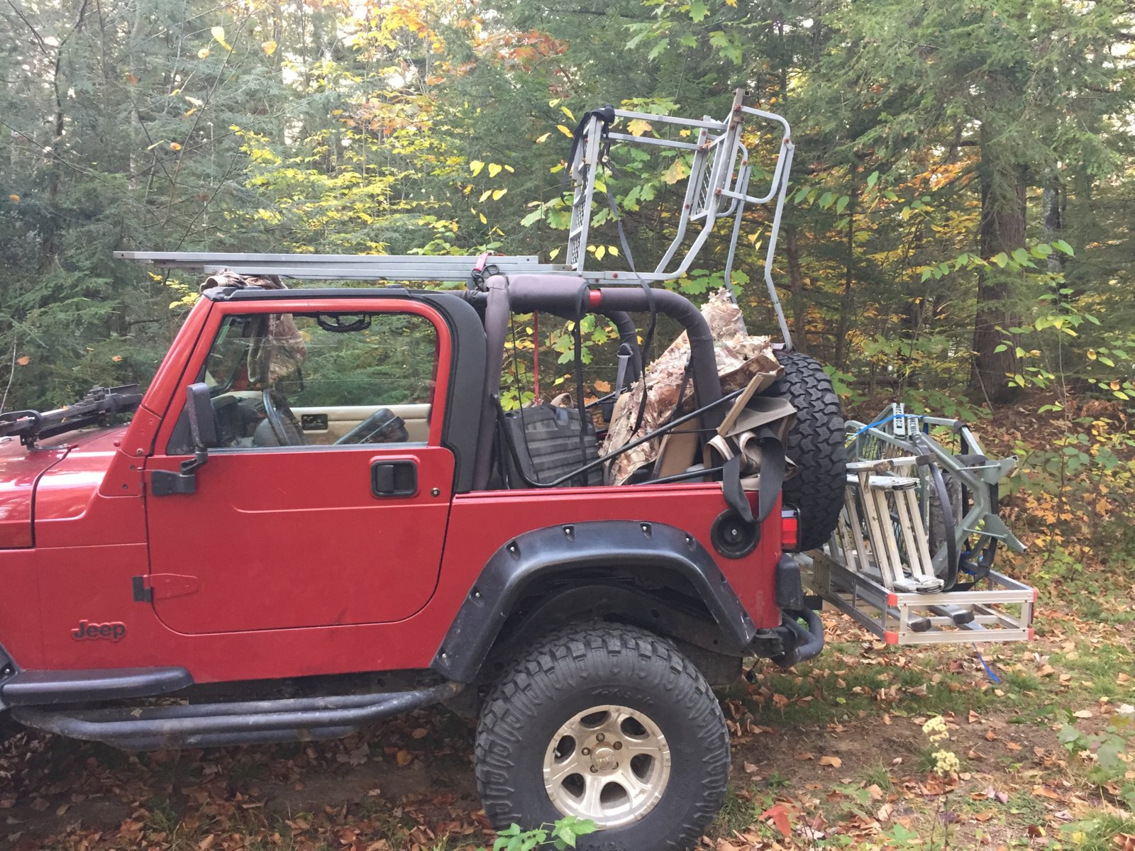

Really?? That's cool! How's it working out so far? Recovering some nice Deer?
So far only have used for setting up stands. Weather has been against me all season. Only deer I have seen I took out the only branch between us
