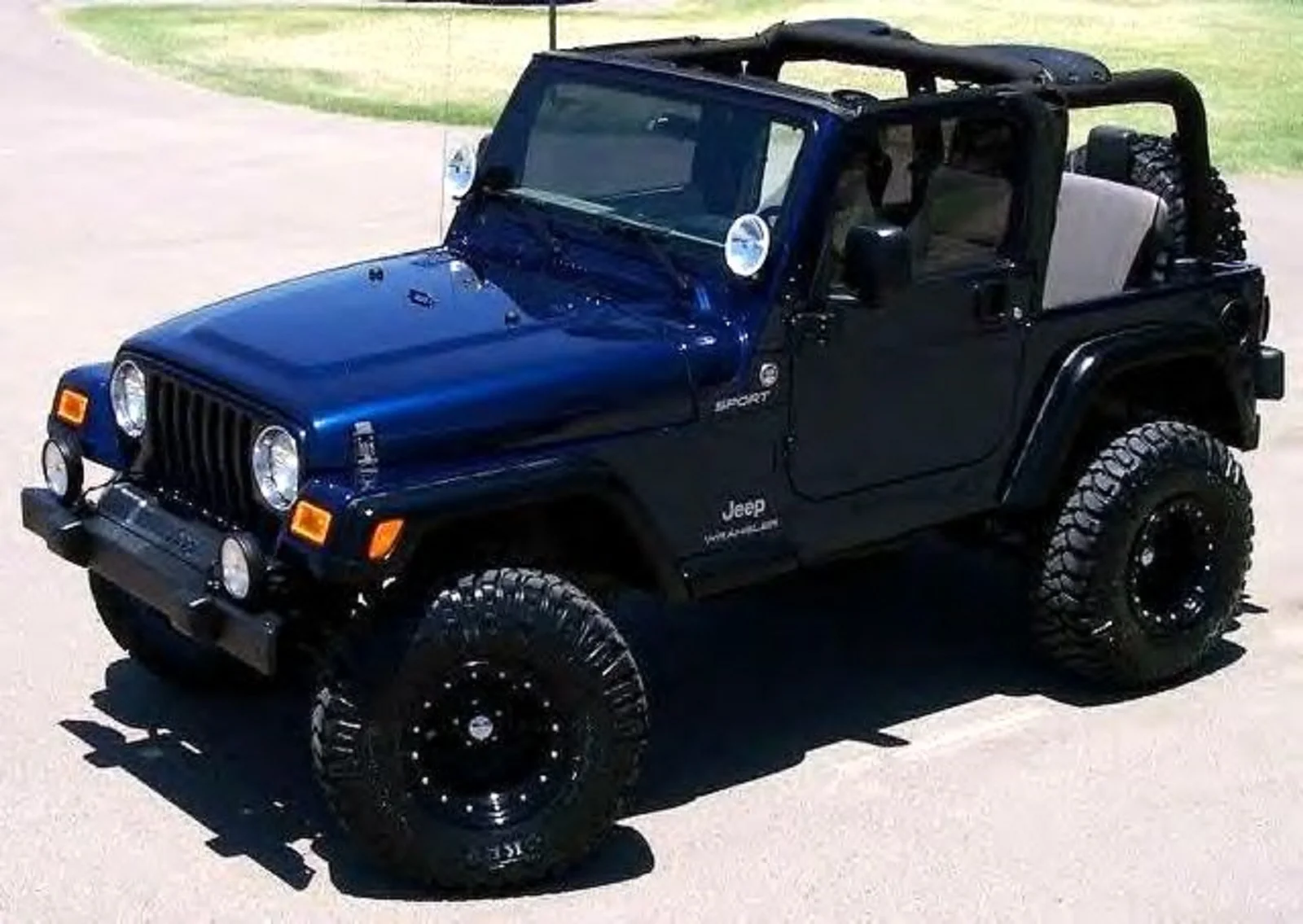

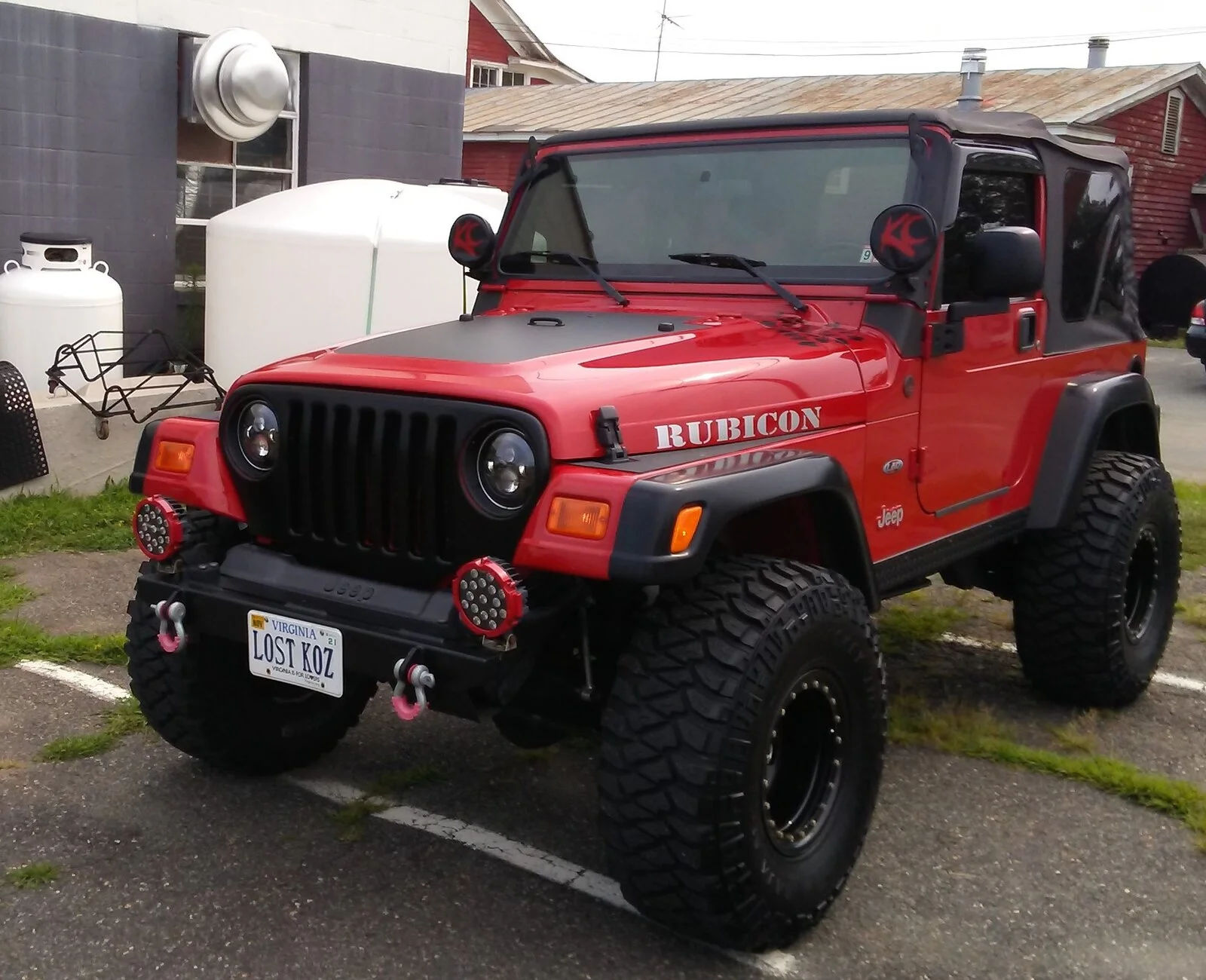

I've run 15x10" wheels on a few of my Jeeps, but I never go below 10 psi. I've also run 7" wide wheels with 35x12.50s. 🤫
