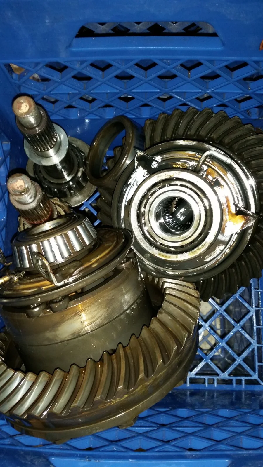

The factory lockers, both front and rear will not stand up to a beating on 35" tires. I have a very large collection of rubi lockers/parts that i have personally destroyed. Contrary to popular belief, the front is the weaker link of the two imo. Ive run both, fronts, front and rear and rears, front and rear.
They will live a long life if you're not aggressive.
Ive also got a large scrap collection of stock 30 spline shafts from 35" tires that were run on allied 32 bolt bead locks.
