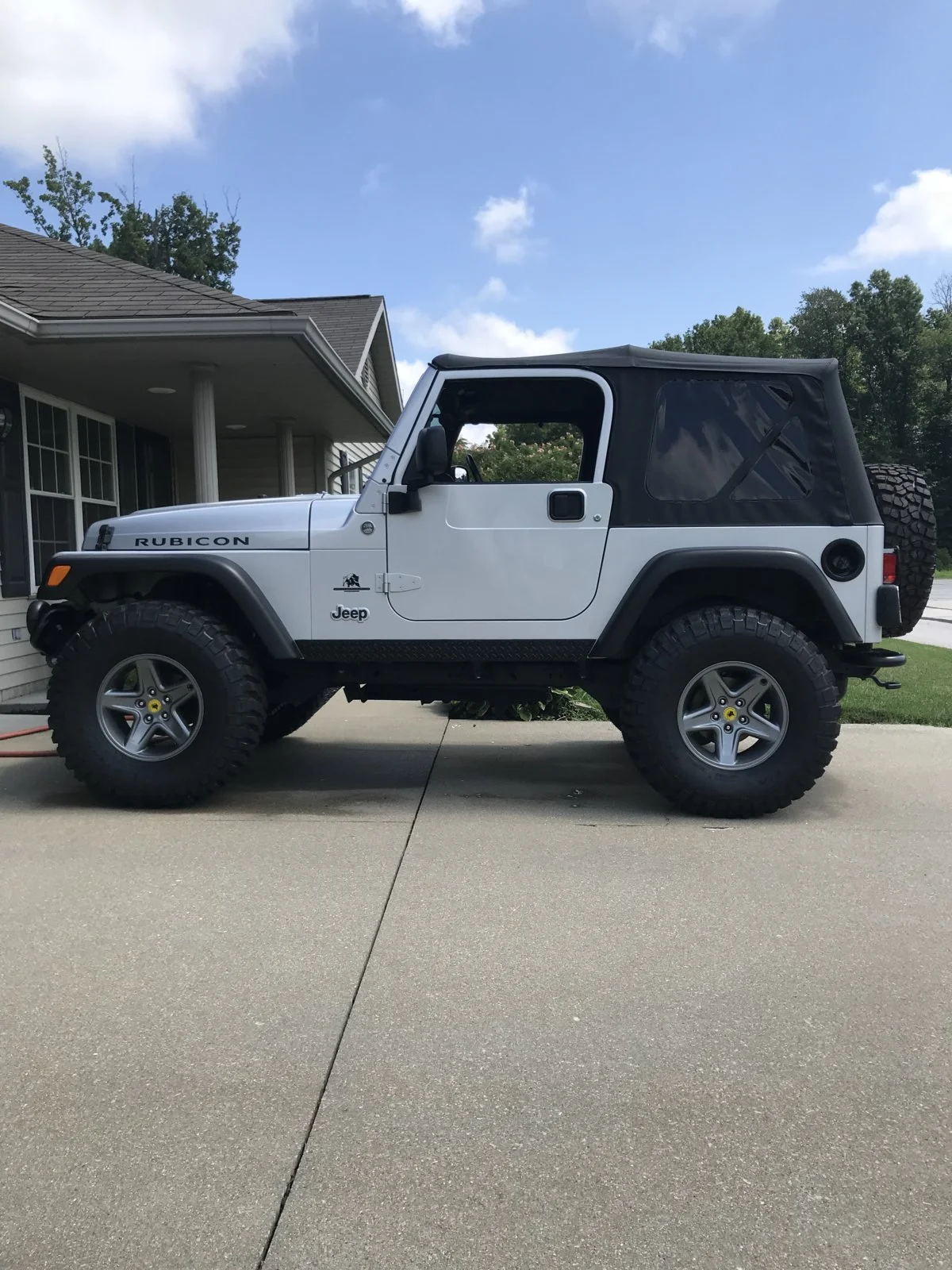

Good kit, I would go with 33s to allow sufficient clearance... I pieced mine together but have all the same components except maybe the DPG custom OME spring review (just bought the off the shelf Heavy kit). Hindsight, I wish I went with DPG, I don't have much weight in the rear end and my springs are designed for it, that's something I could have talked through with DPG and got a slightly lighter spring rate and better ride out of it (still no major complaints). Here's mine with 33s on 16" Moabs. I'd recommend 15" wheels for better tire options.

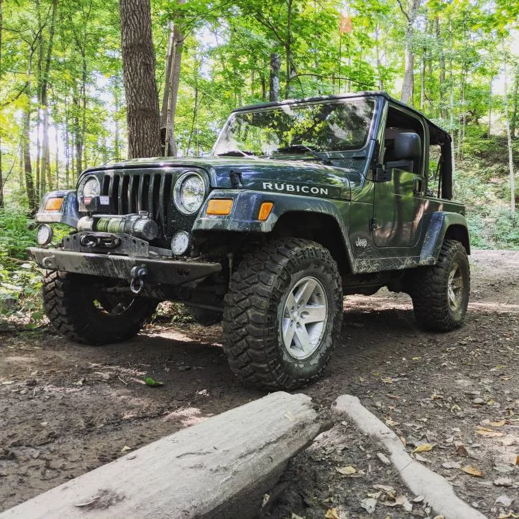

Just look at my jeep and let me know what you think lol. I’m running 35s. Only thing I don’t have are the disconnects.
