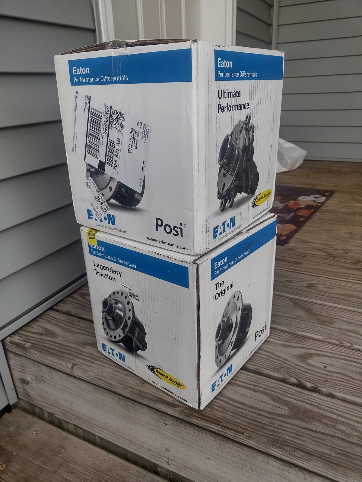

i ordered two (2) Eaton elockers, two (2) Dana 5.38 gear sets and two (2) squirrely Dana 44 Blue diff covers.
Two of six packages

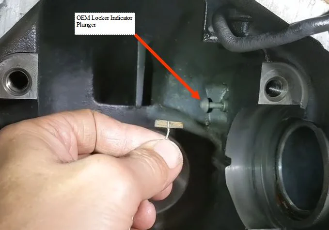

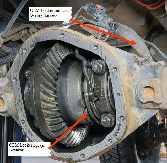

Apparently, when the OEM lockers are activated, the locker actuator inflates (Photo-1) and the plunger moves to the left (Photo-2) and the dashboard blocker indicator illuminates.
From my observations of the Eaton E-Locker, there is nowhere for the OEM plunger the connect to the Eaton E-Locker.
My question is: how does the OEM locker indicator interface w/ the Eaton E-Locker? What have you guys done when you installed your lockers?

I've never seen anyone hook after market lockers up to those sensors.

The OE Rubicon Locker Sensor is only usable with the Rubicon locker. I'd remove it and install a plug into its hole in the diff housing. I'd also completely forget about trying to use the Rubicon locker switches and wiring, you'll have continuous flashing locker lights if you do since the locker sensor won't work.

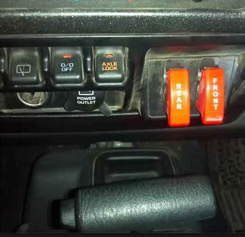

I bypassed the OE locker switch and wiring and installed my own separate F/R locker switches and wiring, it's no more difficult that turning a light bulb on & off.
You can see my OE Rubicon locker switch is still there but I no longer use it.

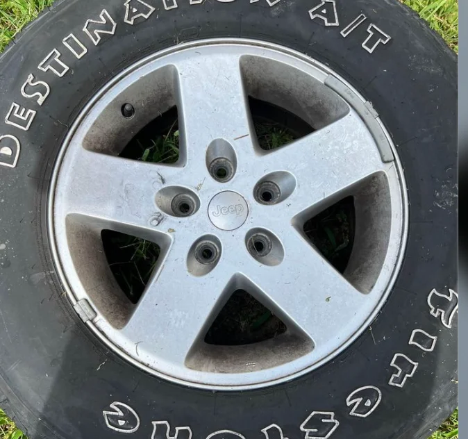

While i'm here, i got a question. I'd like to cheep out on rims. JK rims are a dime a dozens. If i get 1.5" synergy wheel spacers, what kind of performance can i expect. What will it do to my scrub radius. These are the rims i'm looking at. btw, i need 17" rims for the BM Super BBK (w/ master cylinder). 16" rims are tight, so 17" rims will have a little extra circumference.
