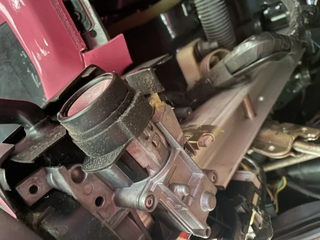

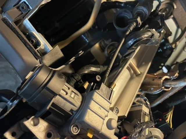

Im into the swap now and when I went to move the shift interlock cable/mechanism from one Jeep to the other, the ignition switches are different. The ignition for Jeep that was manual doesn’t have the block on the back side to plug it into. It has the small white connector for the wires, but not the square block. Also the manual has a levered key release. Do I need to swap the ignition switches also?
Im into the swap now and when I went to move the shift interlock cable/mechanism from one Jeep to the other, the ignition switches are different. The ignition for Jeep that was manual doesn’t have the block on the back side to plug it into. It has the small white connector for the wires, but not the square block. Also the manual has a levered key release. Do I need to swap the ignition switches also?View attachment 262204View attachment 262205
Yes, there is also a very small piece of pot metal that is easily lost, don't lose it.
Never mind. Realized I could remove the part from the bottom each ignition cylinder.
