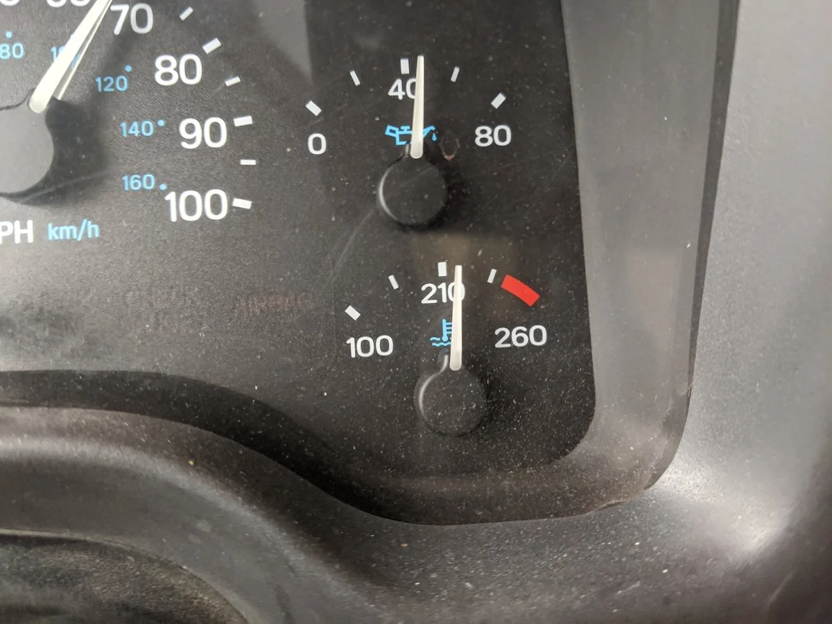

I took a drive today to the "local" off-roading spot and on the way there noticed that my temperature gauge was reading a bit high. If I remember correctly it always was slightly below 210 and now it was slightly above, actually more than slightly.
Take a look at the picture.
I was kind of puzzled in the beginning, thinking that it had to be the long climb or something, but it wasn't the first time I had been on that road and the needle never moved past 210 before.
