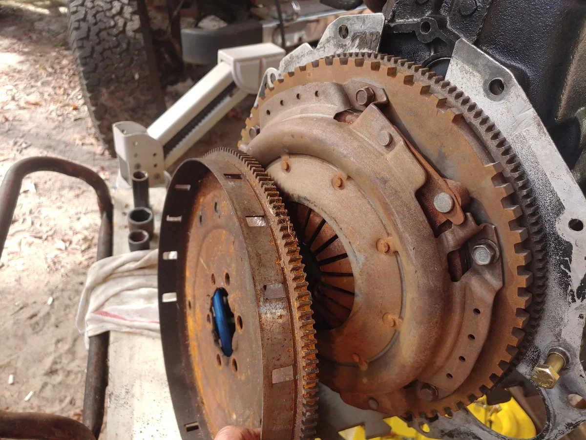

This is my most recent event. I'm ready to stab this 4.0 with I'm sure to be the 4.2 flywheel attached. The flywheel bolts we're a bit of a challenge to come across at a reasonable price. I ended up using a GM part number but nevertheless I then came to realize the difference between the 4.2 flywheel and the 4.0 flex plate. The 4.2 flywheel has 3 sections of missing teeth for the sole purpose of the crank sensor to determine number 1 top dead center. The flexplate from the 4.0 with the same idea yet with a substantial difference in design. Attached to the flexplate is a solid ring with three sections that have four small cut-outs.
At this point I'm somewhat at a standstill. I'm not a rocket scientist but I'm pretty sure my combination is not going to work. The last thing that I want to do is drop this motor in only to find out I have to pull it back out. Lol

I don't think that setup will work.
People who are doing the 4.2 conversion are using the crank and pistons from the 4.2, not the entire long block itself. In fact, the 4.2 itself is an inferior engine compared to the 4.0, with the exception of the 4.2 bore. The head doesn't flow as good, and it doesn't put out as much power as a later 4.0.
So by putting the entire 4.2 engine in, you'd actually be taking a step backwards. What you want to do is use the 4.2 bottom end internals on your 4.0 block. This is how guys are punching out their 4.0s with more displacement, which will indeed equate to more power.
