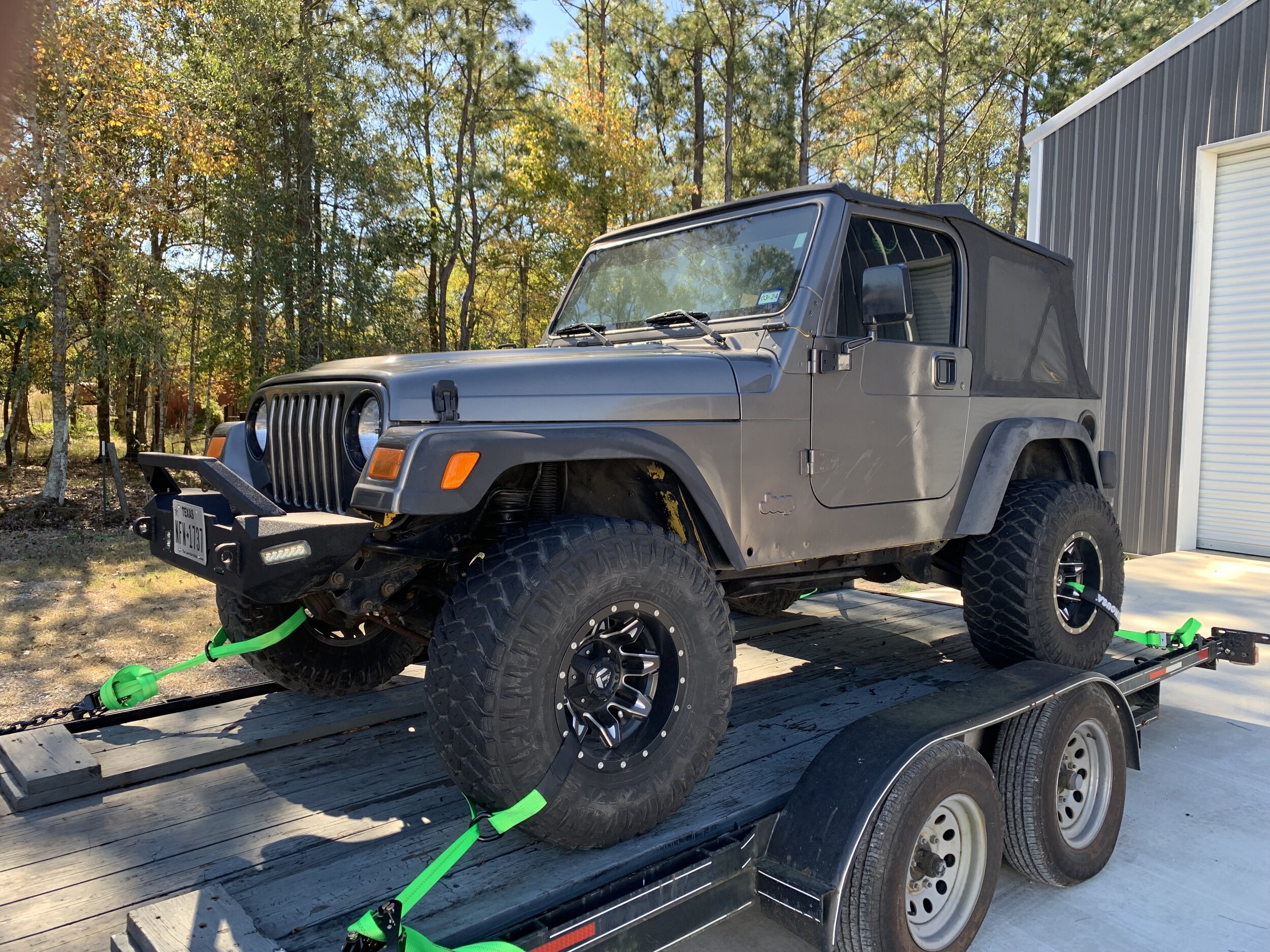

Anyone running 4.88 gears with 33’s and and 4.0/AX15?
Currently running 3.07 gears in my 97 (pictured) with 31” tires so Im looking to swap gears because the 3.07’s suck! I found another TJ with a blown up 2.5 in it that has 4.88 gears in both axles already and has a set of wheels/33’s. It also has a bunch of suspension, steering, bumpers etc. that I could swap over to my Jeep.
