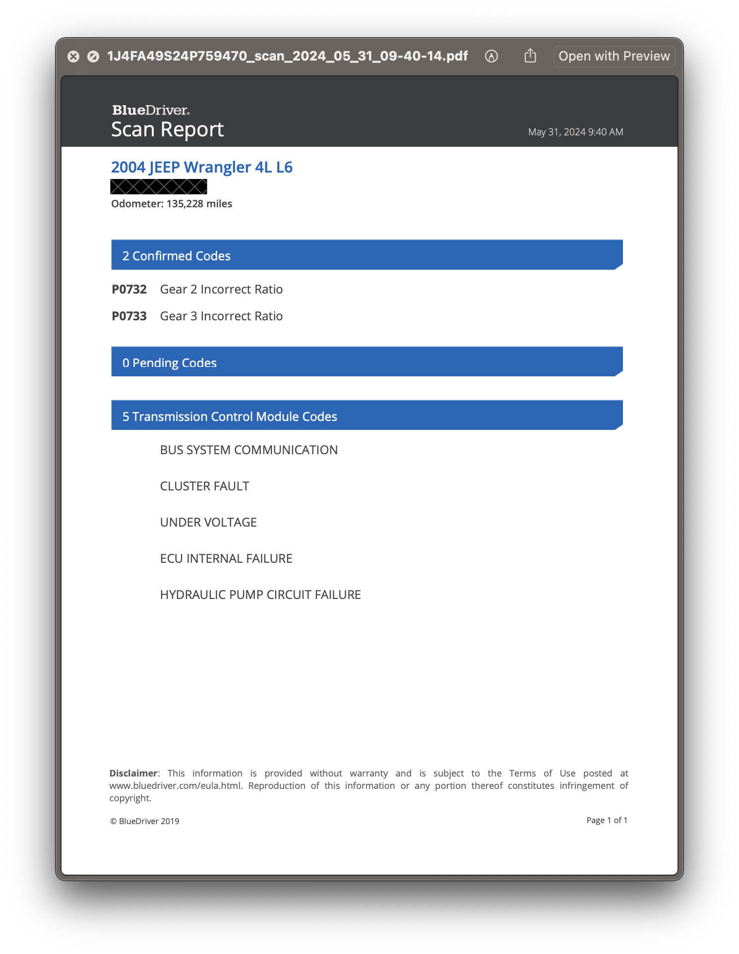

My 2004 Jeep LJ started revving while driving like the transmission disengaged for a few seconds. The Check engine light also turned on. I had the jeep towed home and then began to investigate. It did not go into limp mode and seemed to drive okay after being towed home around the neighborhood. I pulled the following codes with my blue driver scanner

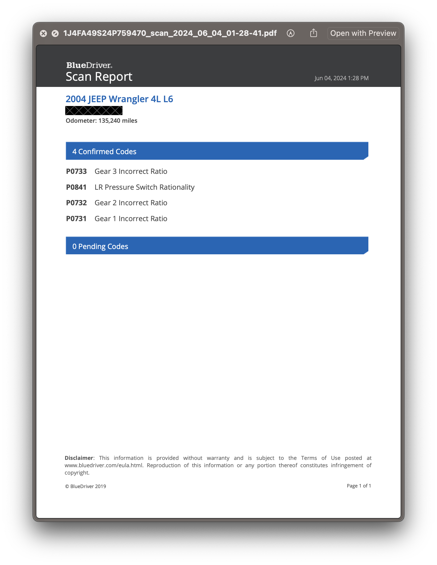

After some research on the forum I decided to change and flush my transmission fluid and filter. The fluid was not burnt but it was filthy. I then drove around for about 20 minutes and it did rev on my one time in the first few minutes of driving, but after some more driving the CEL cleared as well as some of the other codes. Getting the codes from the odometer only gave a P0700. The scanner then pulled the following codes

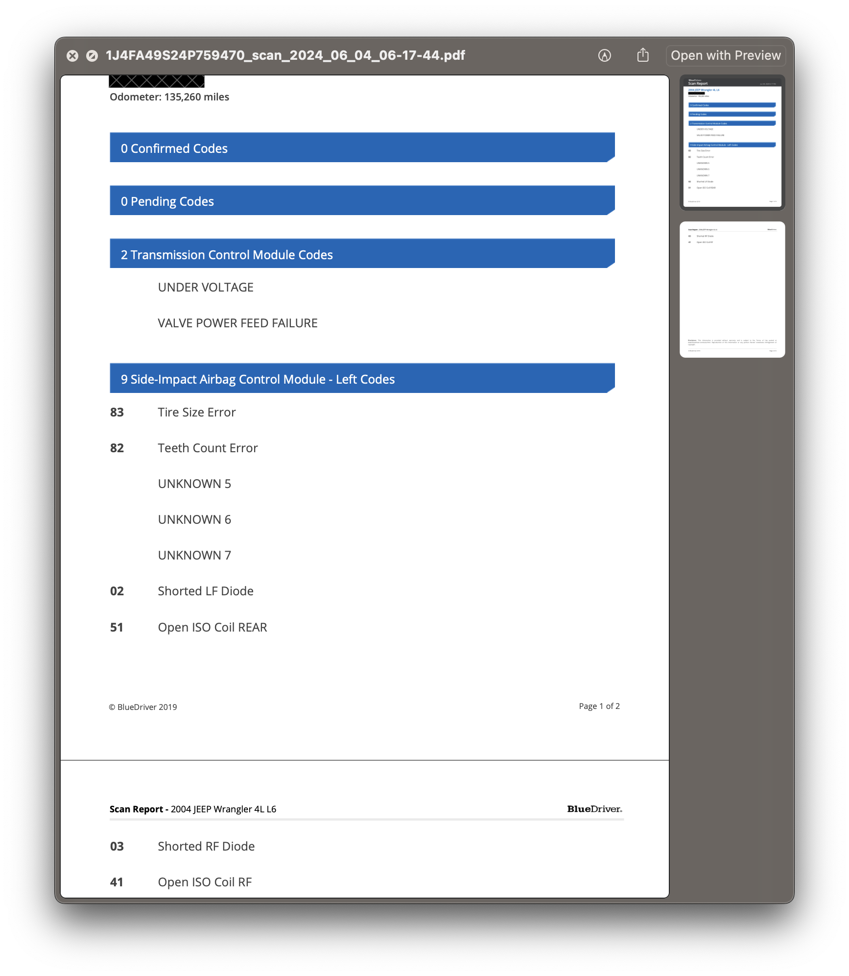

I then cleared the codes with my scanner, replaced the battery as it was 4 years old but was showing 12.54 volts, and touched the negative and positive battery cables to clear the codes. I drove around for another 30 minutes or so on the highway and the odometer does not give any codes and my scanner gives the following
I have been talking to Mark @Wranglerfix and have a new TCM on order, but now I'm starting to think my PCM may also need replacing due to the Side-Impact Airbag Control Module codes. Has anyone seen these before?
I'm still in the process of tracing my wiring harness looking for shorts. Is there a smart way to go about this or is it a full end to end check unwrapping everything?

Don't the TJ's have a dedicated airbag control module?
I'm not sure if there is a dedicated airbag module, but I know there are no side airbags on a TJ/LJ.
Update: I drove the jeep about 2500 miles round trip to Steamboat CO and back with a stop in Moab and did the Poison Spider trail with no transmission issues and no codes. I'm still a little worried about the side airbag code, but I'm assuming the new battery and cleaning the grounds took care of that. Unless something else comes up, I'm going to consider it resolved for now.
