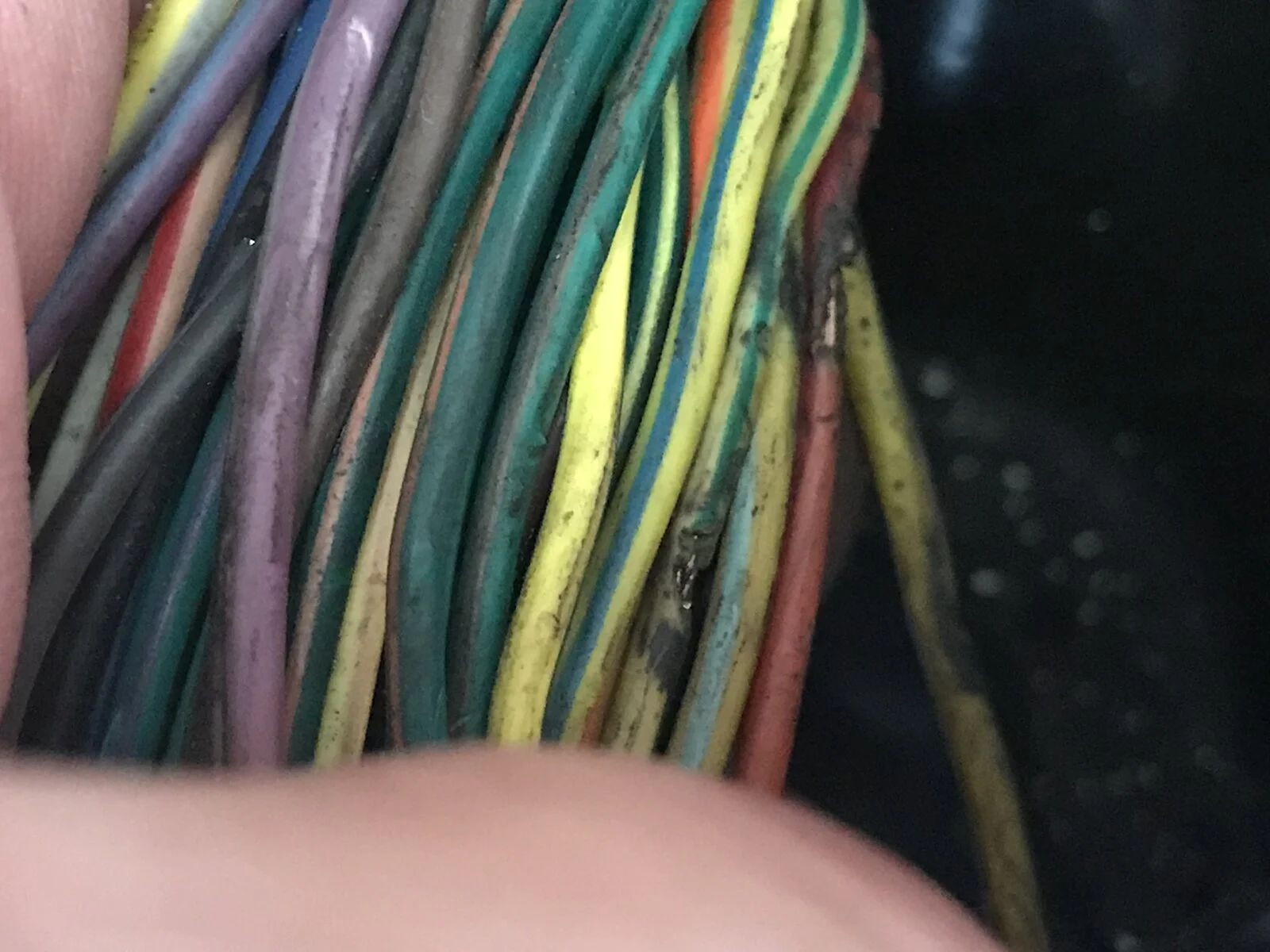

None taken. I would like you to take some contact cleaner (not dielectric grease) and spray all of your connectors. Pay particular attention to the black plug that controls the transmission side of the vehicle. The red connectors (CPA’s) must fit click and be snug or else they can cause issues.
Below is a common wiring harness failure that will kick it into limp mode.

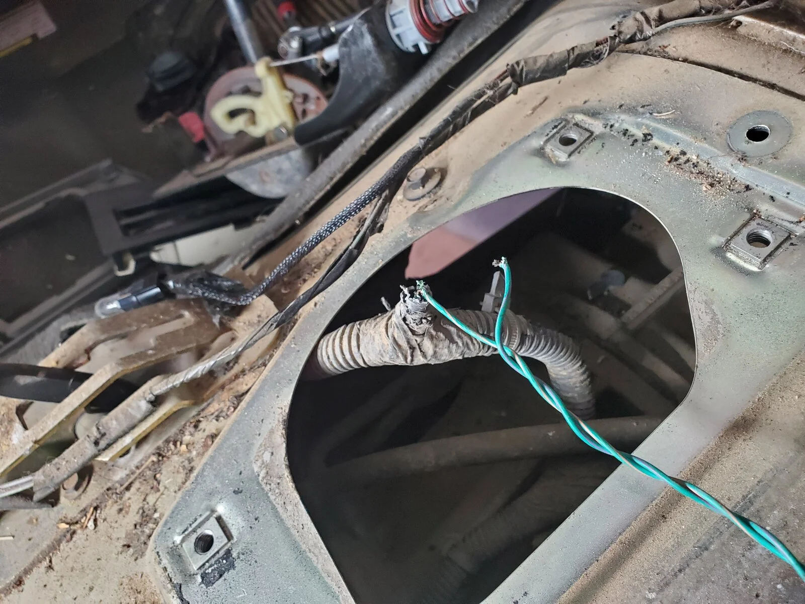

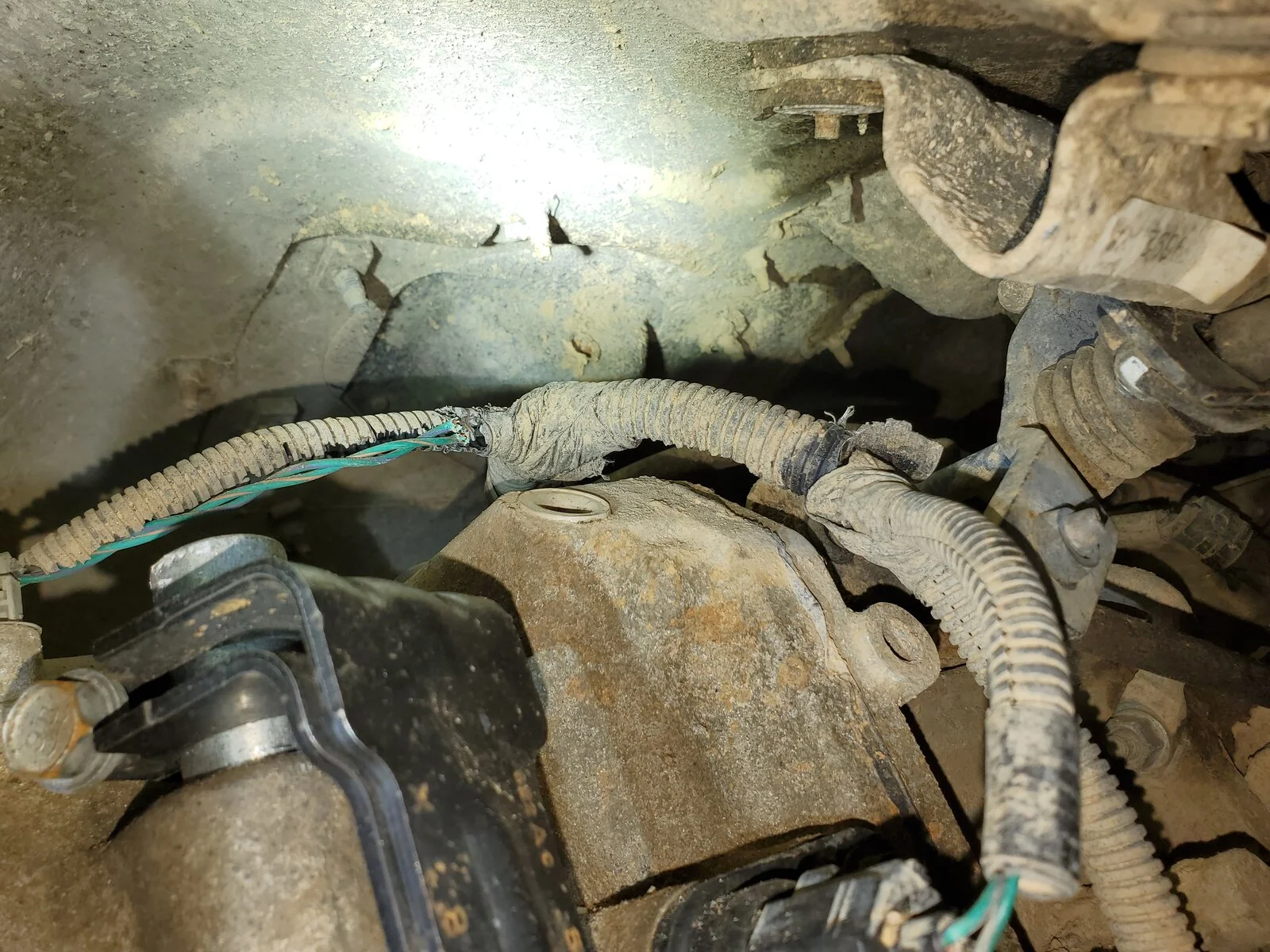

Well, after going over the wiring again, I found my problem. The two wires going to the output speed sensor were broken, one of them completely. I missed it before because I pinned the connector and had continuity between the connector and the harness plug, so I didn't think to pull the loom off and look closer.
Less than $5 worth of wire, solder, heat shrink, tape, and loom and it's back up and running like totally normal.
Thanks to @Wranglerfix for all the help!
