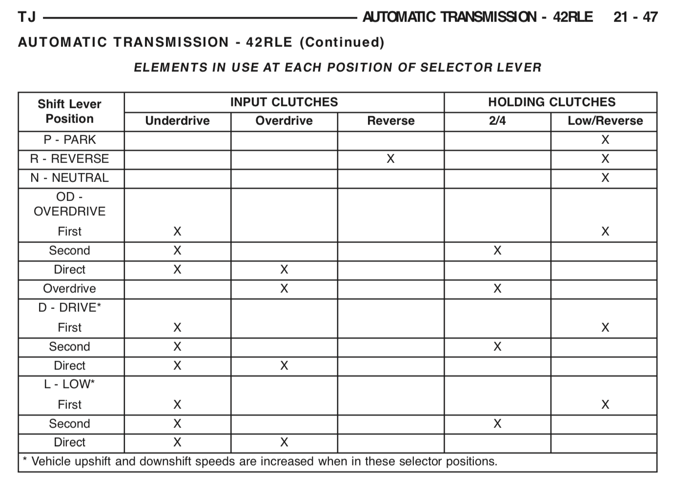

Do you have any issues whatsoever with it going into 2nd? 2nd & 4th gears use the same 2/4 holding clutch so If it was a clutch or piston apply problem there I would expect similar behavior in the 1-2 shift. If 3rd gear works fine I would not suspect the overdrive clutch, which already applied when it goes to shift into 4th.
