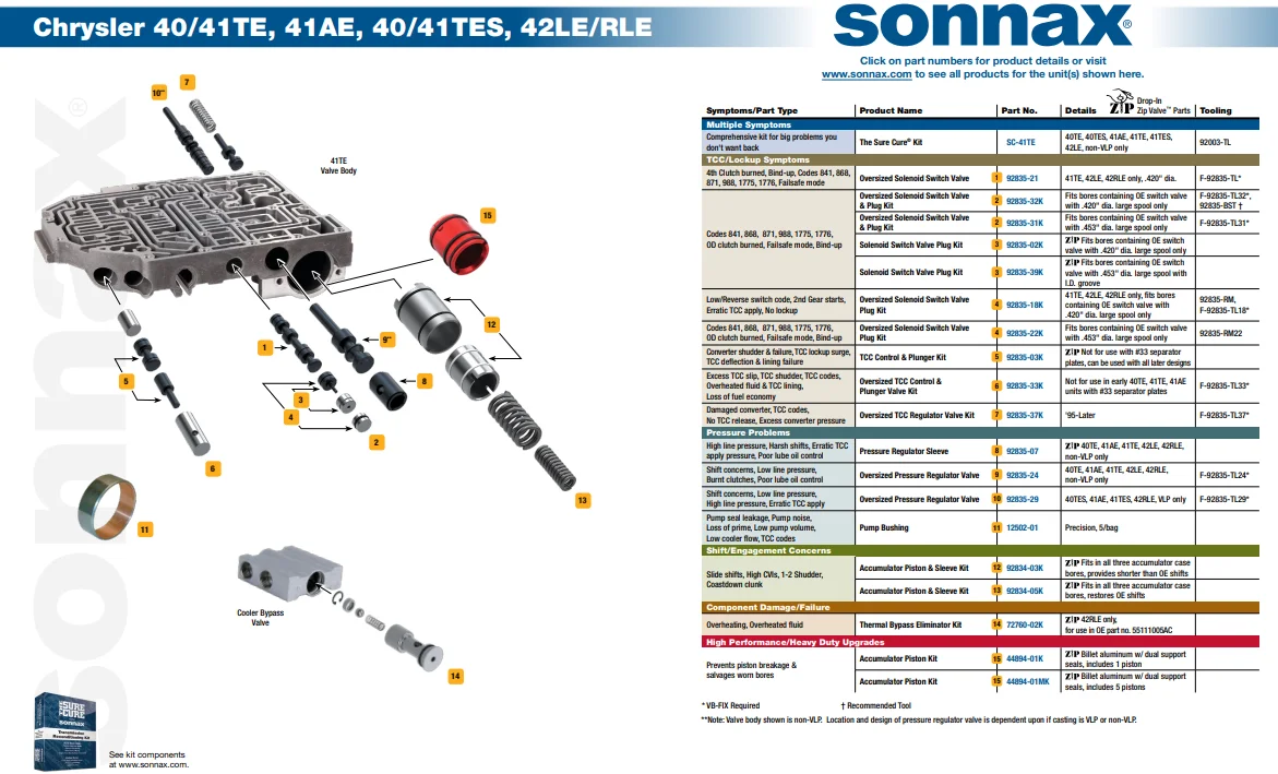

I used individual Torque Converter parts from Sonnax when I rebuilt my Transmission and valve body. It looks like they offer a whole Valve Body but I don't know if it has all the magic already worked. I also did this in conjunction with a wranglerfix PCM and have better shifts between Lock and unlock on the converter. Wranglerfix has a new program that I need to send off for. May talk with your transmission professional about the options. Sonnax makes a whole mess of parts for the 42RLE. I can't even recall everyhing I did without going back to referance.
pressure regulator sleeve
oversized tcc regulator valve kit

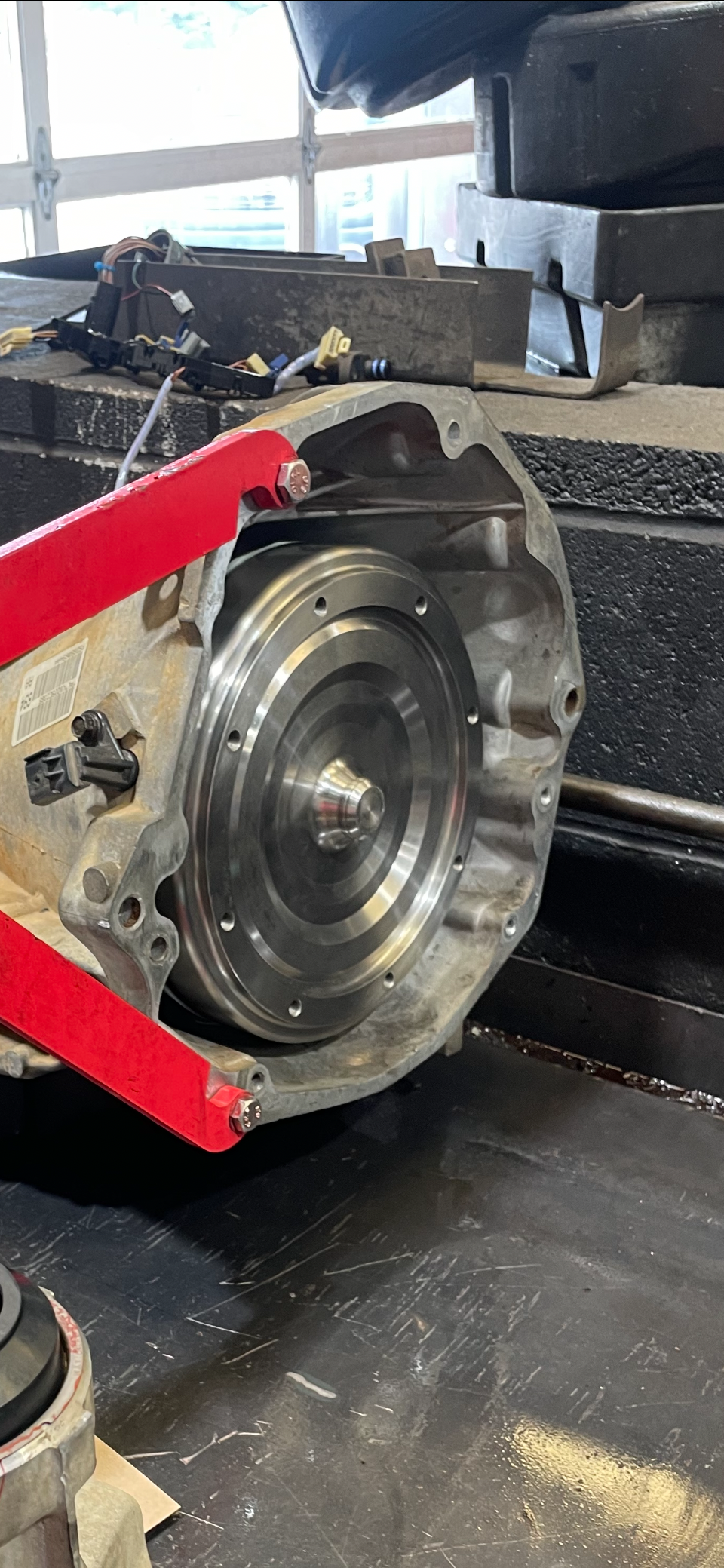

I went Billet TC and pistons (vs factory plastic)- got excellent results.

Have you got any more info on the billet torque converter you are using, that would be a very interesting upgrade. Probably contributes to a lot less heat build up as well I’m guessing.

I’ll be more than happy to talk to my mechanic and give you the source- We also got rid of the plastic shift pistons and used billet pistons-
You have to give things a little bit of time to break in but within a few hundred miles I realized that he had really improved on the transmission- It never feels firm but it certainly doesn’t have the soft factory mushy feel. It is the only TJ with the 42 RLE transmission I’ve ever driven that felt this good.
At first I was disgusted that I had to do it - after I did it I was so glad.
At first I was disgusted that I had to do it - after I did it I was so glad. View attachment 558800
